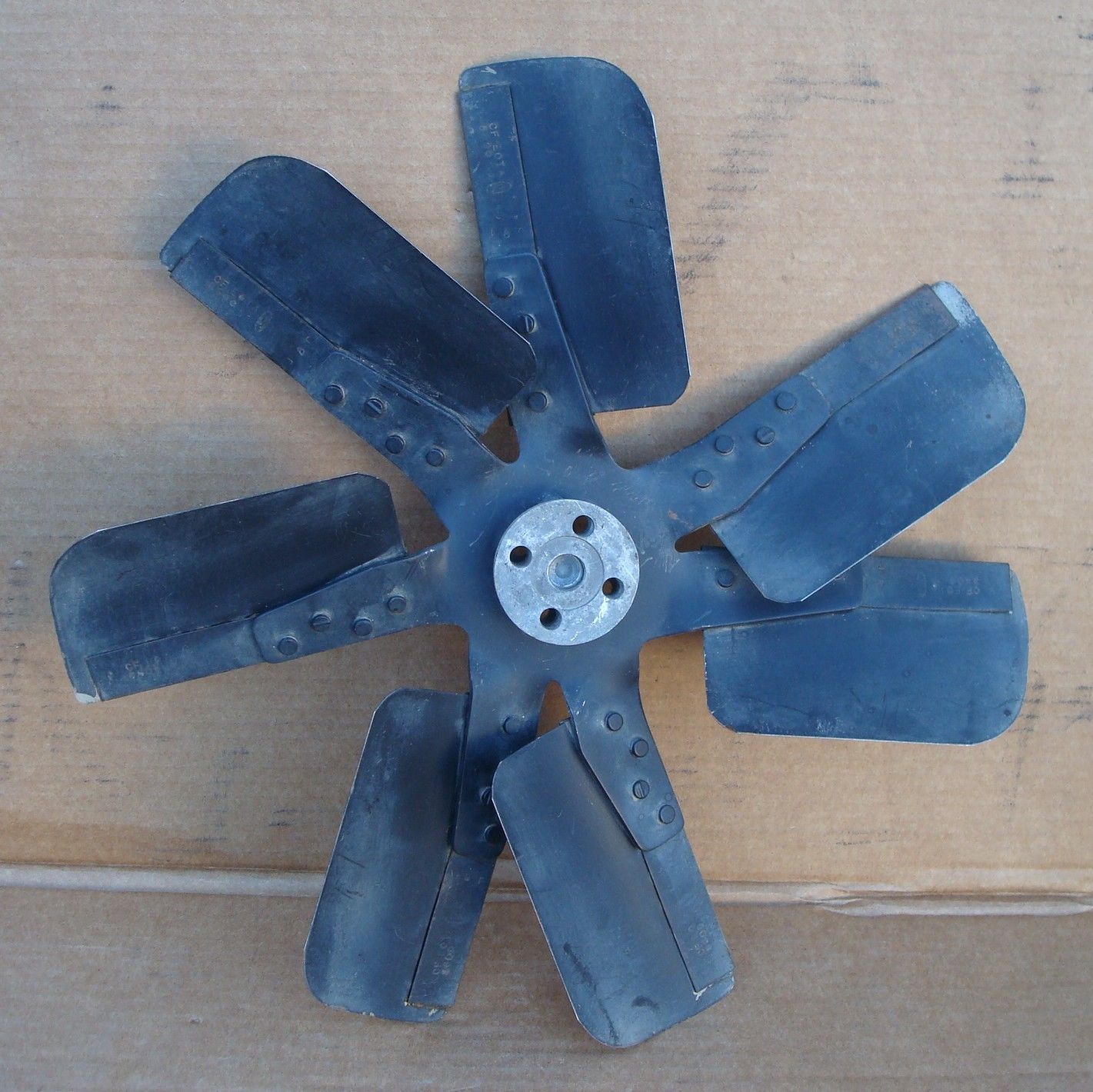

I saw this fan on EBAY. The part number is EOTA-8600-CA. I could not find anything on this fan. It is an 18 1/4" fan according to the seller. It is a 7 blade fan. Anyone have any idea of what this fan came from? It appears that something like this may be a decent upgrade over my 4 blade fan. I would be able to use this without a clutch as well. Right?
Here are a couple of photos:
Old Mar 23, 2015 | 02:33 PM
  #358
JEFFFAFA's Avatar
JEFFFAFA
Joined: Mar 2013
Posts: 14,255
Likes: 199
From: Phoenix, Az.
E0TA8600CA crosses to part number E0TZ8600A. 1981/82 F100/150/250 and Bronco. 302 V8. A/C or Super Cooling.
