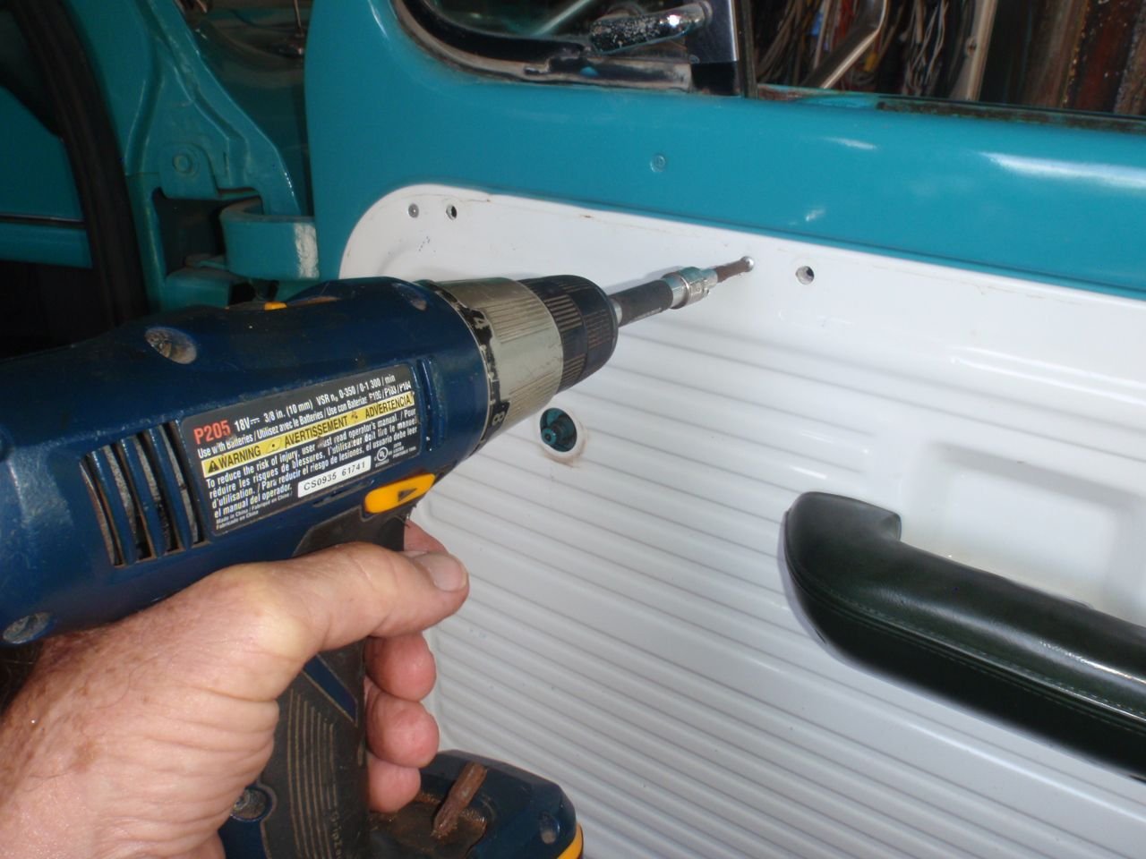

Yesterday, I worked on the passenger's side door, to put in the sound mat, and took a few photos.. Had lots of problems with removing the rearward, bolt/screw, from the arm rest. Seems that my 3/8", quarter drive socket, is too thick walled to fit onto the bolt's head... Have to put my sockets on a diet... but did manage to struggle long enough, to remove it... and took some photos in the process...
Baja
The door as I started
Removing the screws
1st layer of sound mat i/s the door..
sound mat covering the inside of the door
Just foam, on the inside of the door panel
