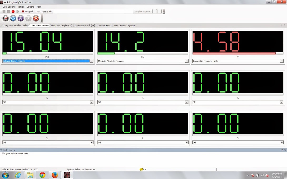

So here is my readings for 2002 Excursion 7.3
After I took the screenshot, the EBP reading moved to 15.12 and fluctuated between 15.08 and 15.12. This is KOEO. I live in Richmond, VA so I am around 350ft here. When I do the BARO volt * 3.1957 = 14.636306 - compared to 14.2 - so is my MAP need replacing?
How about the EBP?
Thanks

Good work, Joe. While the two are somewhat apart from each other, they are both pretty close to BARO. This is one of those "fence" things: If you are having fuel economy issues or running issues, and your budget allows, replacing one may help... or not. I would want to see how the sensors react under a heavy load (like WOT) before spending any money or turning any wrenches.
