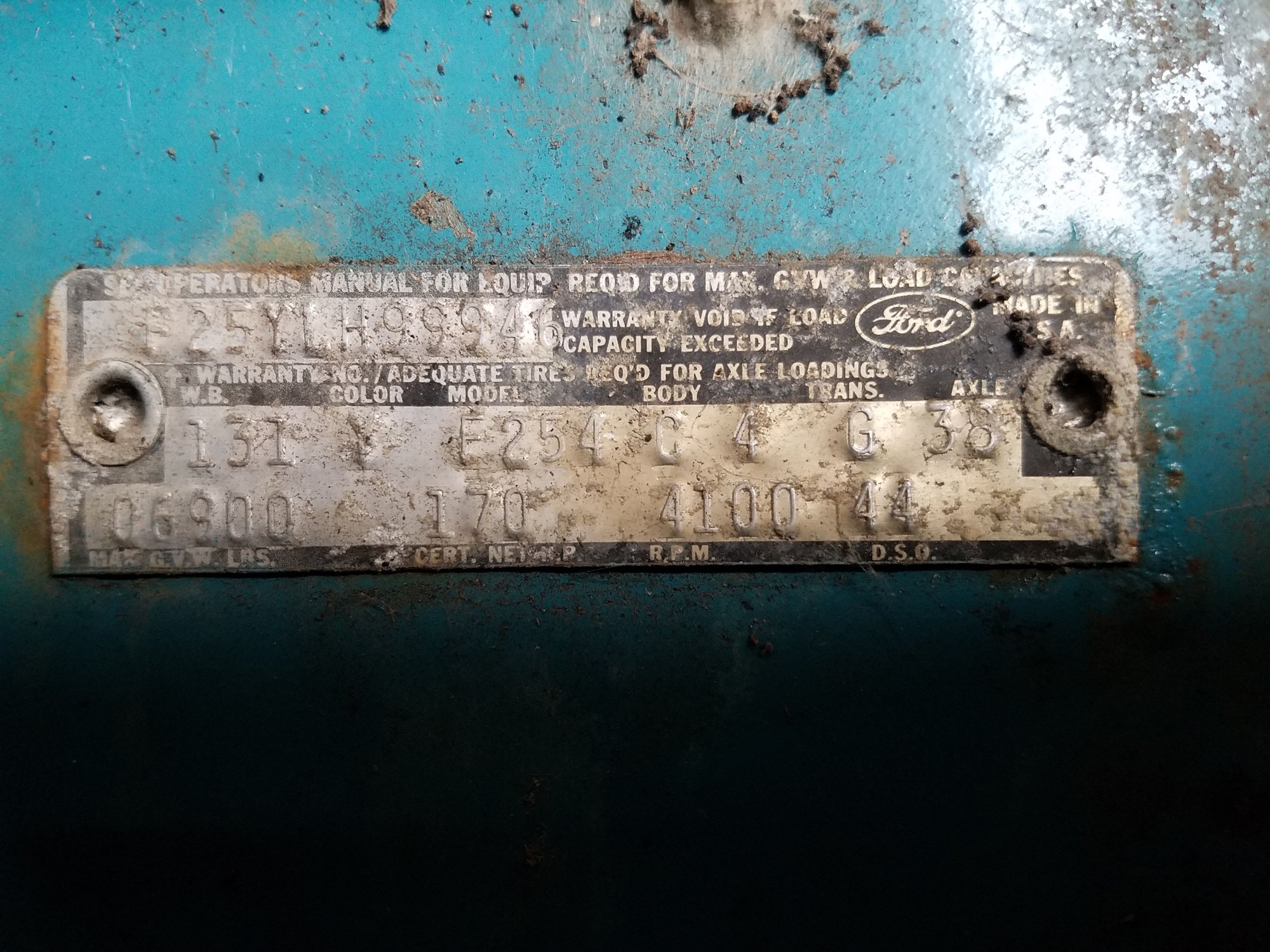

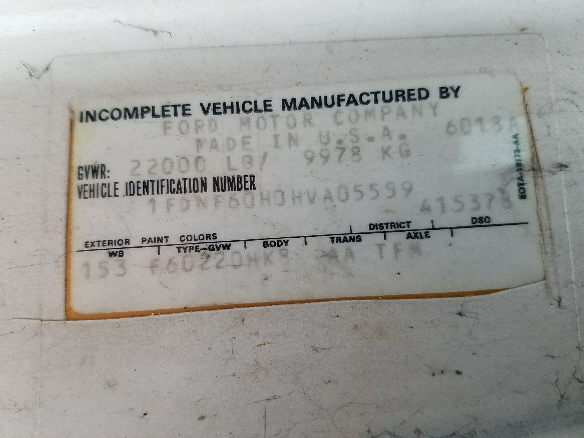

Four Vin decodes, please, thank you.
I have two trucks, with the possibility of getting two more. I would greatly appreciate it if you could decode them all for me.
F50ACG57020
F25YLH99946
F70EVW28999
1FDNF60HOHVA05559
I will attempt to attach pictures of all four plates/ sticker. Your invaluable help is greatly appreciated.
- Mark
Would you type 4 individual posts with one picture in each please. The way you did it makes it hard to decode properly.

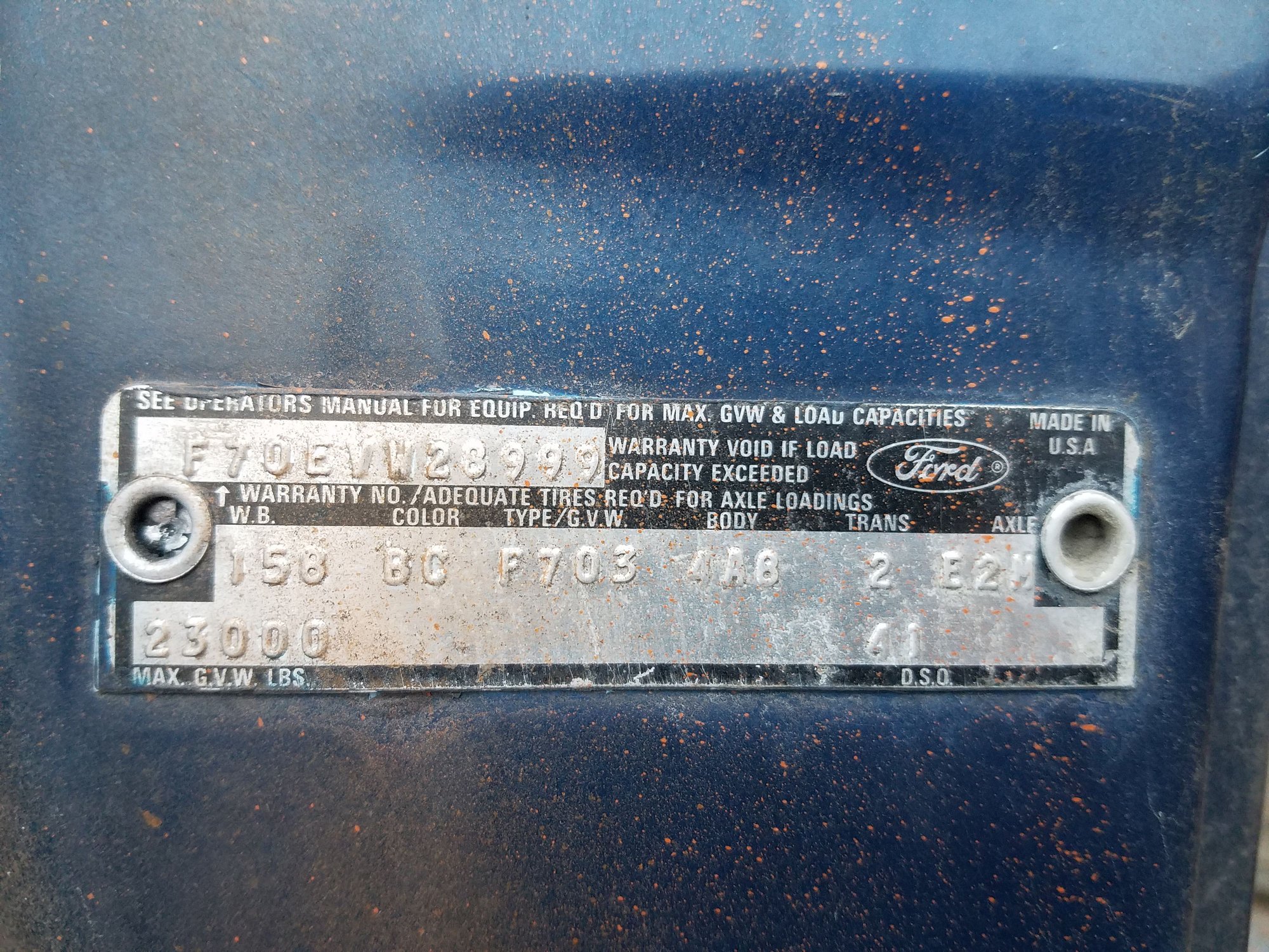

Vin decode #3
Here's the text version of the below picture:
VIN:F70EVW28999
WB:158 Color:BC Type:F703 Body:4A8 Trans:2 Axle E2M DSO:41
Thanks.
