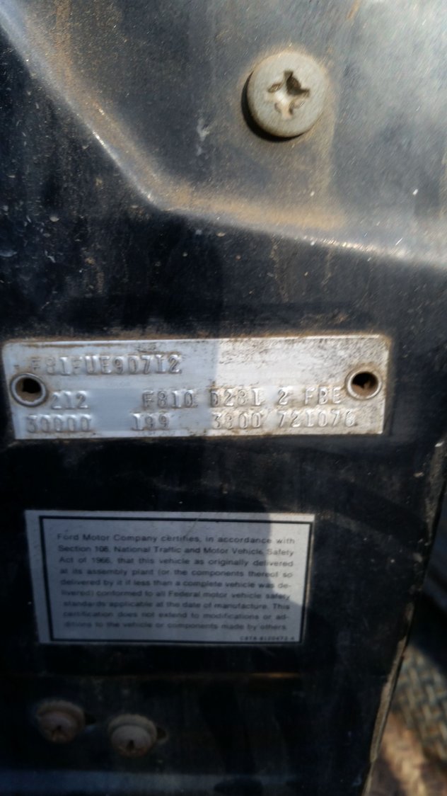

I think its a 66, it's gas with a scissor lift bed/dump truck
Vin # F81FUE90712
212 F810 D281 2FBE
30000 199 3800 721076

Originally Posted by M00S
Vin # F81FUE90712
212 F810 D281 2 FBE
VIN and etc. decoded in your other post on this topic.
Note that 2 is the TRANS code, FBE is the AXLE code.
thank you I just post here because I thought I posted in the wrong area. Now to upgrade this beast
