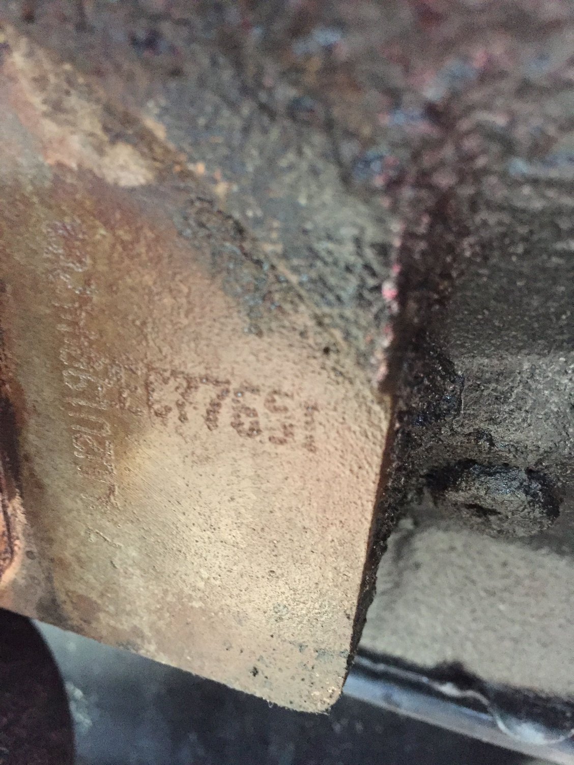

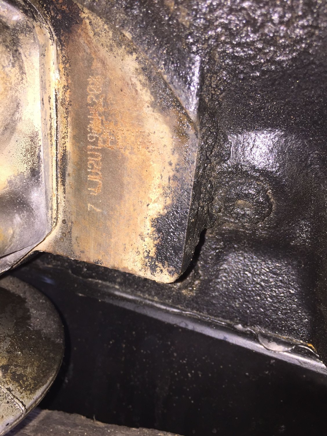

Decode number stamped on engine ? 74JU2U1904420*
74JU2U1904420*
Can this number be decoded?
2EC77651
Can this number be decided?

VIN is incorrect, should have 17 digits (1981 and later).
