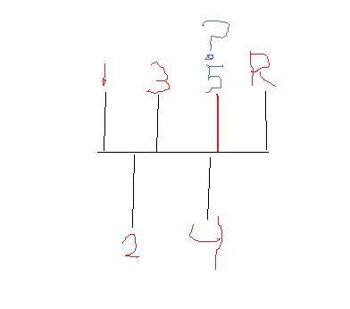

Do you have a list of the trans codes for the 72 F750? My vin is F75EVP31805 but can't get to the codes on the door at the moment.
Truck has a 2speed rear end and is supposed to have a 5speed trans but I can't get into 5th gear. There seems to be a 5th gear up towards the dash between 3 and R, I can get the shifter into that spot with the motor off but I can't get into that gear going down the highway. Tried double clutching, rear in LO and HI going into 5th and I just can't get it. Across the top of the pattern is 1-3-5(maybe?)-R and across the bottom is 2 and 4.
It's been a long time since I've posted on here, hope everyone is well. Thanks.

That don't sound right....this is a Chev site reference, but a Clark is a Clark etc when we are talking these transmissions. Some differences are there, but afaik, not the shift patterns.
The Transmission Page

If you put the trans in that gear with the motor off, then fire it up, what happens when you ease out the clutch? If you have a gear there, it should move the truck a little before it stalls out if it's 5th.

I was thinking along the same lines. Getting on top of a hill, stop, kill the motor, put it in the phantom 5th gear with the clutch in and start the motor and get rolling and see what it does when I let the clutch out. But I'll try your idea first, less chance of breaking stuff.
The NP435 in my 76 F250 4x4 has a spot all the way to the right and up next to 3rd that'll hold the shifter there, but there's no gear. This might be the same sorta deal.

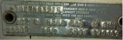

Trim Tag Decoding
If you have time can you decode this for me.
Thanks, Mike
