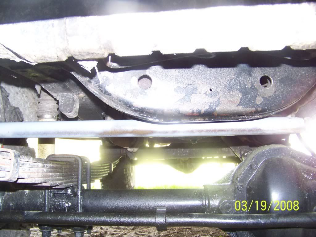

pictures of what? My son or my crossover steering?
eeeh...
Ill post both.
