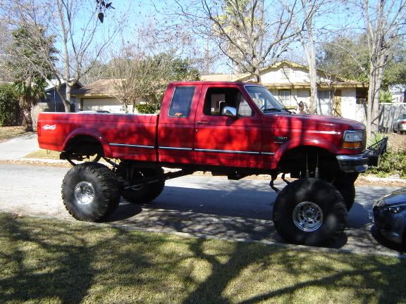

this guy didn't need a 4-link to clear 44" trxs's, or what i like to call bfg at's bigger fatter cousin
don't let the man get you down dill, 4-links are for dragracers and sally's
