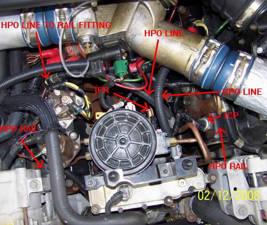

I've just read this entire post. It was VERY helpful since I was having a no start issue with my '02. After reading part way through I saw where you could disconnect the icp and get the truck to start. I tried that but it didn't work. However, I disconnected the connector that is in the lower ctr of the pic in post #70 - the one that is unnamed. After doing this the truck started right up but with the c.e.l. on. I then reconnected it and the truck started and ran normally.
2 questions: 1) what is the sensor called that I disconnected and would that be my problem or is it the icp? 2) how do you check the oil level in the hpop? this is mentioned many times but I don't know how to do it
I also had the p1212 code (injector pressure lower than expected) when I checked it before getting it started. After it started I got something like "oil temp sensor high voltage" code.

The picture in post 70 has both the IPR and ICP labeled. I don't see any other sensors in my picture. Sounds like it was the IPR.

I knew someone would post before I could type so I just waited this time. Thanks for bringing the picture back Barry. Is the sensor you unplugged visible in that picture? What was the plug attached to, the motor of fuel bowl? If no one posts a picture of how to check the HPOP level in the next few minutes I will, but I seem to be slow these days.

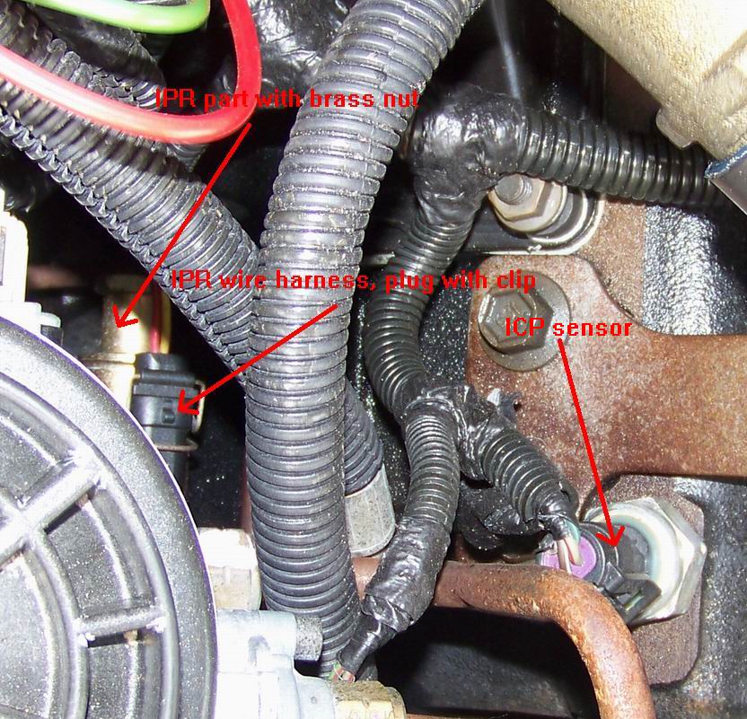

Here's the other one. Maybe a better look.

can't see it in picture #1 - it's attached to the wire in the center
you can see it in pic #2 - to the right of the fuel bowl
