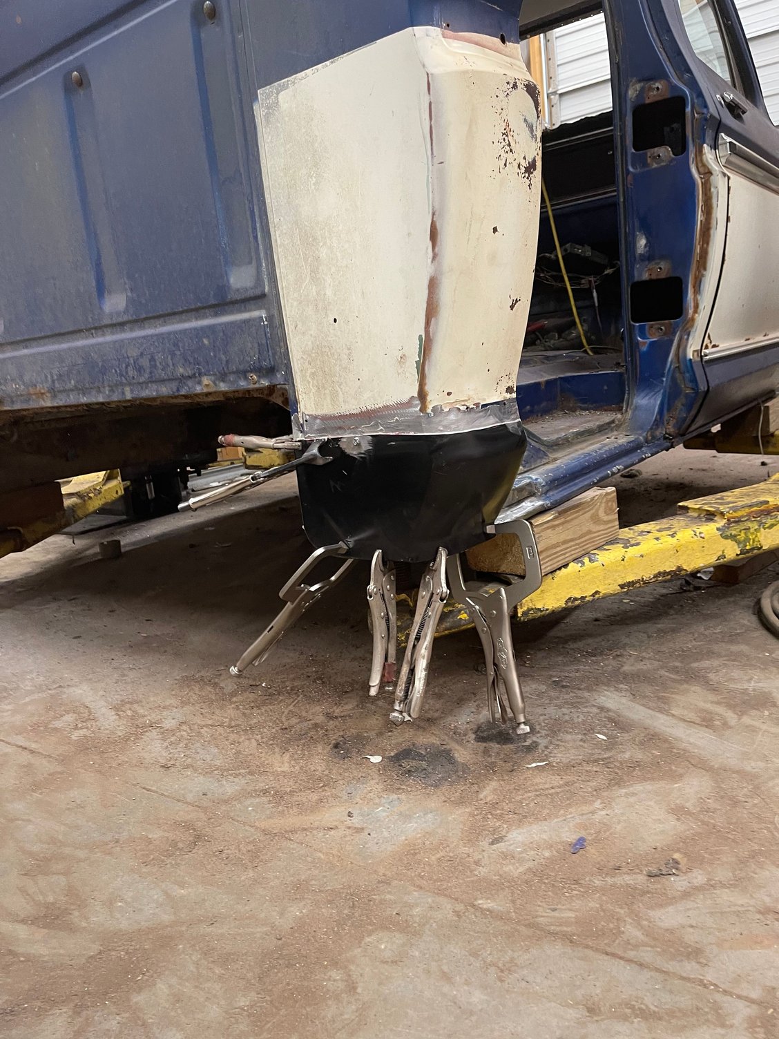

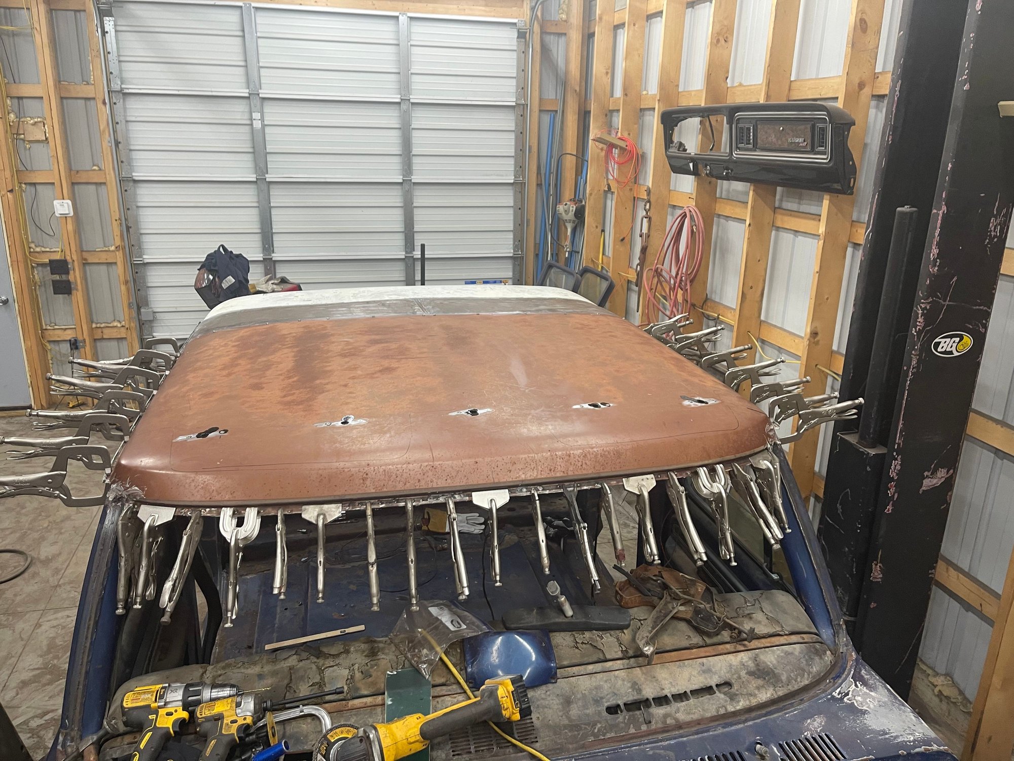

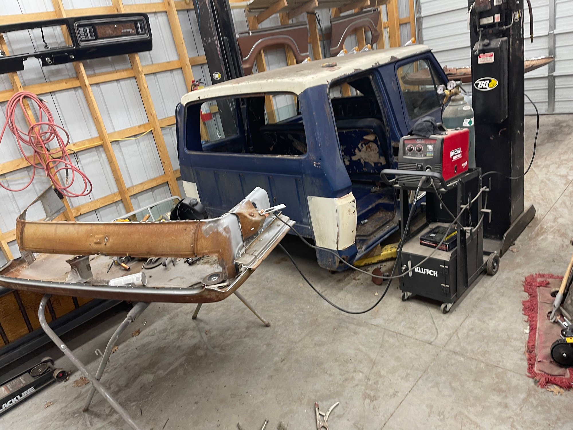

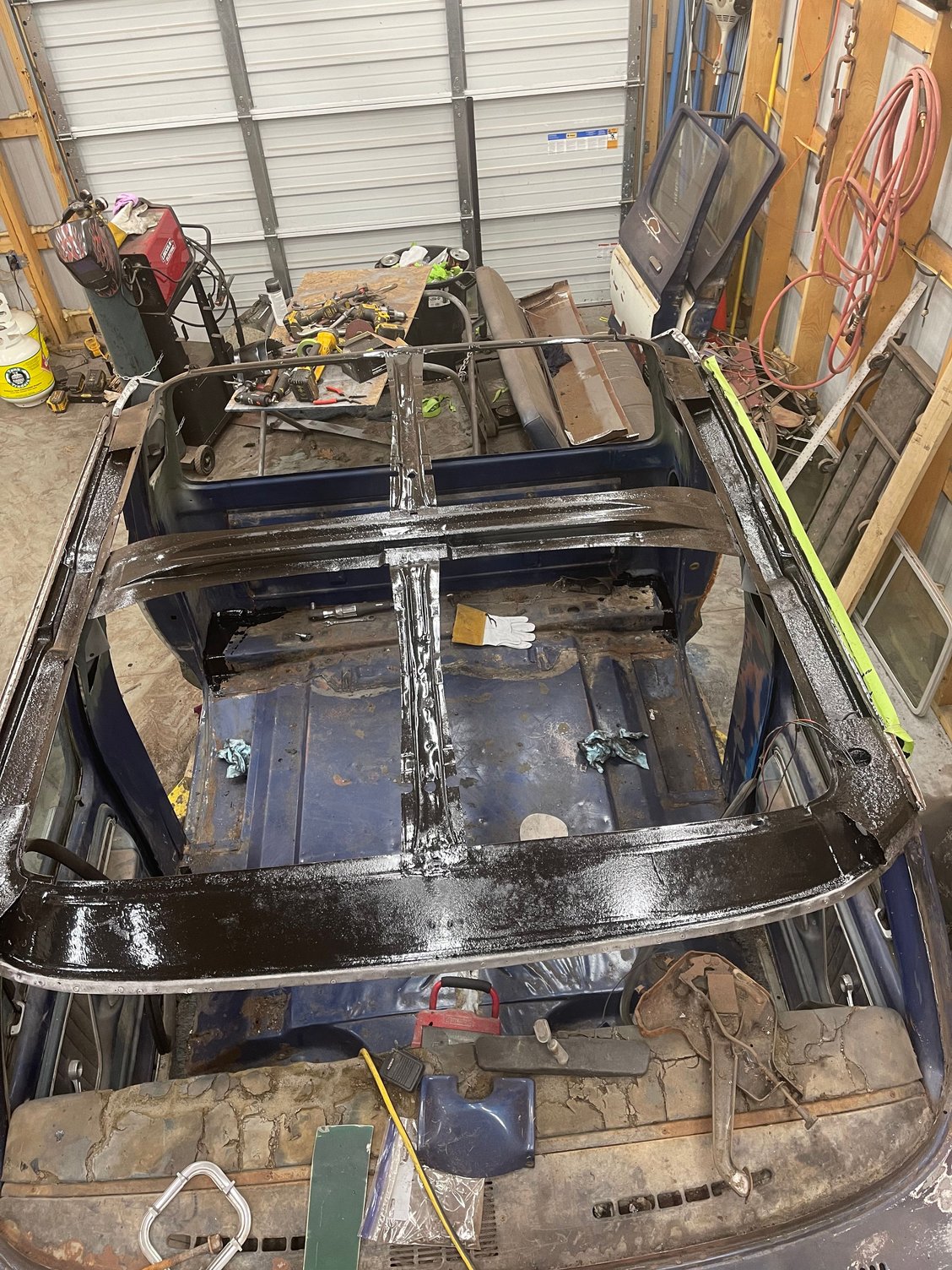

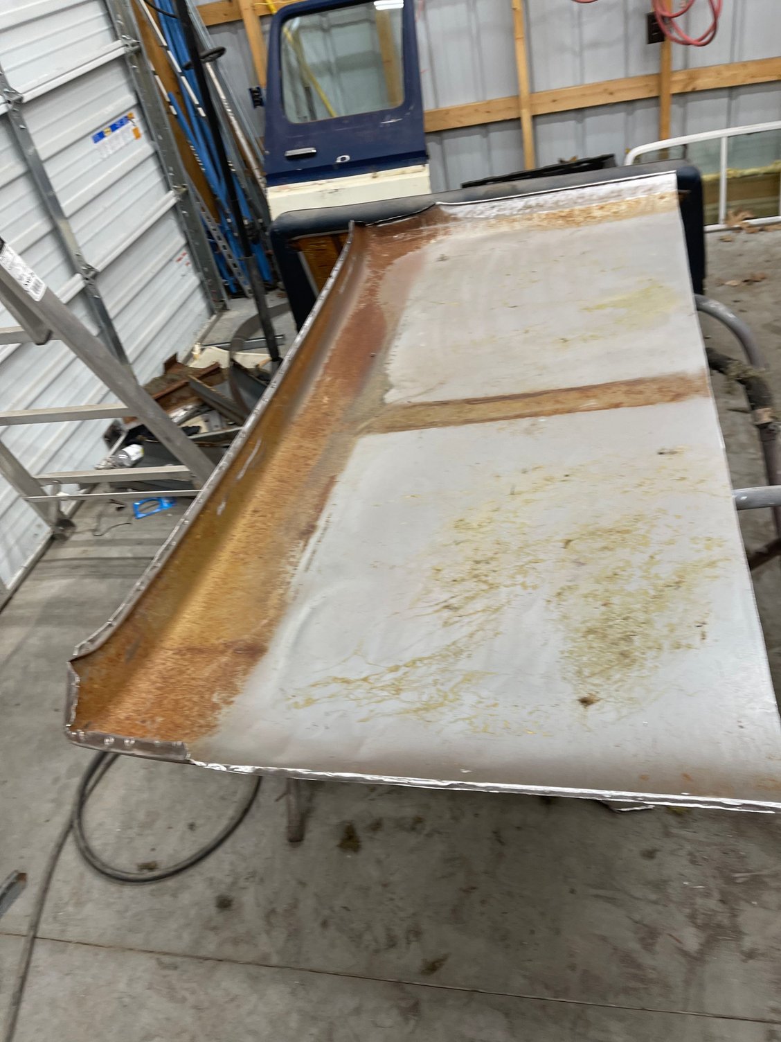

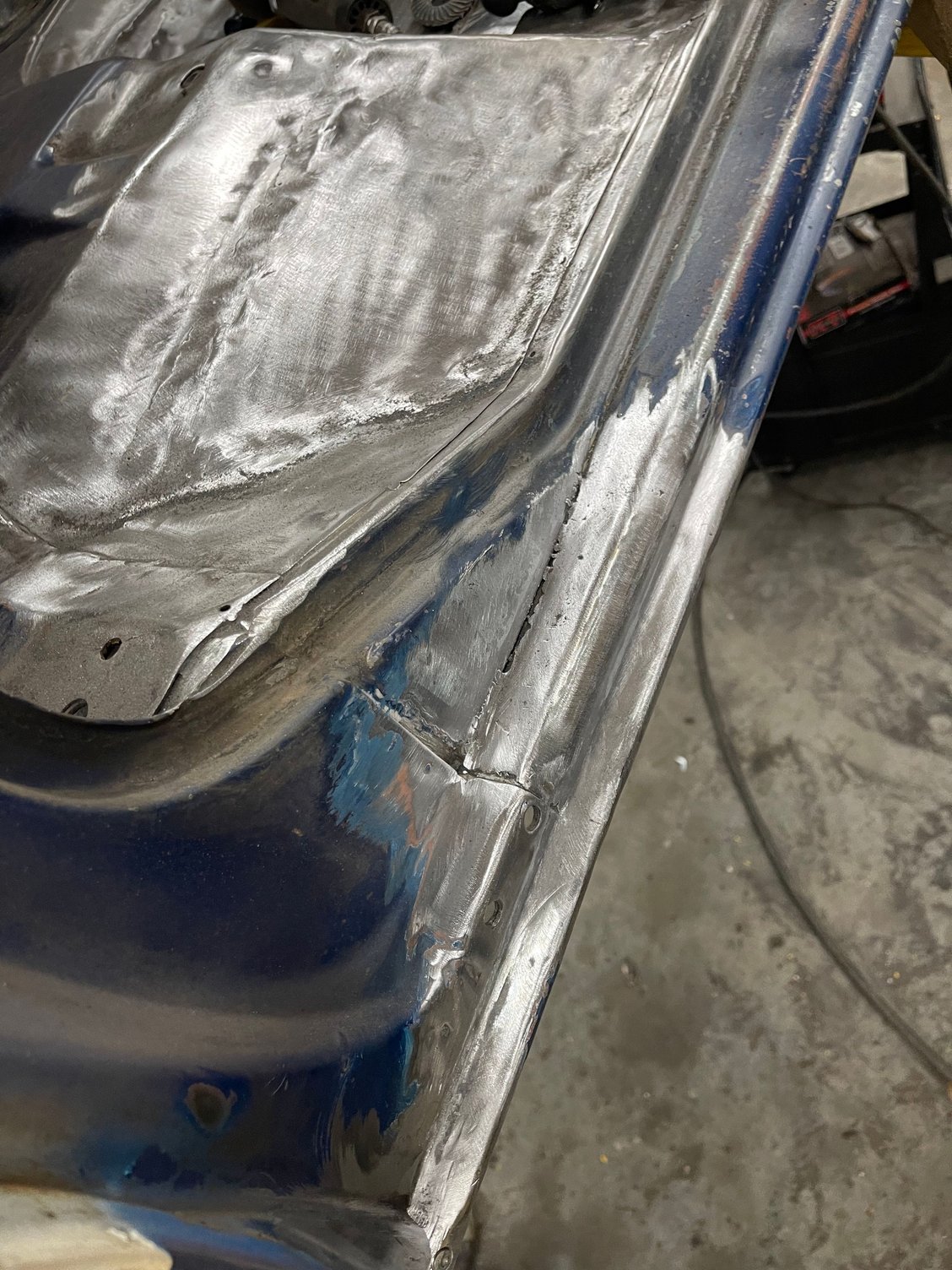

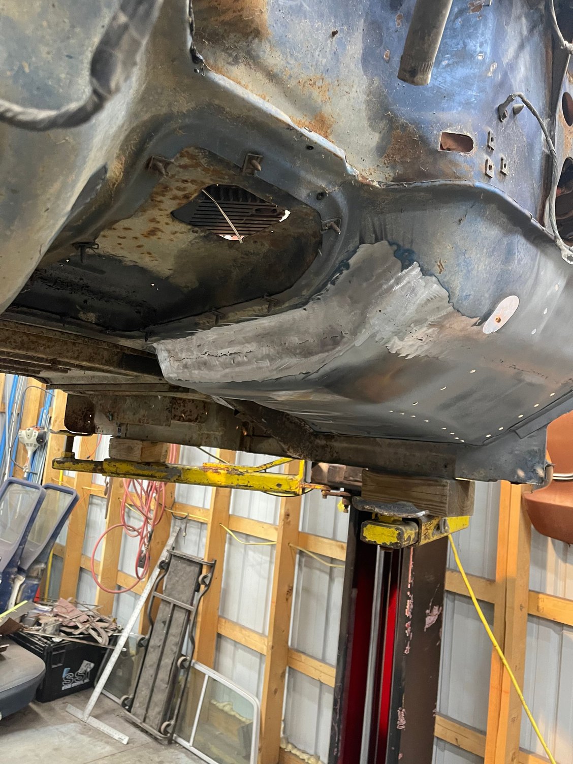

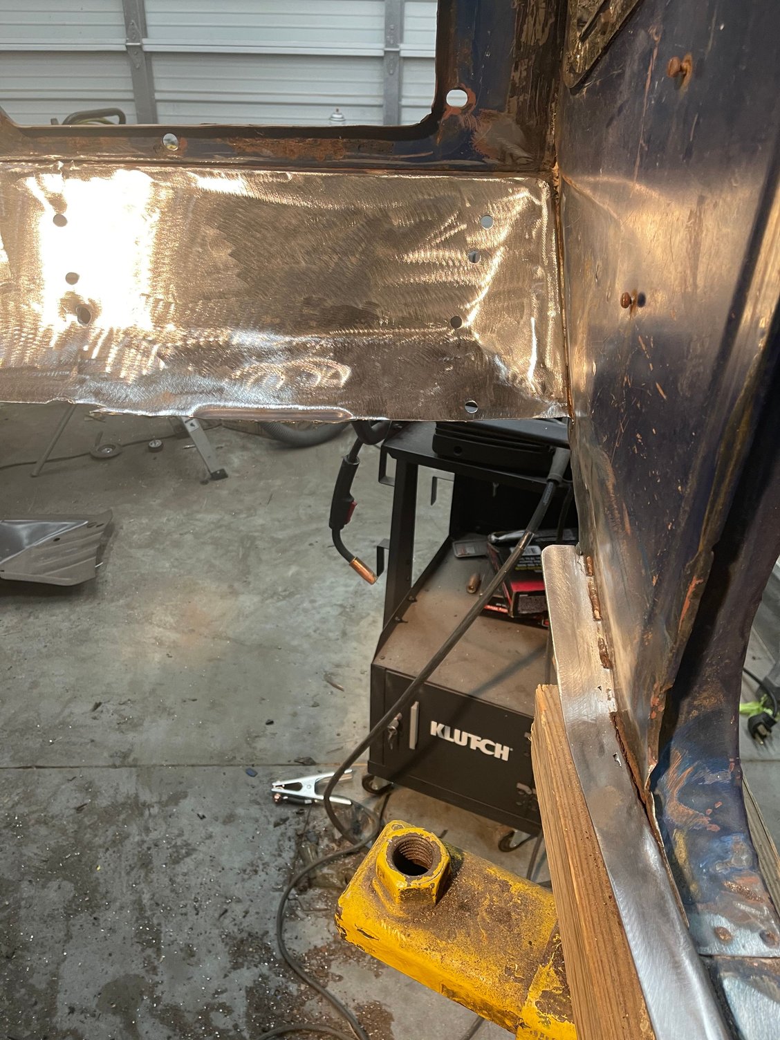

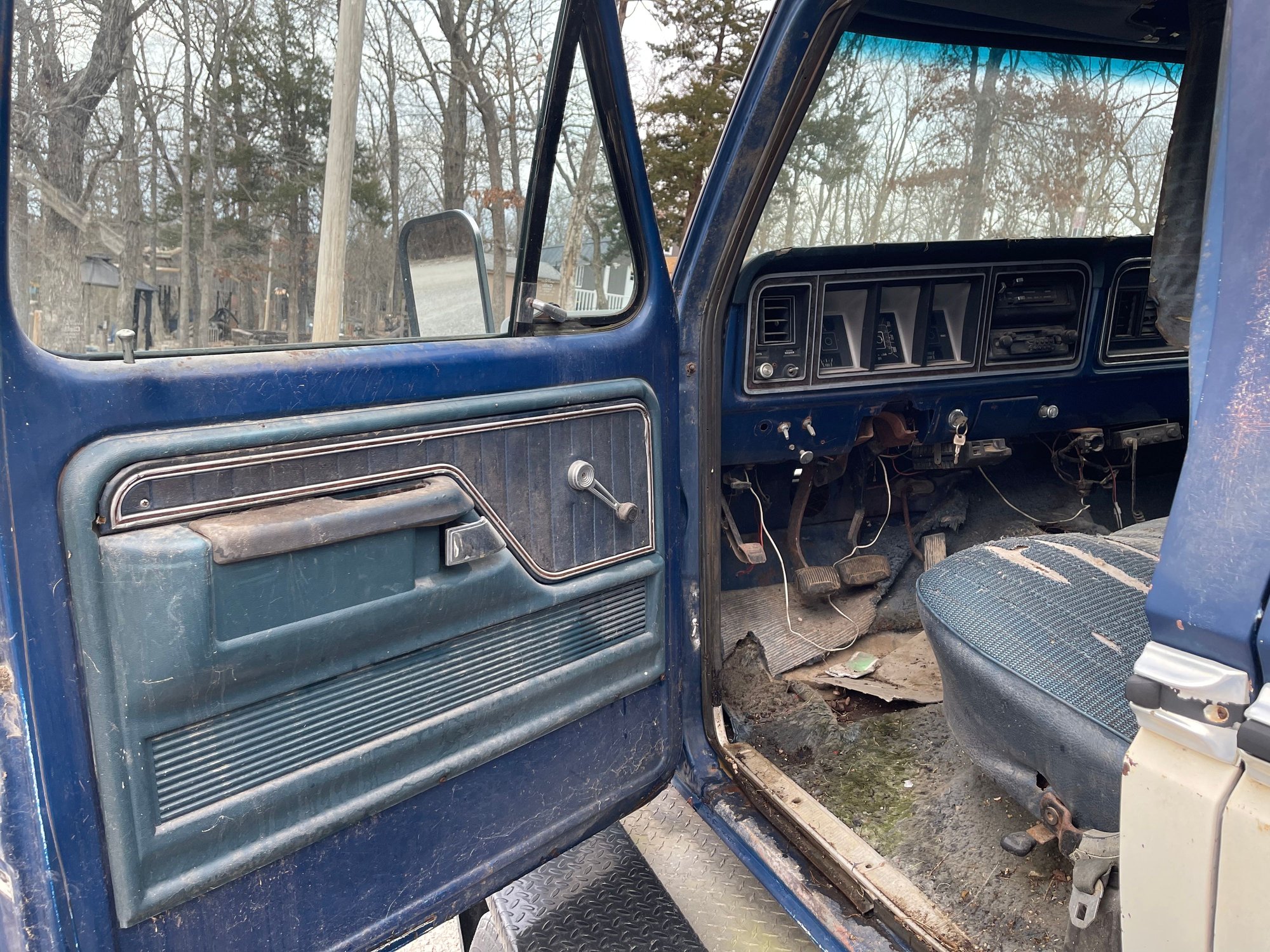

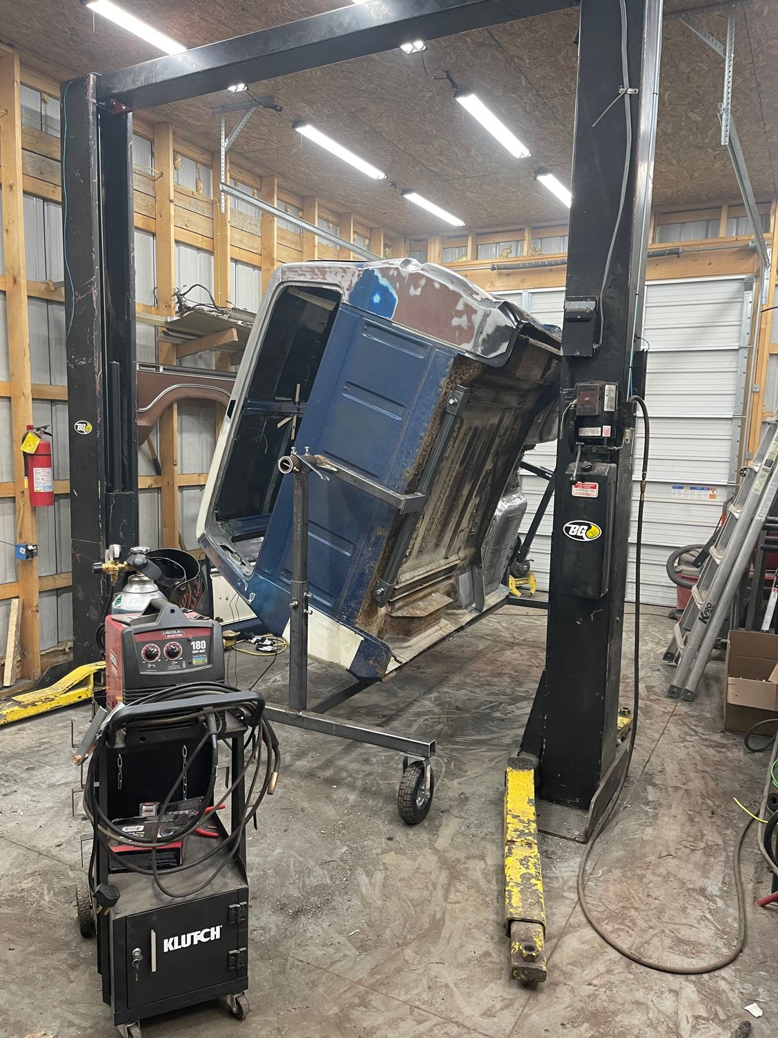

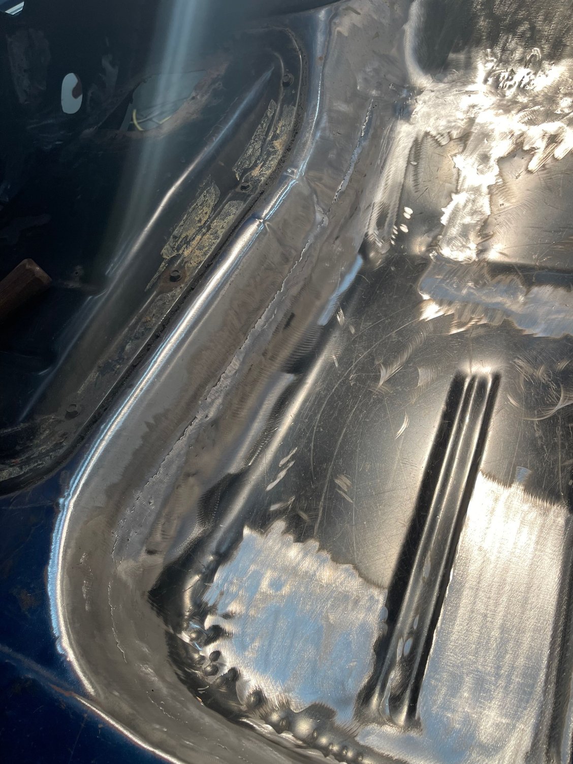

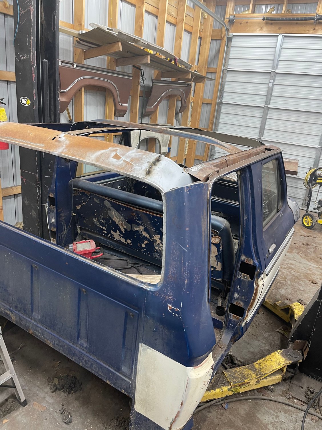

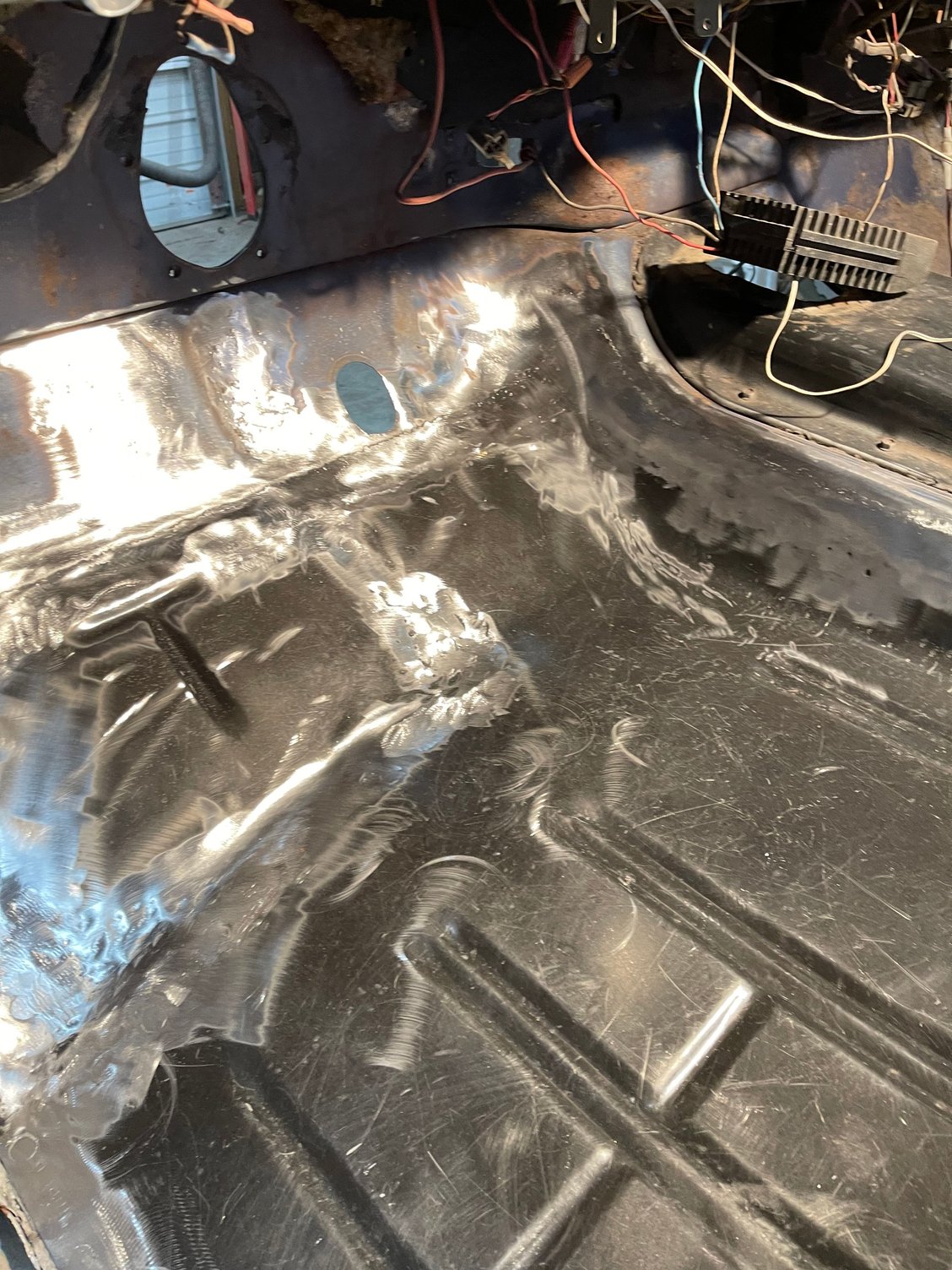

My progress of my 77 Crewcab.
I am building what Ford didn’t. A Crewcab long bed 4x4. Here is some of my
