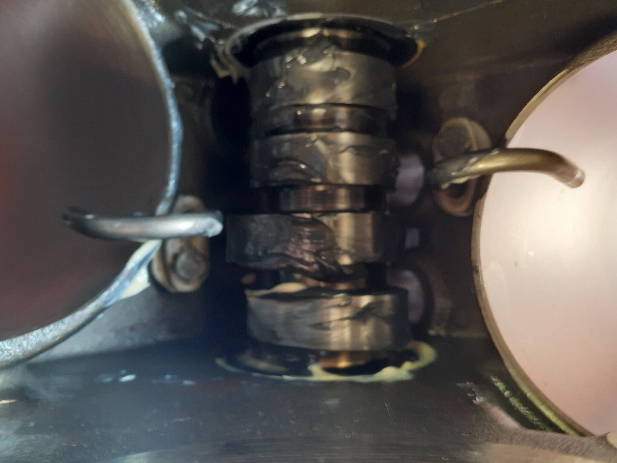

I took the crank back out, removed the bearings, stuffed a bunch of rags into the block, and got out a brand new 8" fine grit stone. With lots of oil I did a quick touch up on the block mating surfaces and the same with the girdle. Cleaned everything up nice and good and tried it again. Now it's roughly 0.0025". So there must have been a little defformation on those surfaces or some grit I missed the first time. So I little happier now.
Got the piston oiler tubes installed, got the cam sprocket pressed off the old and cam and onto the new cam. Greased up the cam and got it installed. Greased up the main bearings and installed the crank for the last time. Got the branch tubes sitting in place. Installed the rear timing cover and a new rear main seal. Re-installed the cam and crank sensors. That was enough for the day. Now to get the block matted to my engine stand and think about installing the pistons. B.

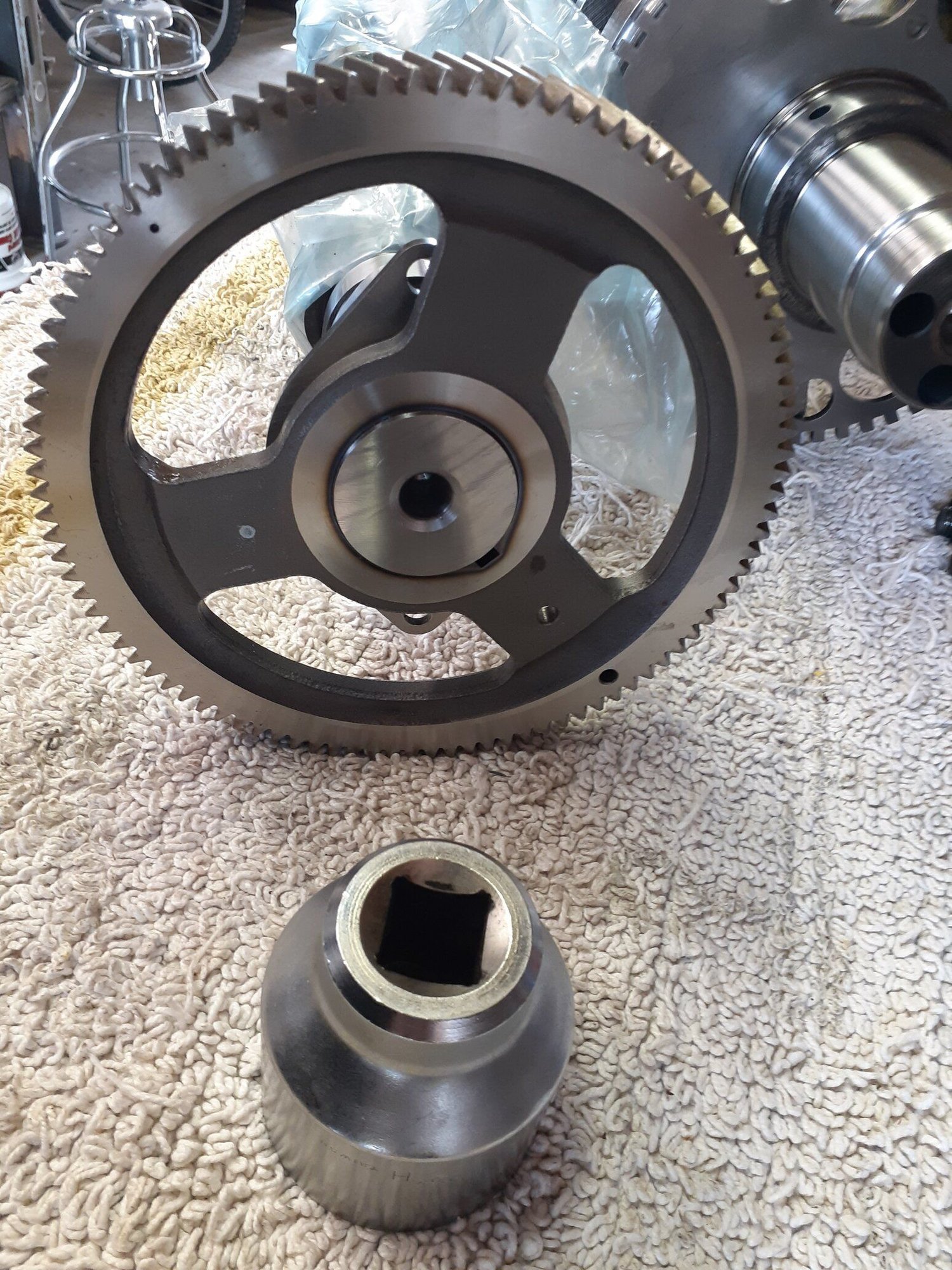

Yesterdays work. For those wondering, you can use a 15/64 drill bit to locate and hold your camshaft when installing the crank shaft. The bit goes through that hole in the sprocket and into a corresponding hole in the block to locate the cam. B.
A 2" 3/4" drive socket works perfectly to install the cam shaft sprocket.
