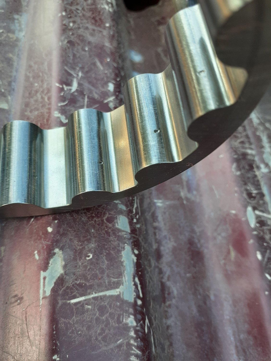

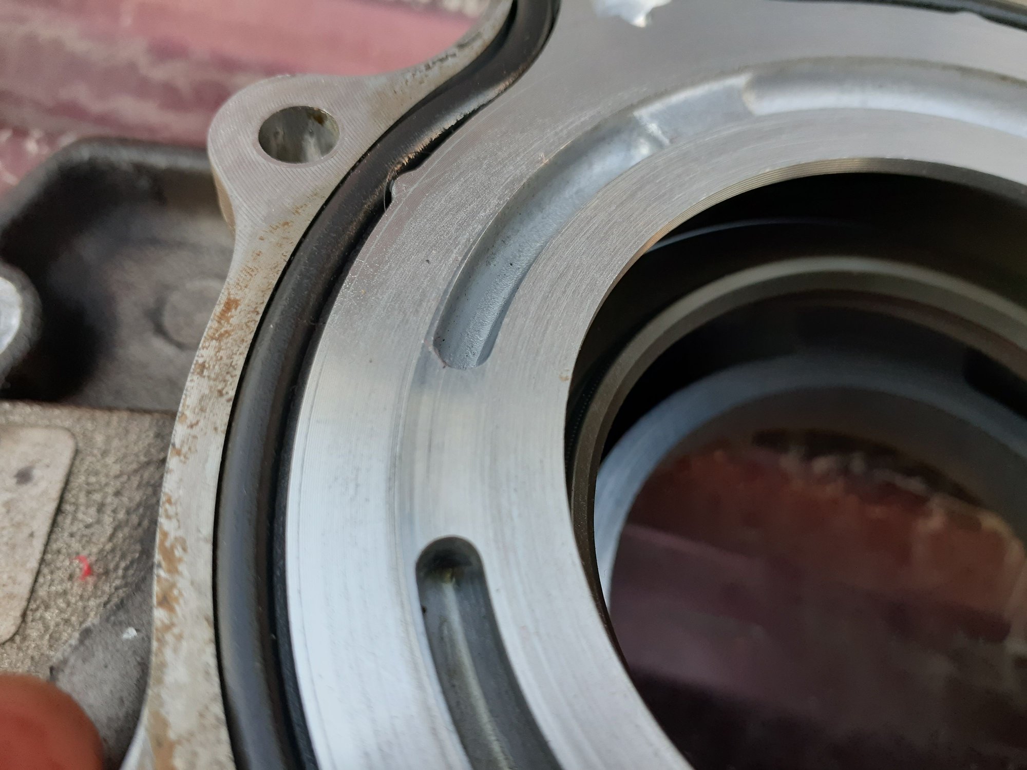

Well, I did a partial tear down on my engine today. Got the front cover off and disassembled the LPOP to inspect it. Great news. The front cover looks almost new. And the wear on the oil pump rotors is nearly non-existent. So I am very confident in re-using my front cover and installing a new LPOP for good practice.

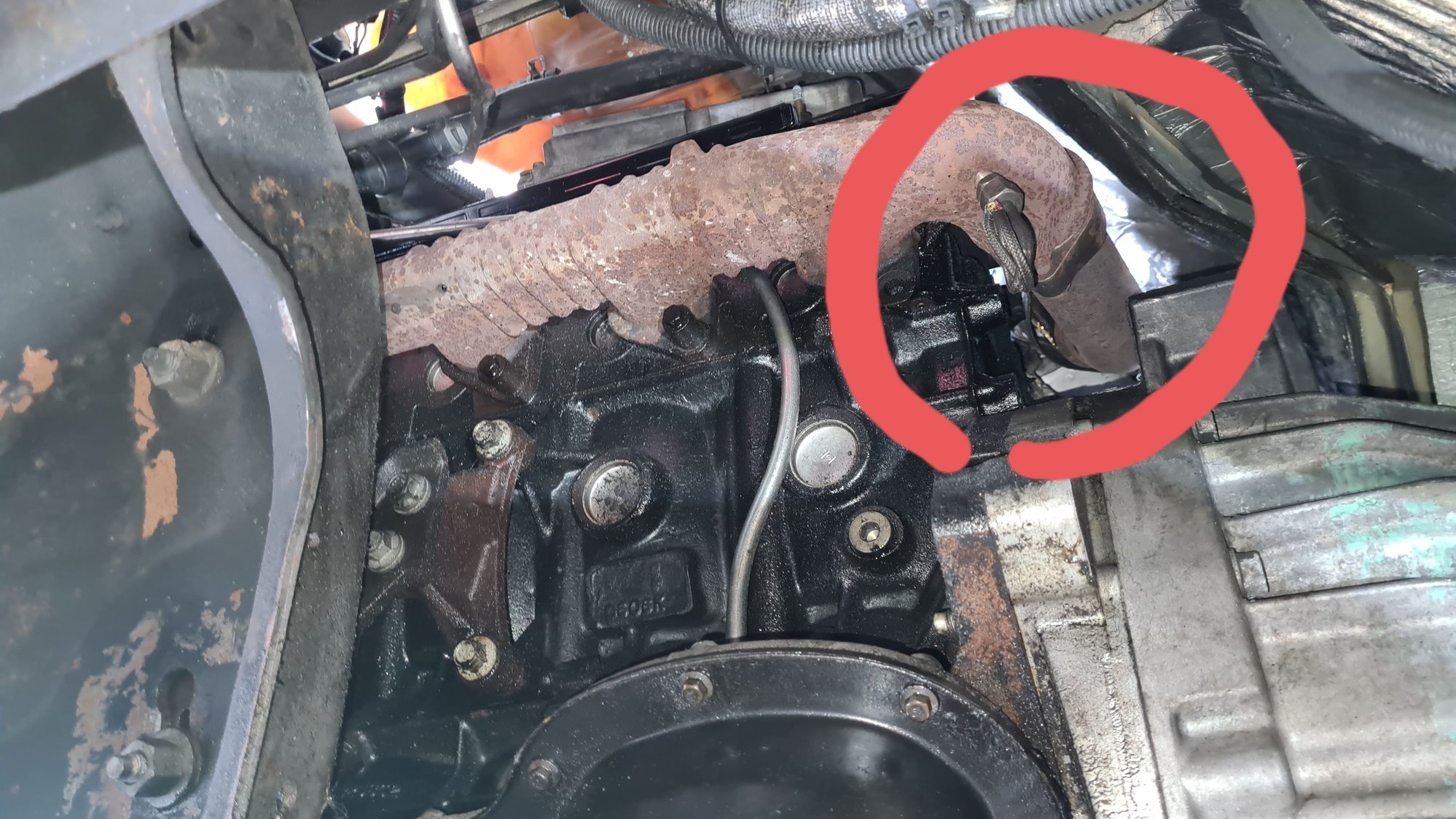

When drilling for a pyrometer probe in the exhaust manifolds, where do most guys drill at? I know I want to drill on the downstream side of the last cylinder to get an even reading of all four cylinders on a single bank. But do you come in from the top, the bottom, or the side? Is there enough meat in the factory manifolds to get enough threads for an adapter? B.

Pyrometer location.
renew shown parts.

there are several locations people use, here's another.

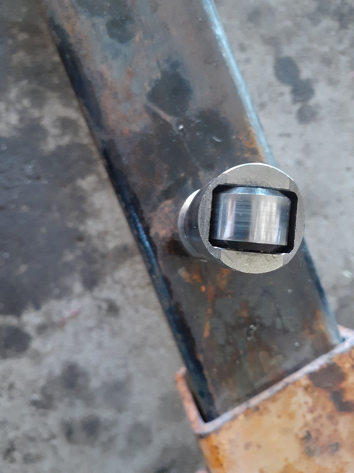

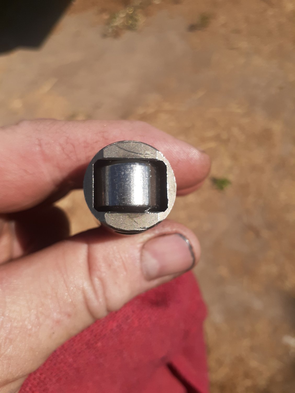

Well, I stripped down my engine today taking off everything I will need to reuse on a short block. For shins and grins, I pulled out the rear lifter guide on the driver side of the block to inspect the lifters for cylinder 6. As it turns out, even IF the rings were still good and a head gasket job fixed my engine earlier this year, I would STILL be pulling it at an as yet soon determined date anyway. Take a look at these pics. The first two pics are of the lobe and lifter at the #5 position back from the front on the driver's side.

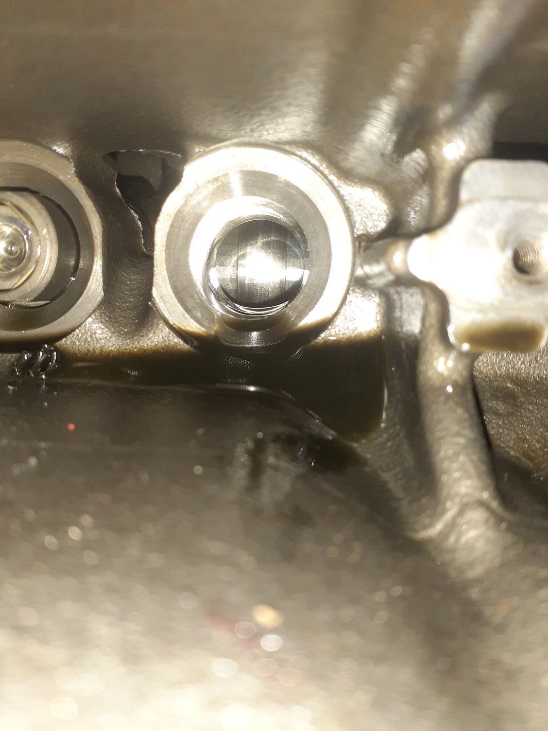

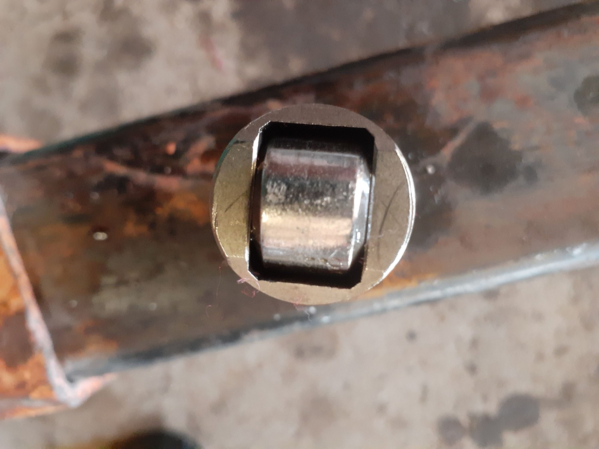

Now, take a look at these three picks. This the hole #6 back from the front on the driver's side. This lifter and lobe would not last too much longer I'm afraid. In the not too distant future I would have been doing a cam job anyway.
The roller on this lifter was grinding as I spun it with my finger. Obviously the needle bearings were failing causing the roller to drag as it spun. The fate of this engine was determined long ago I'm afraid. Even if the top end work fixed my issues from last year. I would still be in this same position today anyway. Why replace a wiped out cam and lifter at 200K or so? B.

To have the surfaces on the pump gears and cover surfaces, you had to have things going through the oil system. My first question would be, did the truck have an oil cooler replacement in the past?
I have in threads here and in lifter video examples of the needle bearings scoring and fracturing, which is the start of the roller failure. You can pop the axle out of the lifter if you want to inspect the needle bearings. The unit pressures on those needle bearings are huge, so it doesn't take much of an oil lubrication failure or debris in the oil to set the stage for cam and lifter failure.
180k to 250k tends to be where lifters and cam go bad.

I bought the Ford lifters in kits. I don't think I know of one brand of aftermarket that did not have issues.
Sometimes it's easier to get good focus backed away from the object. If you use an iPhone, the Camera+2 app is pretty good and has a macro manual focus. The cam is best viewed out of the block and wiped clean. This image shows you've had debris floating in the oil. Your one out of focus looks like pitting was starting to develop.

Ok cool. Yes my deltas were getting into 18 degree range. Plus my EGR cooler was leaking at the time as well. I was trailing clouds of steam from my tail pipes. The lifter 6 A/B pics there is definite pitting of the roller. And I could feel it grinding when I spun it with my finger. Maybe I'll take it apart tomorrow and see how bad the bearings are. B.
