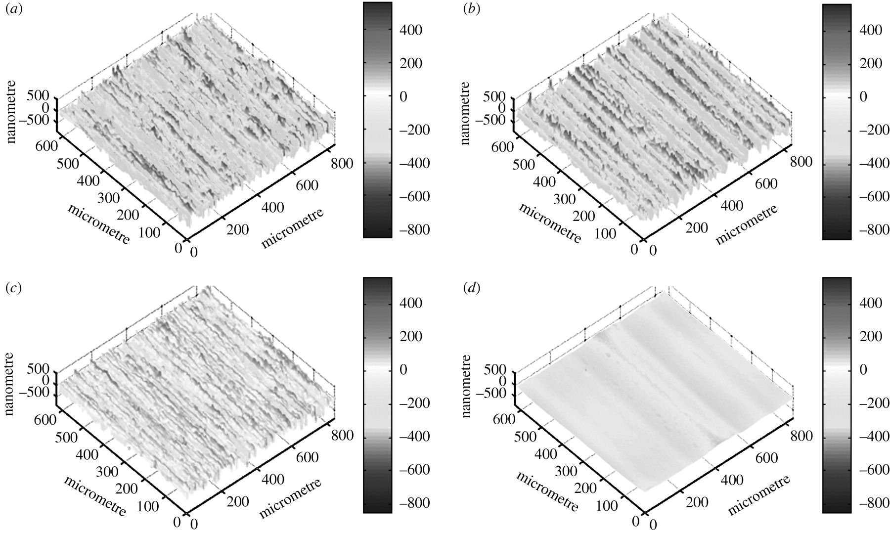

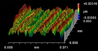

I also polished my Colt cam, but that's another story. Too smooth and the surfaces can slide; too rough and stress risers. Let you know if the motor ever gets to 300k,

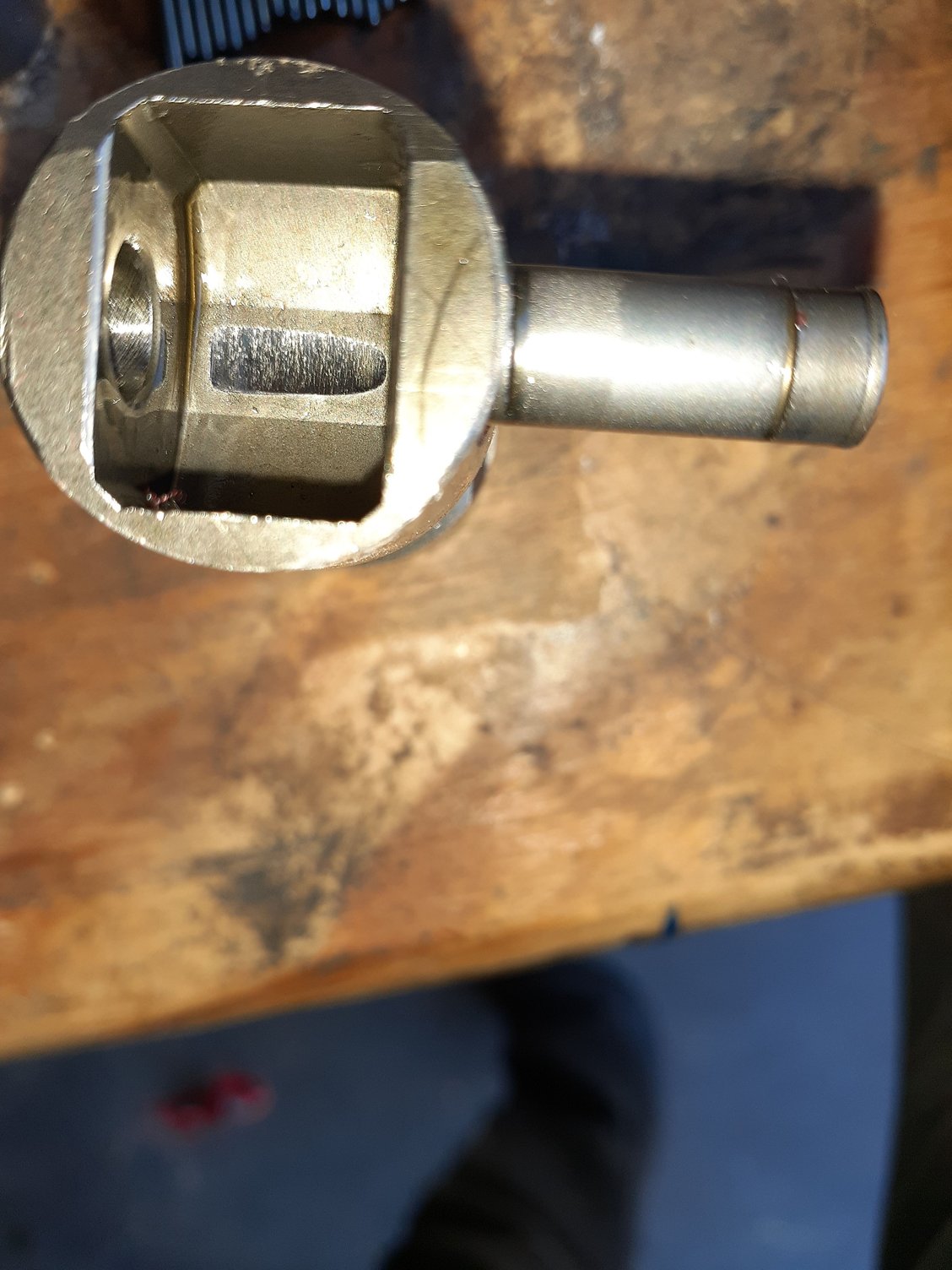

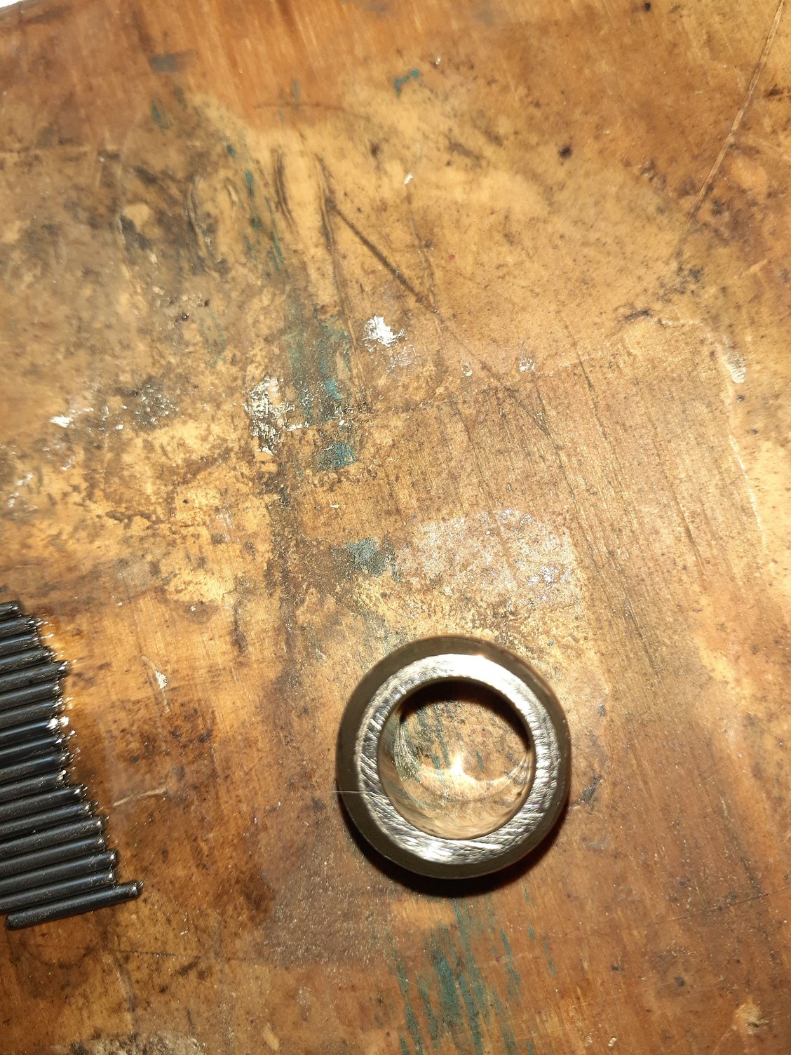

Ok, I pulled the "damaged" lifter apart from cylinder 6. Considerable amount of damage to the roller axle. You can also see where the roller was hitting the under side of the lifter. And the roller is obviously no longer round. I don't see any discoloration or caked on oil residue indicating excessively over heated oil from an over fueling condition caused by a bad injector. I'm kind of wondering it was just a bad lifter? Take a look. B.

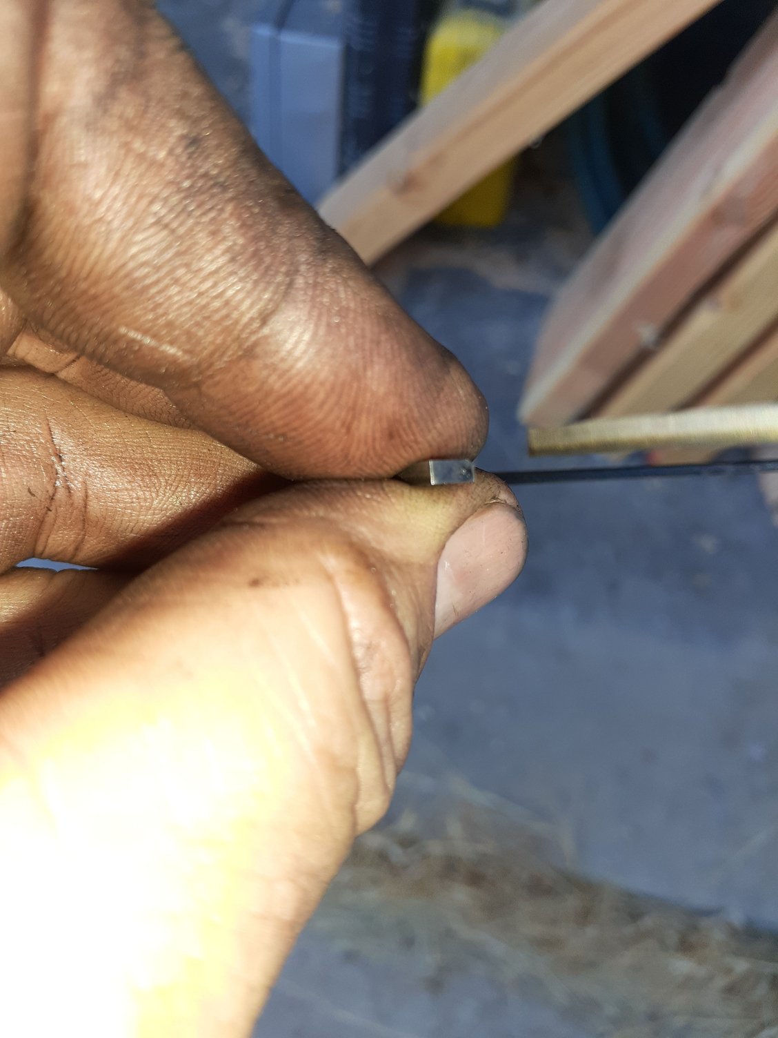

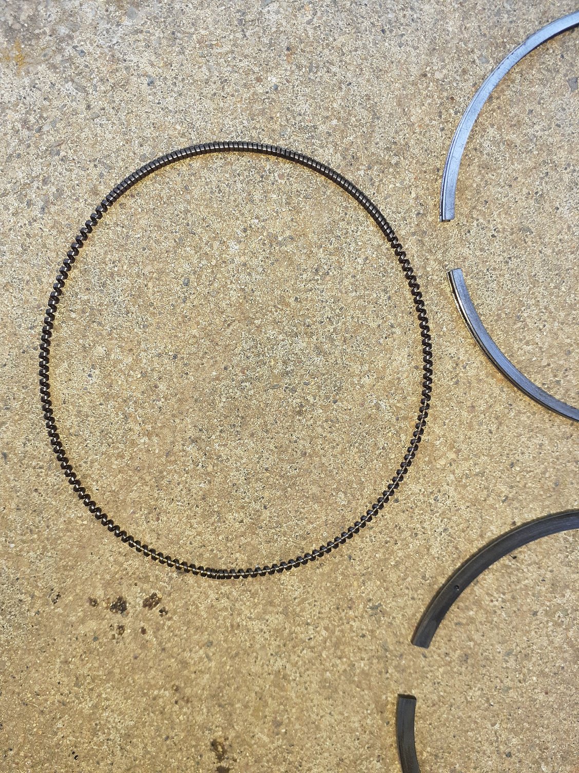

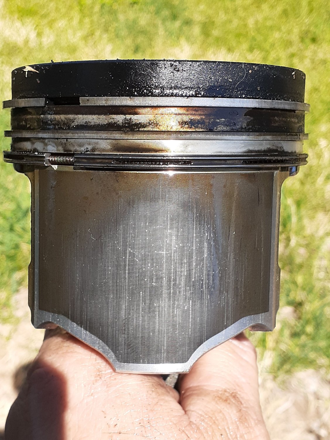

Ok, here is the cylinder, piston and rings. The top ring is beveled? I have never seen that before. The side are not parallel. The end gape on the top ring was .013". The second ring has parallel sides. And the end gape was .054". Excessive I would think. And the oil control ring is um..... unique? I have not seen that design before. And the coils are not consistently would. Is that normal? Take a look. B

It's hard to say without extensive research what the initial failure is. You have to catch multiple failures and see the trend. For example, did a needle start the process and hurt the lobe, or was the rough lobe the cause of the needle failure? Or did the surface of the hardened axle fail first? From my viewpoint, you will not see carbonized oil on the surfaces of failed parts; it's not that kind of failure. I believe this is why there is so much research being done for the last decades about cam failures.
From Chevron's paper that I posted here already, highlighted for my video, not for this discussion. However, this 2000 paper is oil-based. All the highlights from my posting are related to the video. Since then, we've gone through many oil modifications, and those of us who have done oil analysis has low soot %, nothing like 5%. Mark has gone through a lot of gymnastics about the changes in oil over the years.
The valvetrain is highly loaded with a 6.0. It's why I spent so much time publishing work and still have more to finish.
When I did the Hertzian contact pressure calculations for the lifter needle bearings, it wasn't as high as what's achieved on the cam lobe. But the rotational speed is much higher. When I went through my needles, I did find some fractures and some debris scoring. I found the same from Pete's (87crewdually) when I took his front, easy access lifters apart, although not as bad as mine. As yet, I haven't had time to do Dexter's lifters.

So what type of oil additive should I use when breaking in a new cam and lifter? Is this the normal profile of the top ring? I have never seen a top ring with a taper to it. B.

I haven't had the pistons out of my one and only Powerstroke, so I can't comment on the rings. However, Mac (Smackdaddy) has. But I've encountered tapered rings over my lifetime.
Is that your worst-case cylinder bore because that does not show any deep scoring, just light scuffing. Is there a wear groove at the top (ignoring carbon buildup) of the cylinder where the ring stops? And your rings gaps are within spec. Do you feel any play in the piston rod bearings?

All of the cylinders appear about the same. No ridge at the top. Piston pushed out with ease. B.

Considering the trouble you have finding a local machine shop, have you considered the engine may just need a complete cleaning and a ball hone refresh? I don't remember how many miles you have on it. It's always hard to tell about deep scratches without being there.
