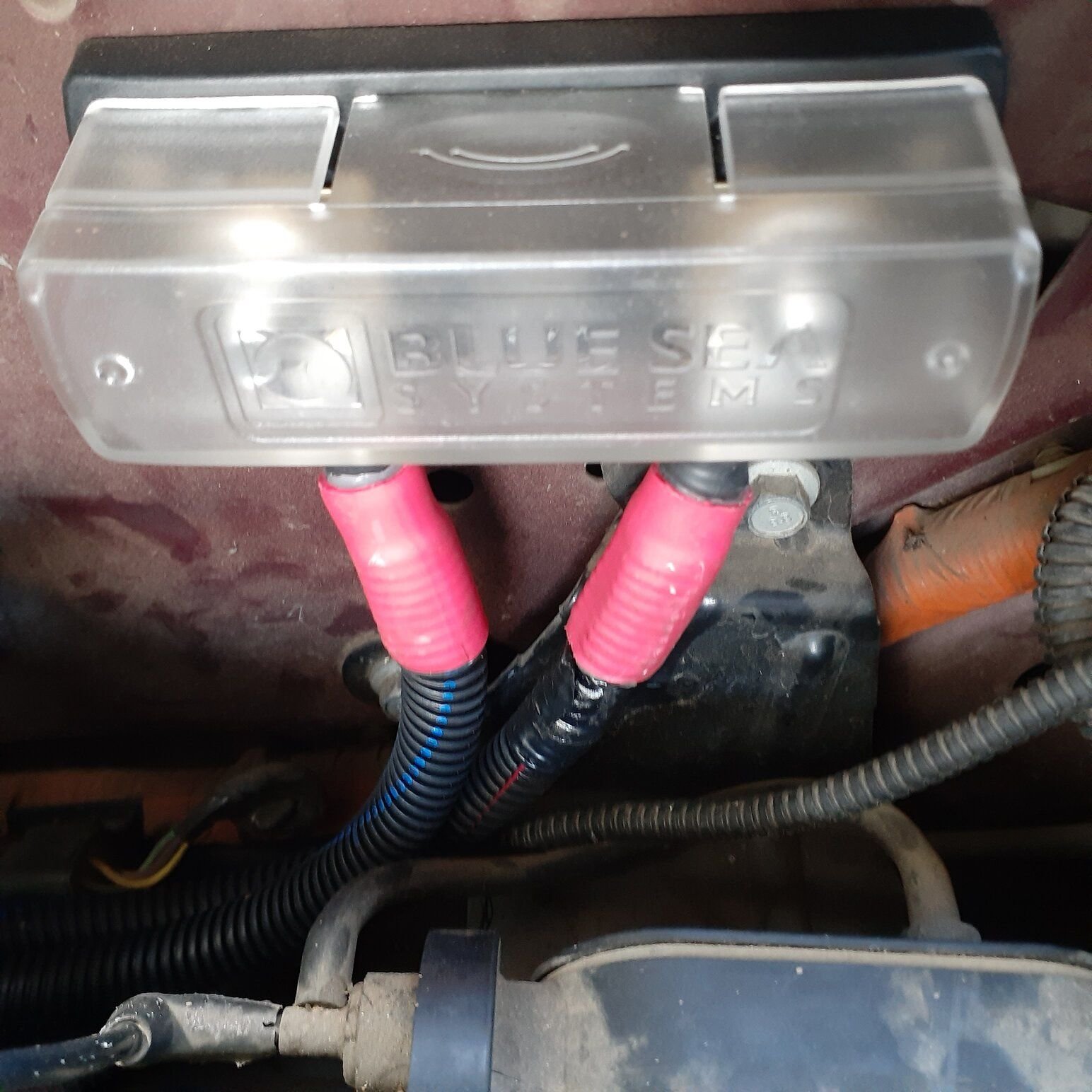

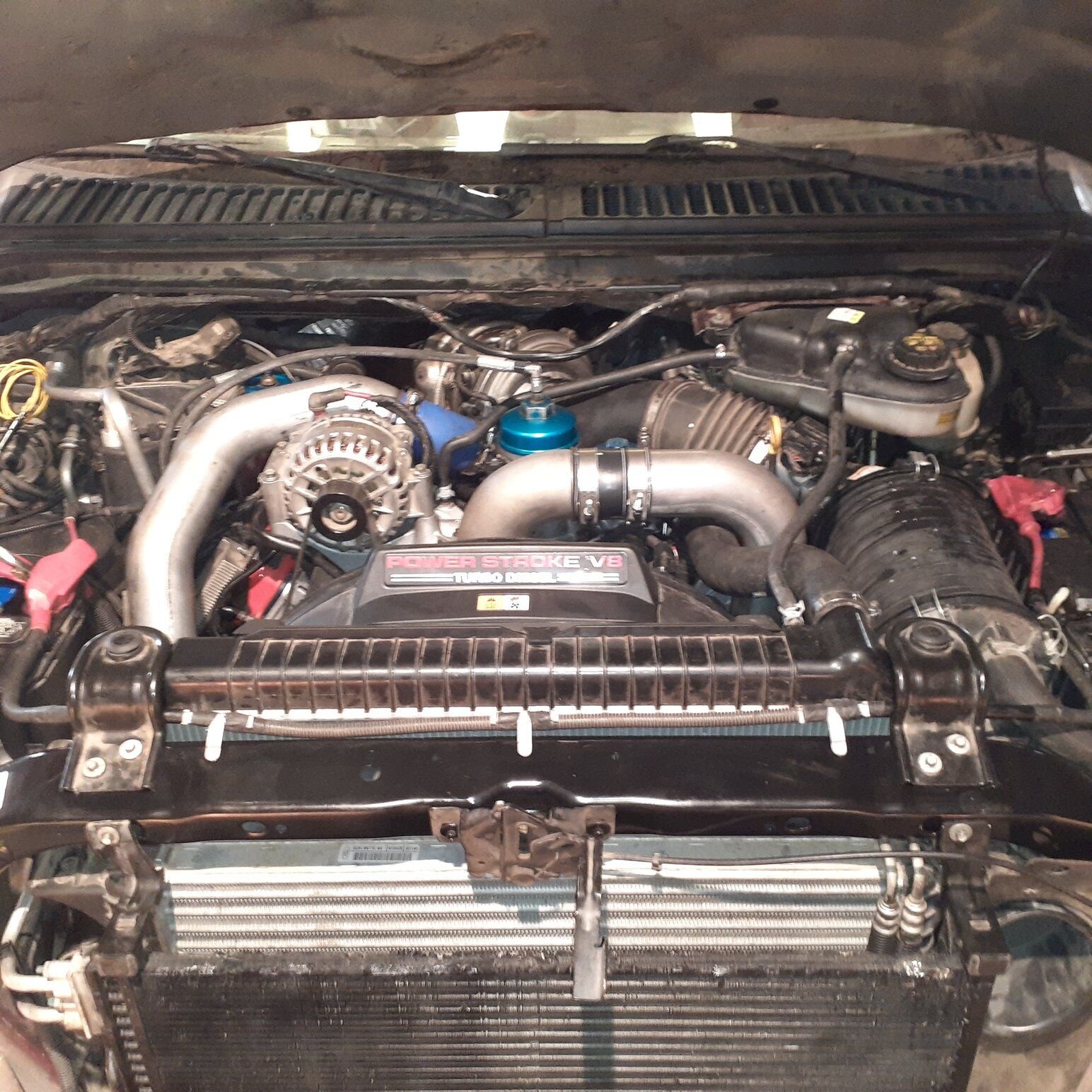

Well, she is DONE!!!! Got a new set of alternator to fuse to battery cables and fuse holder installed. Got the A/C evacuated and recharged. Got the gauges all done. Got my new DTRL's hooked up using a factory Ford module I found on ebay. Took her for several test drives over the last week. Buttoned up some wiring today. And finally got around to giving her a bath today. Now it is time to drive and get her broke in. And pray she will last a very long time. Because I don't want to go through this again any time soon.
Thank for ALL or your help and input and suggestions. B.
Co-pilot ready for flight (LOL). A little dusty, but then again, she has for all intents and purposes not been drive-able for a solid year now.
