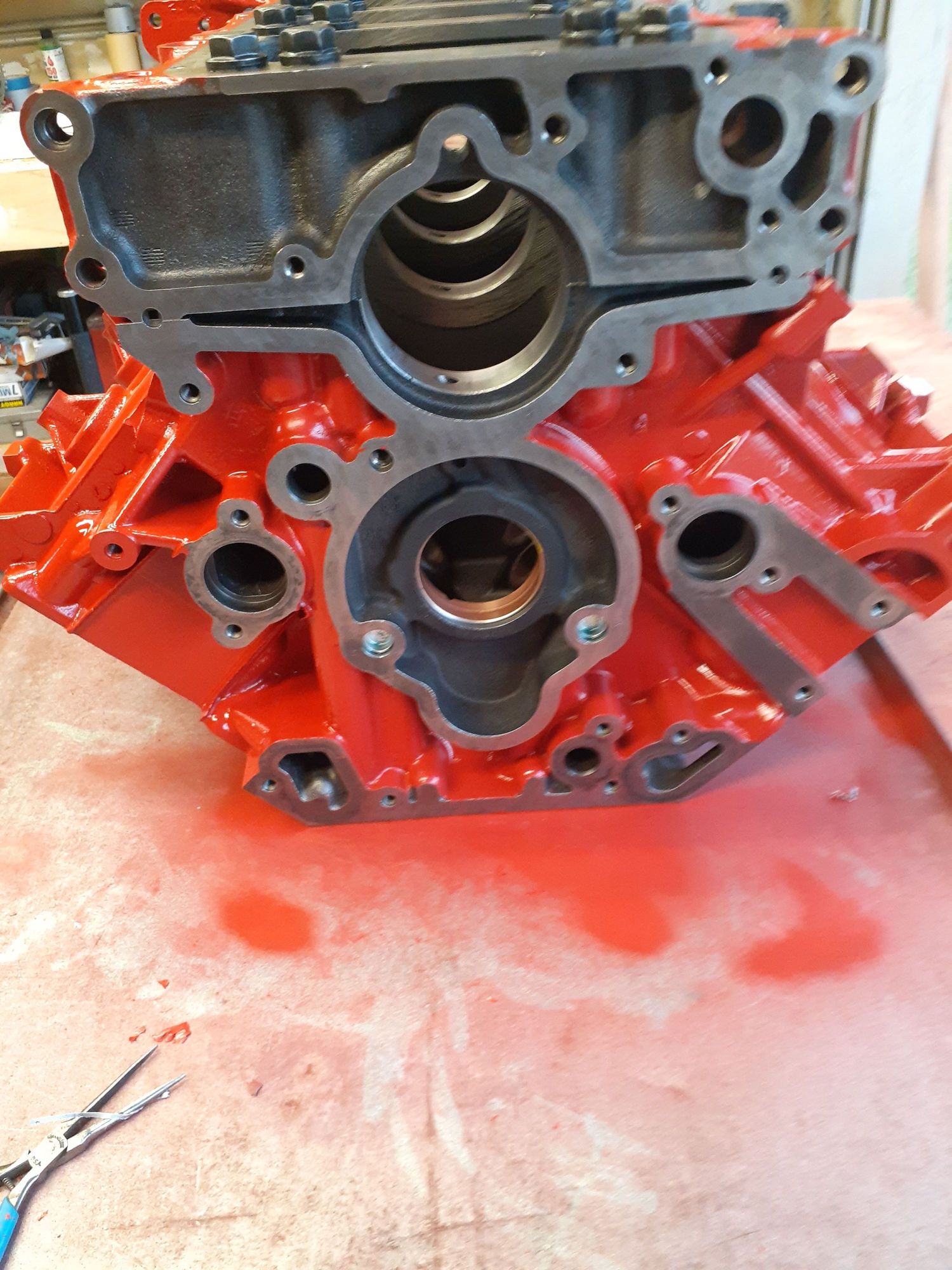

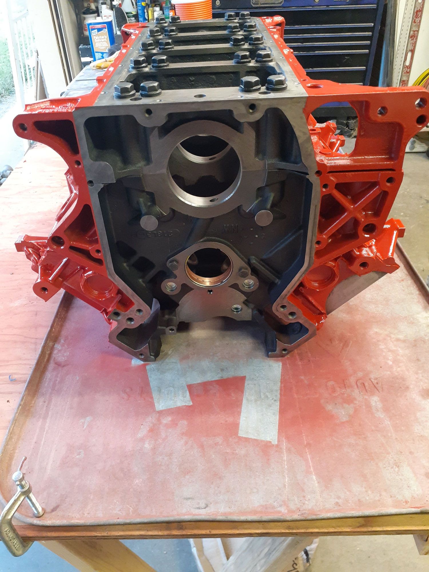

Well, she made it home. And now for the fun stuff. B.

A virgin!!! Let the fun begin...

4-bolt mains. I know the 6.7L is cross-bolted with 6 per. Was the 6.4L 4 bolt or 6 bolt?
Bruce, that block looks amazing!

B,
What kind of paint did you use and how did you cure it?

LindenBruce's Avatar
LindenBruce
Joined: Dec 2005
Posts: 972
Likes: 224
From: Linden, Ca.
Thanks guys can't wait to get my trucking running again in the next few weeks.
The paint is VHT Ford Red, the closest I could find to International red.
I believe the 6.4L has the same main girdle system as the 6.0L, as the 6.4L is a bored out 6.0L.
My major problems started at 190k late last summer. B.
