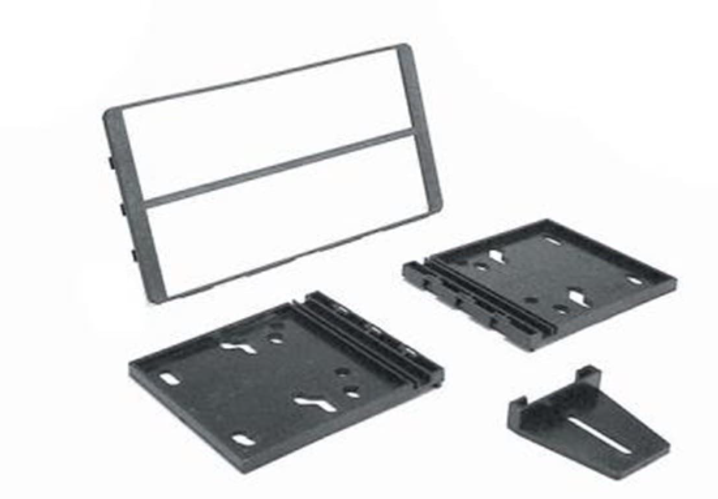

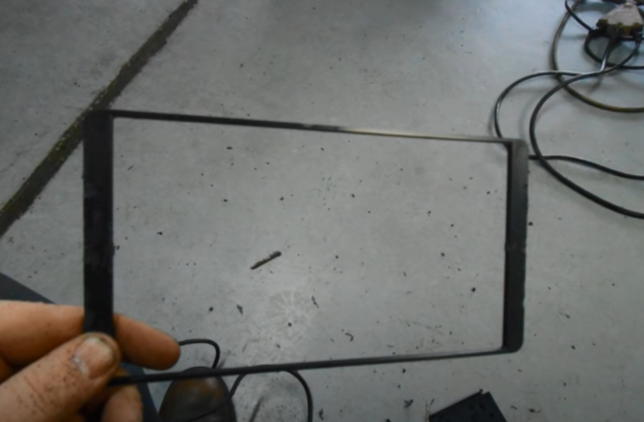

Here's a video showing a guy installing a double din unit in the dash of an '02. He used the Scosche FD1330B install kit for the trim piece, side brackets, and, I think, the center rail guide to support the back of the unit.
The meat of the install is towards the end of the video:
Maybe we can do better, but this helped me visualize what we're talking about. A few still shots from the video:

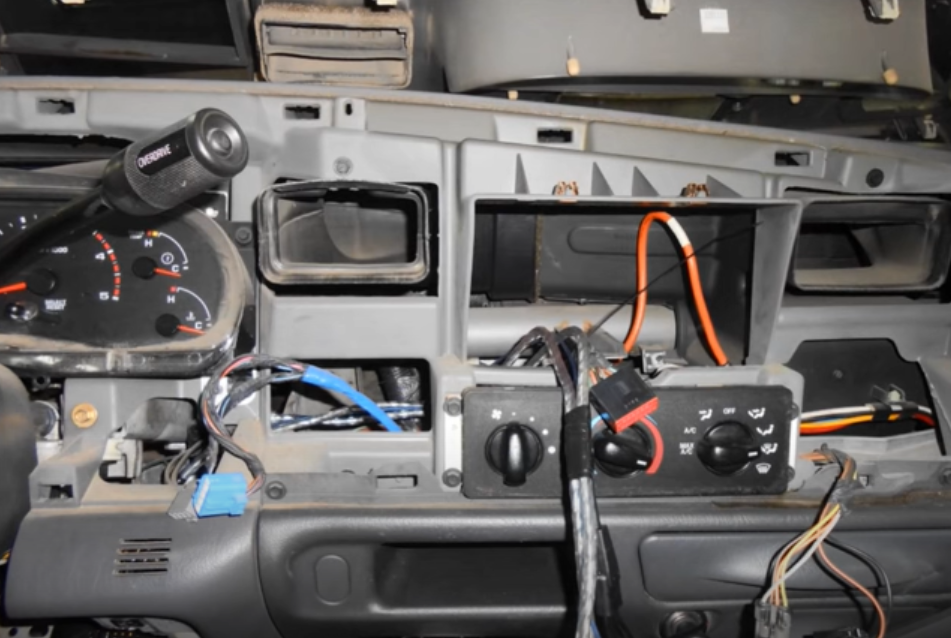

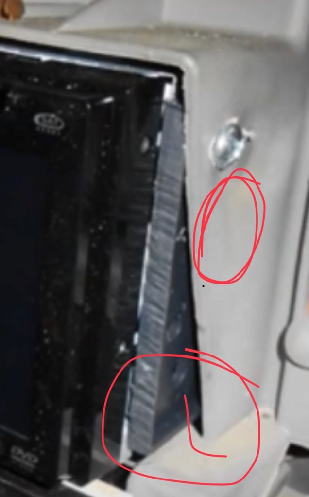

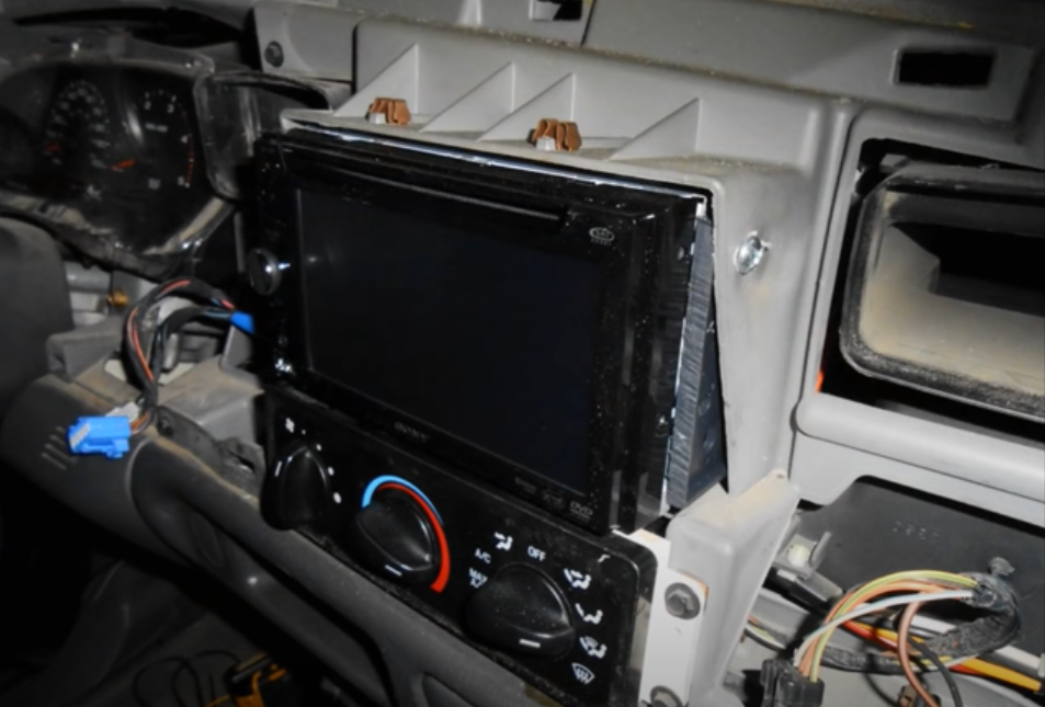

I previously made a small ‘L’ bracket to go where the lower circle is. I used a (#10 screw?? And nuts) through the plastic near upper circle here into a pre-tapped hole in the headunit.

Jason, thanks for providing us with a visual idea of your method of installing a head unit in these trucks. Jeff, Rob and you have revived my enthusiasm for working on this project soon.

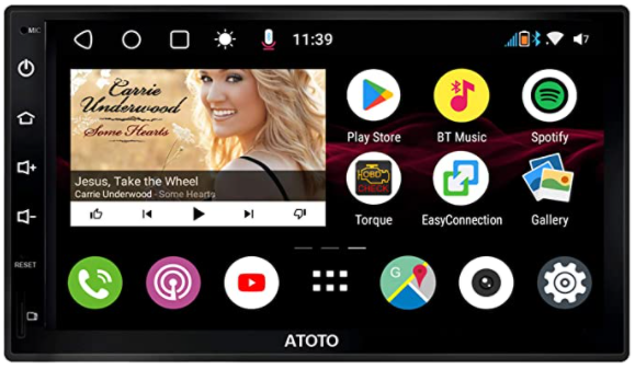

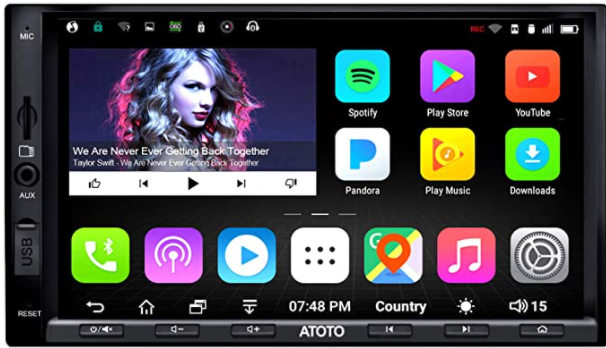

The S8 Premium has larger hard buttons on the left side of the unit, and sacrifices the front USB and Aux In jack. The A6 Pro has the hard buttons along the bottom, and these are smaller.
A6 Pro Front view:
S8 Premium front view:

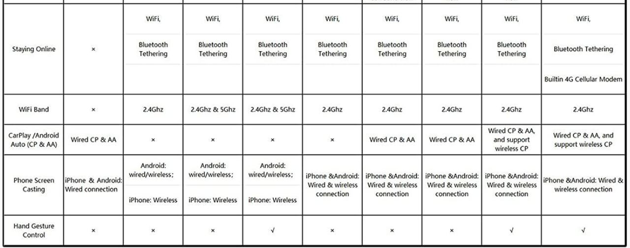

Adding to what Sous already has here in his excellent comparison chart is the chart from ATOTO for all of these models.
