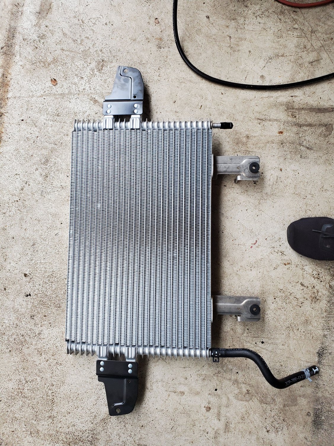

Started to get some work done this afternoon.
I got the Derale T stat hung, and then realized I had the big barb the wrong way. I swear I'm dyslexic... Main reason for a trans t stat is due to my daily commute only bringing the trans temp up to 130 at best, and my E4OD is very sluggish until the temp gets up to 100 degrees or so. I went with the 1/2" NPT version that @Colorado350 used awhile back.
Next up is installing these 3/8's 4R100 lines, and the 26 row 6.0 cooler. Should be pretty straight forward install, I'll have to make sure to get a comparison shot between my 30k tru cool and this 6.0 cooler. The 6.0 cooler is roughly half an inch thicker than the tru cool unit.

That is it in the last picture. Sadly I will be removing it this morning. On my way to work yesterday and home, my fluid barely hit 130. This T stat cracks open at 180, so my cooler will never get used. I reached up and grabbed the cooler when I got home and it was ice cold, no fluid ran through it.
I still need to make lower mounts for the cooler as well.

Its plumbed into the radiator, and then to the 6.0 cooler. The couple days I've driven it, it looks to be about 25 degrees cooler on my commute ending up around 105 or 110 when I get home or two work.

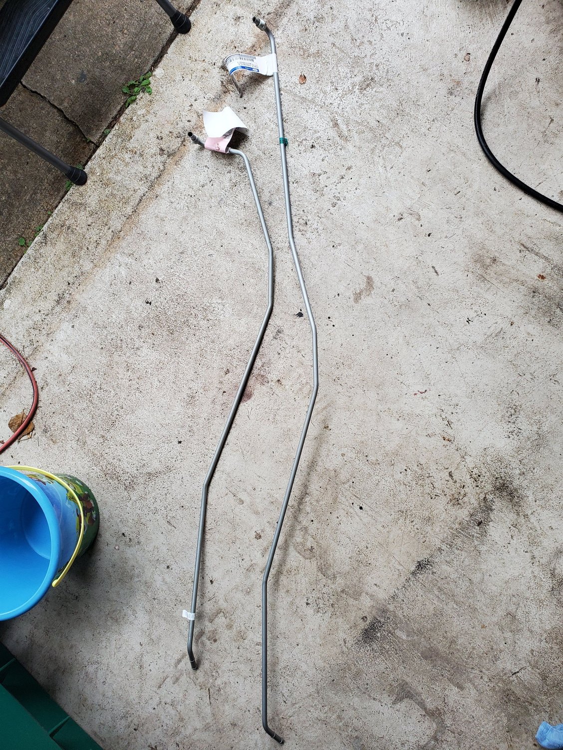

@Khan are these the same part numbers you used for your new transmission cooler hard lines?
F81Z-7A031-CE
F81Z-7A030-CA
