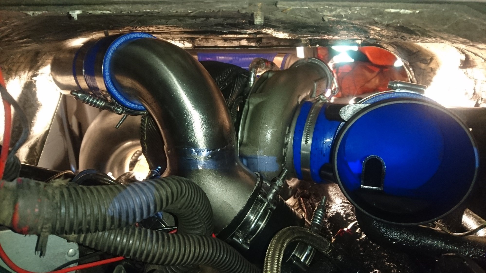

4" 90deg elbow to stock CCV
Extended with piece of stock downpipe
Me too wanted to align the turbo for stock intake and stockish downpipe..😉

Im still in awe of how slick that set up is. I'm also very jealous of the doghouse on the vans
