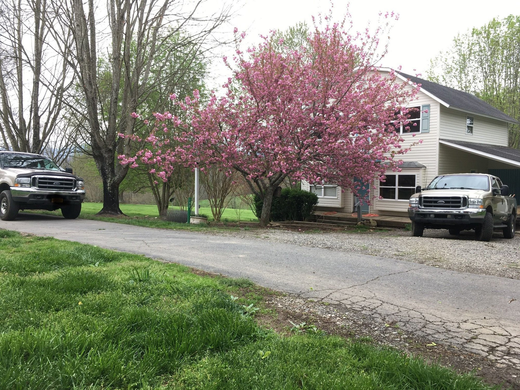

Yep. ‘02-04 lenses (Eagle Eyes brand is fine), relay harness from www.rallylights.com - just call them, awesome customer service!!) and HELLA 100/80 watt bulbs. About $250 for everything. Installs easily in about an hour.
This makes your 2000 go from DANGEROUS to drive at night to pleasurable. I’ve put this combo in literally dozens of trucks. Everyone loves it. If you WANT more light, add some driving lights. (I like to put them on a 3-position switch / ON/OFF/ON w/high beams.)
DOES NOT blind other drivers like drop-in LED/HID bulbs do.
Here’s a couple I’ve done recently.

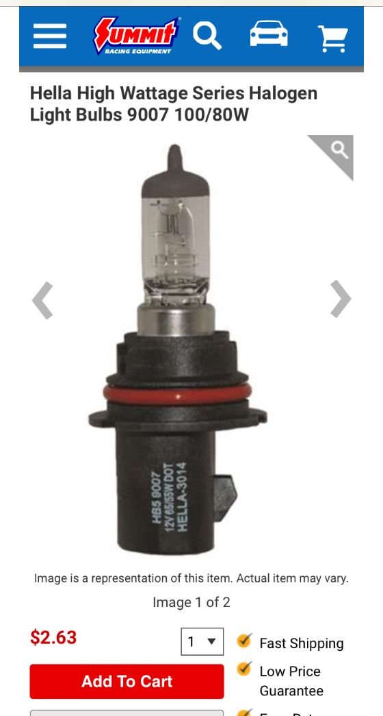

I have not seen a drop-in LED bulb that could perform as well as the halogen bulb I recommend. Some that went in the trash were not ‘cheap’. If they had decent light, they were OBNOXIOUS to other drivers. Still no comparison to high beam output of good halogens.
The HELLA bulbs are very economical AND do not annoy other drivers at all.
https://www.summitracing.com/parts/hla-900710080w
