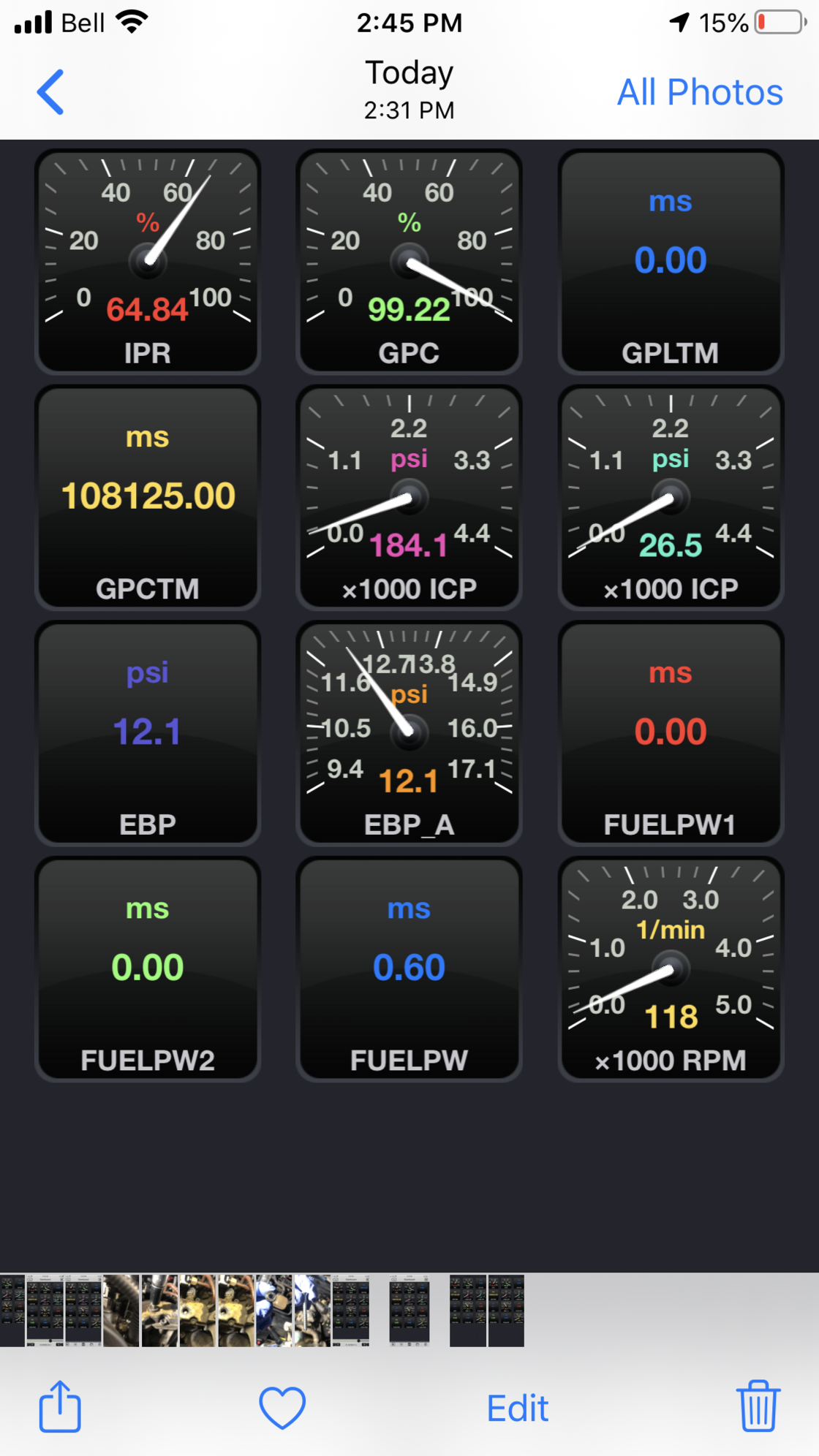

crap. wouldn’t start
pic below is when key turns on and pic below that is when cranking.
yes icp pressure was building. The first gage showed about 186 consistently and the second gage spiked to that level a few times.
gave it 3 or 4 runs of about 15 secs but battery’s need more charging.
I will do buzz test later when battery’s have chance to recharge

No, they do not seem OK... IPR should NOT be 65% when trying to start the engine. It should be no more than 20% when trying to start the engine.

Maybe, but your readings indicate a HPO (high pressure oil) issue. 500 ICP is minimum for starting and IPR should be near 20%. If you unplugged the ICP, it will default to 725 by the PCM, so the problem is NOT likely the ICP sensor itself.

I would ohm the ipr solenoid off of the truck.
based on my findings when i had mine assembled wrong it resembled a bad solenoid. Im guessing that.
looks back at my screenshot, same ipr percentage and basically same icp.
ok. Strange, IPR was reading 14% and change when 42 pin was not plugged in. IPR should close when starting and open to relieve pressure when running. I guess only way to confirm proper operation is install “known functioning IPR”. Or eliminate other things
