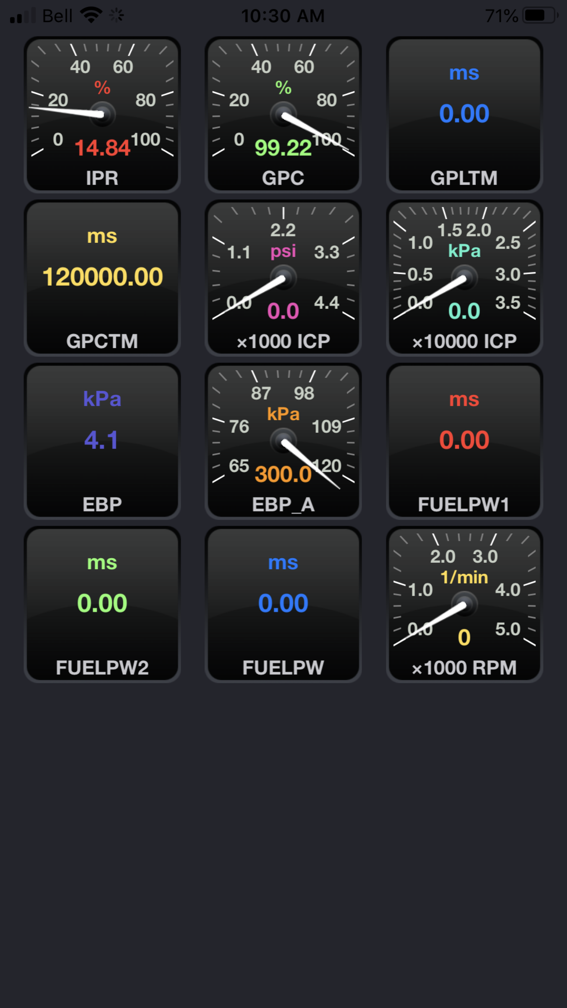

Does the icp not move off zero when cranking? You need 4-500 psi of oil pressure
Your icp is plugged in right?
click on the icp and change to psi, also add the fuel pulse width, fpw and rpm. Screen show while cranking

not sure if I did this properly but these were readings after I tried to start then pushed play after on forscan app. Only cranked for about 5 secs but results did not fluctuate other than the EBP going from 4.1 to 0 up and down.
I'm not familiar with the phone version of Forscan but I think you need to push Play before you start cranking. Try it again and get cranking numbers. If your ICP and IPR numbers turn out okay, the next worry is your high non-cranking EBP number and why your GPCM is reporting zero current to the glowplugs. Has the GPCM been changed at all?

He's in Canada. PSI doesn't compute. I agree with your observation about ICP though. I also wonder why EBP is reading so high without cranking.

I have dashboard set up on forscan lite.
when I push play, it brings up the exact same readings every time.
I even unplugged the EBPV plug and it did. It change the 300 plus reading.
when I attempt a start, the dashboard doesn’t change at all.
I must be doing something wrong. Anyone familiar with forscan lite with iPhone ?

I'll take a video of what the numbers should look like while cranking for you. It will be the PC version of Forscan though.

I even unplugged the ebpv plug and the readings did not change
I push play and turn key to start position or attempt a start and the readings do not change.

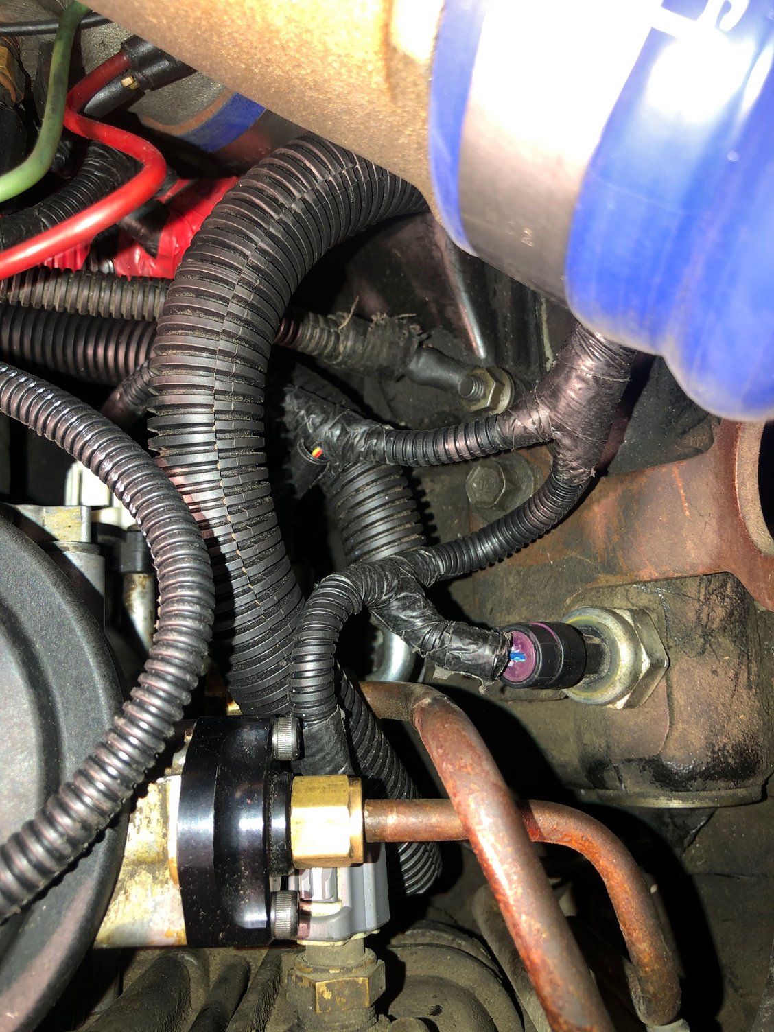

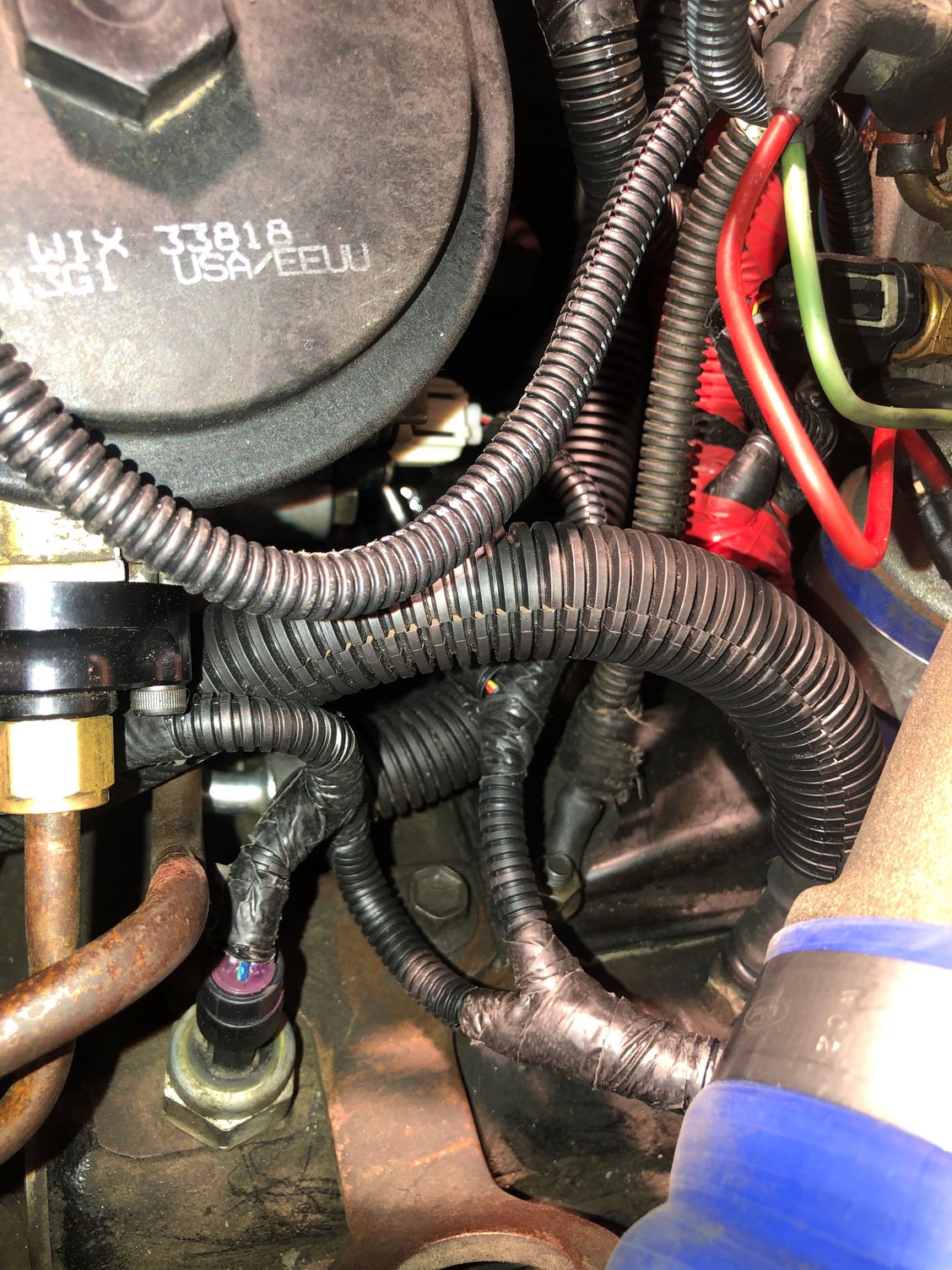

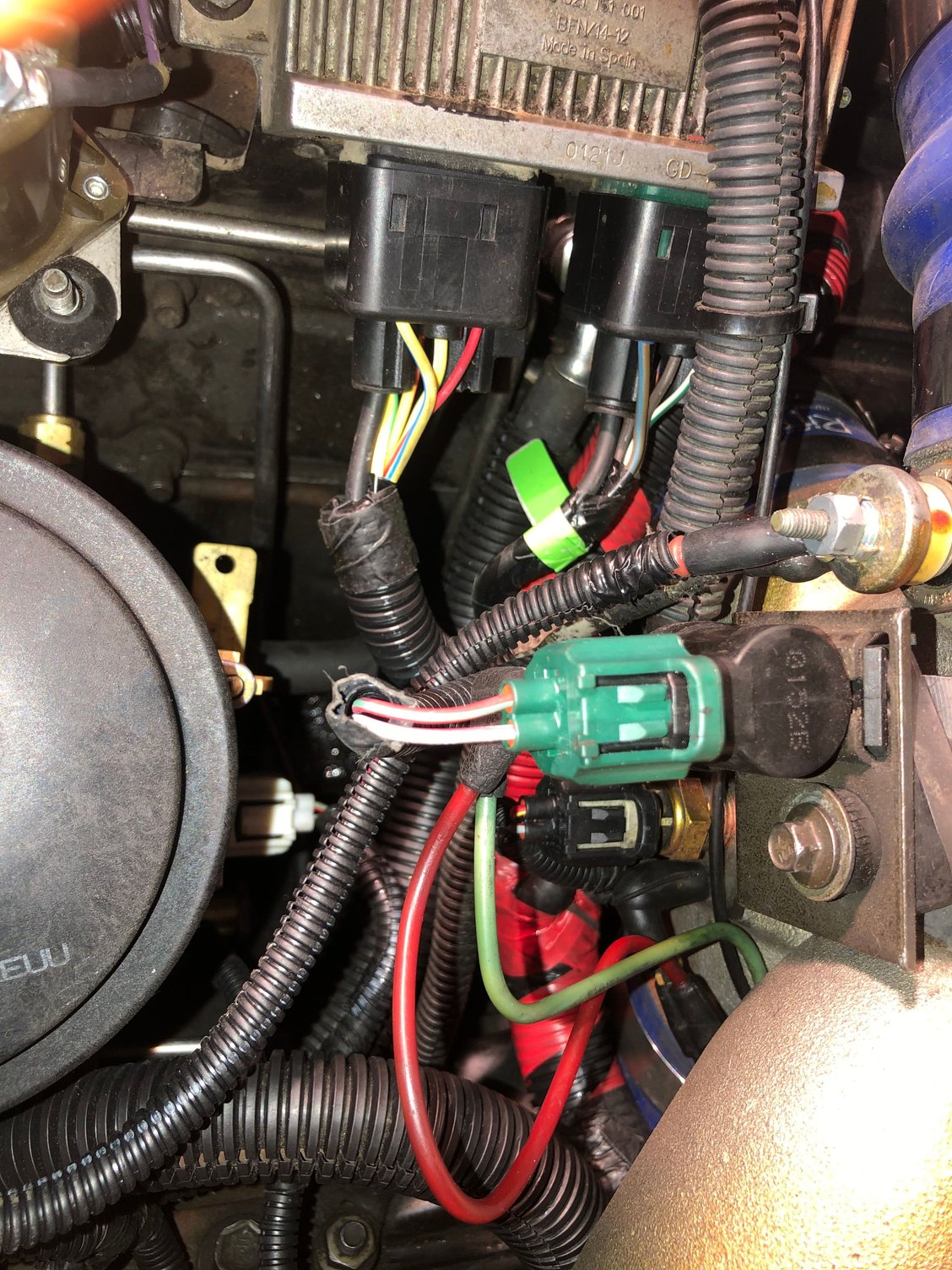

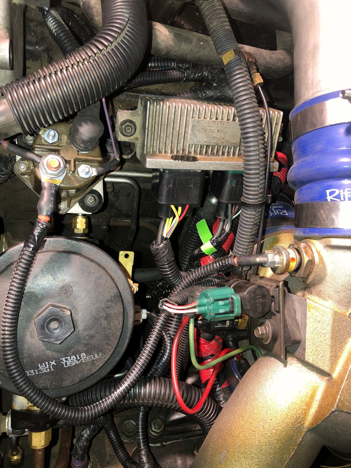

have you checked the 42 pin harness to make sure its connected? Based on the codes and what im seeing here i suspect the harness you replaced is not making a connection at the 42 pin connector on valve cover.
Have you done a buzz test ? Seems like nothing is connected if in fact you had hit play in that last screenshot
You can do a buzz test in the app you have there
Old Mar 5, 2020 | 11:50 AM

i Unplugged IPR and the readings didn’t change. Something up with my forscan lite connection but says it’s connected.

check the connection at your 42 pin, did you have that apart when you replaced the harness? @Mod7.3
