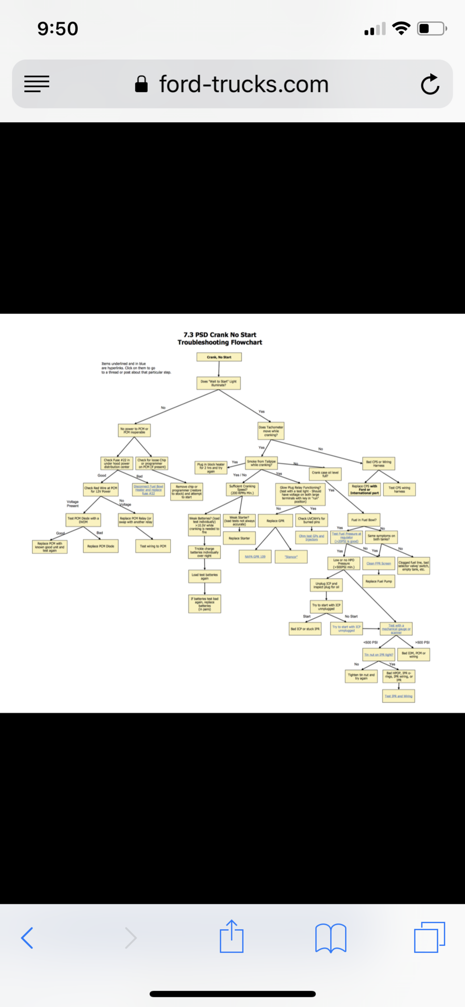

If there is smoke out tailpipe your getting fuel and glowplugs could be the issue
download this picture so you can zoom in
thanks for this. I will start working thru I replaced the glow plugs with ford/motor craft along with the valve cover gasket so they should be fine No/minimal smoke from exhaust as I crank it

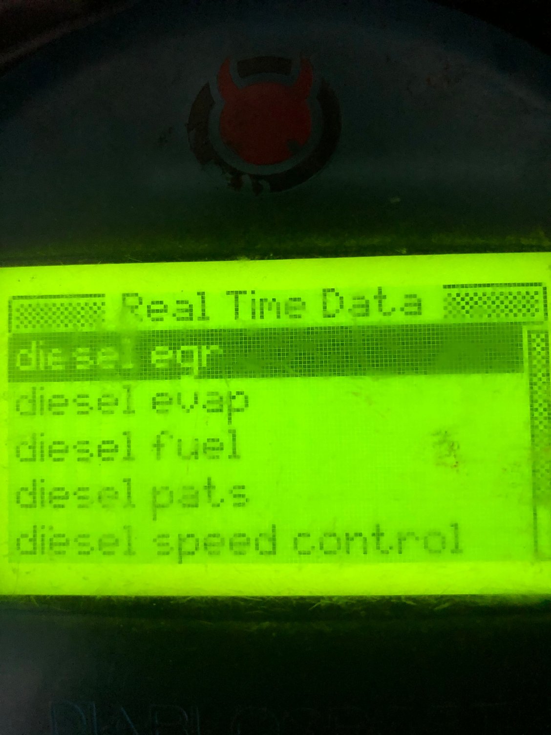

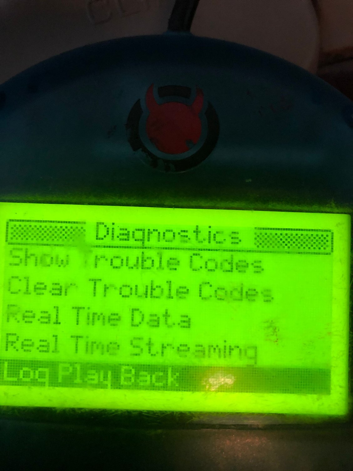

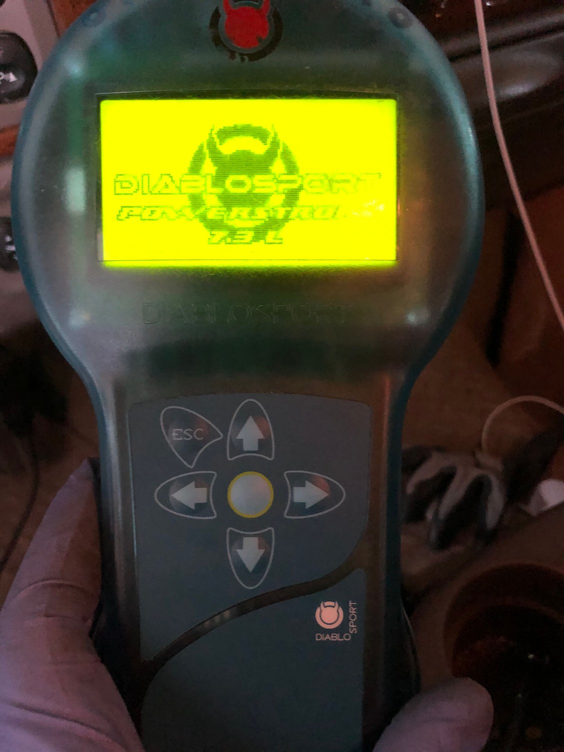

thanks. That’s a good idea as I plan on keeping the excursions and doing more work to it. Will probably do both
i have an older diabl sport tuner that is specific to 7.3 Powerstroke, and has diagnostic options as well as real time data, streaming and log playback. options, but when I pick egr in streaming, it says not compatible with vehicle
