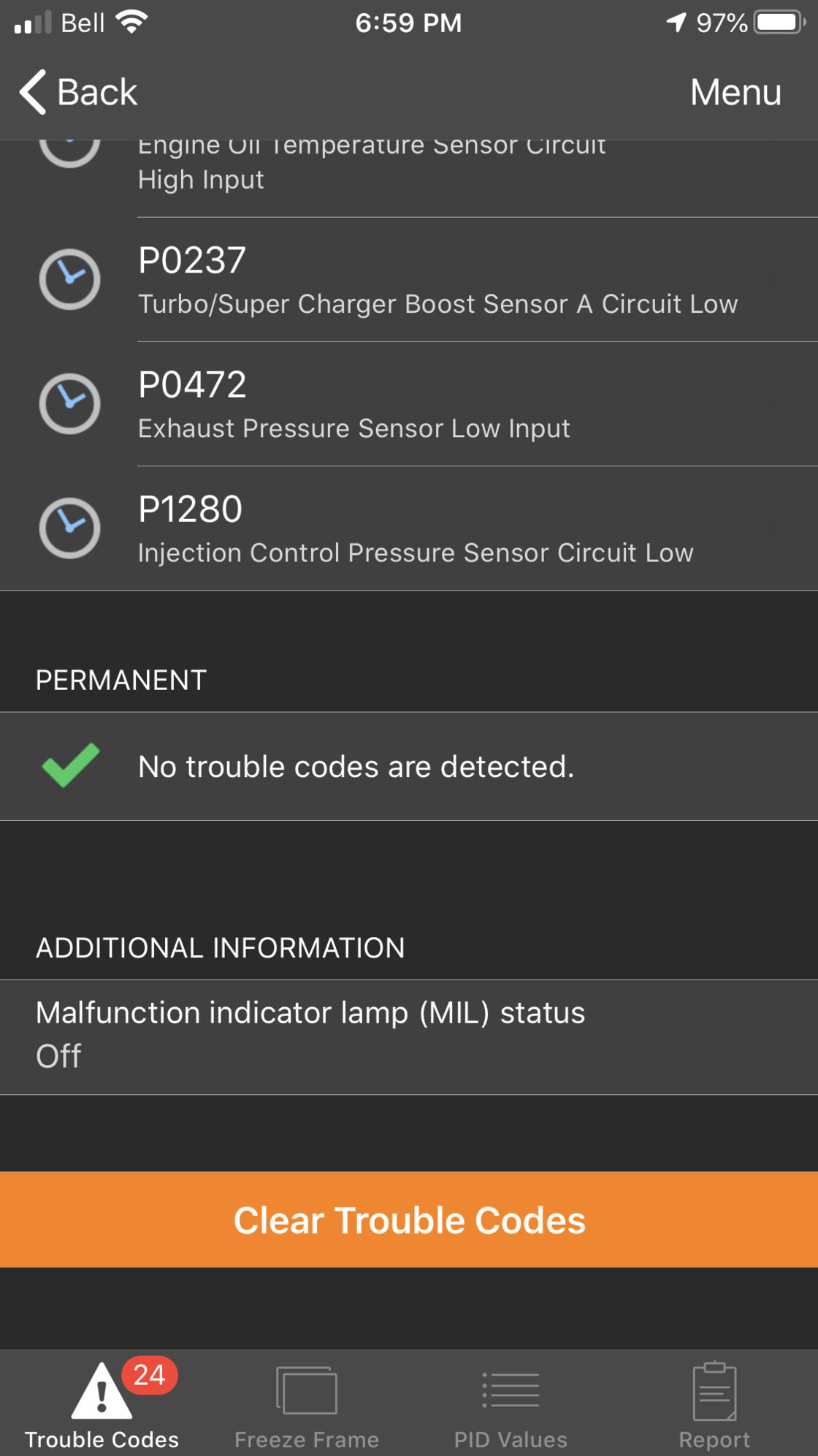

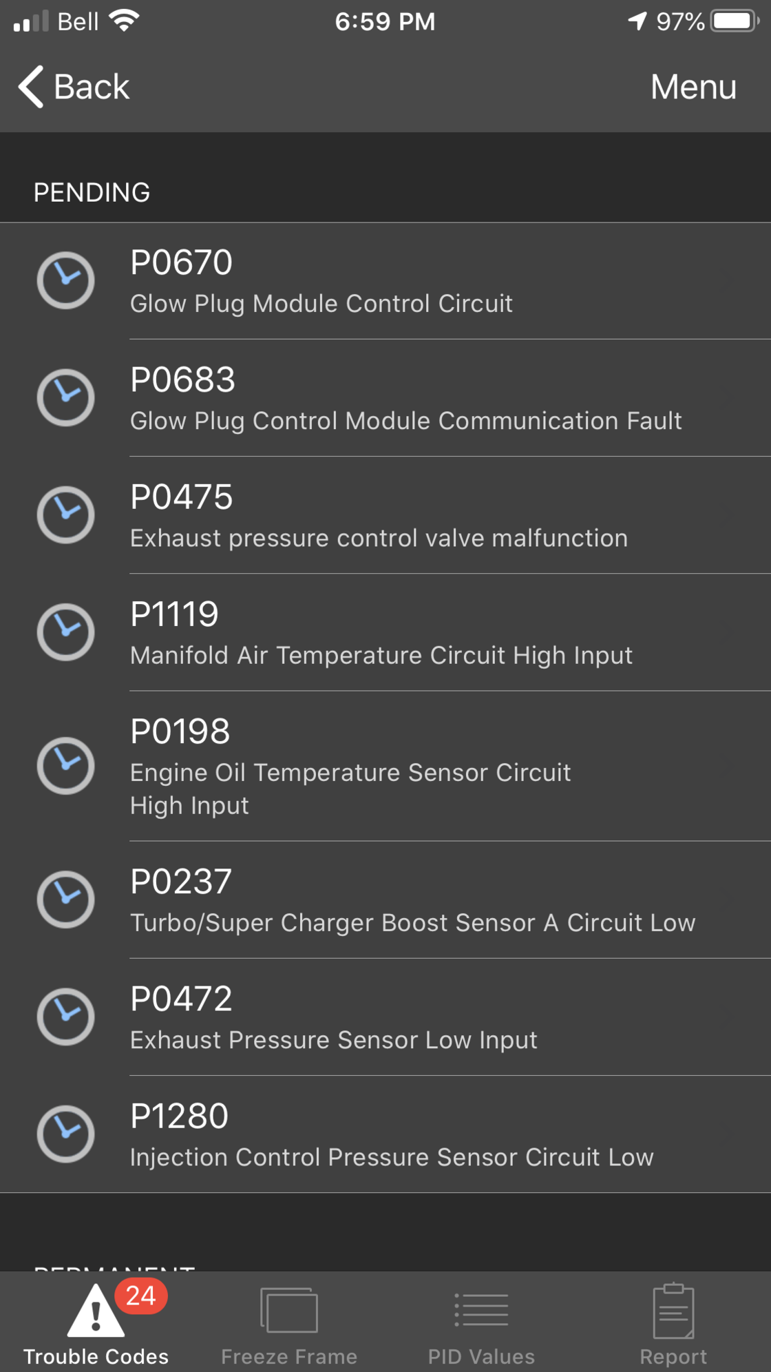

Obd link hooked up.
Hey guys. Have the forscan app and obd link hooked up to iPhone.
Added “all” piddling or are there just certain ones that are relevant to nonstart issue?
attempt start and pids will display and save info ?

I'll have to go back and refamiliarize myself with your symptoms. In the meantime, clear codes then monitor ICP and IPR DC while cranking maybe?
ok. But can’t find the IPR or icp Monitors. The example above shows the forscan lite app. I have both the obd link and the forscan viewer.

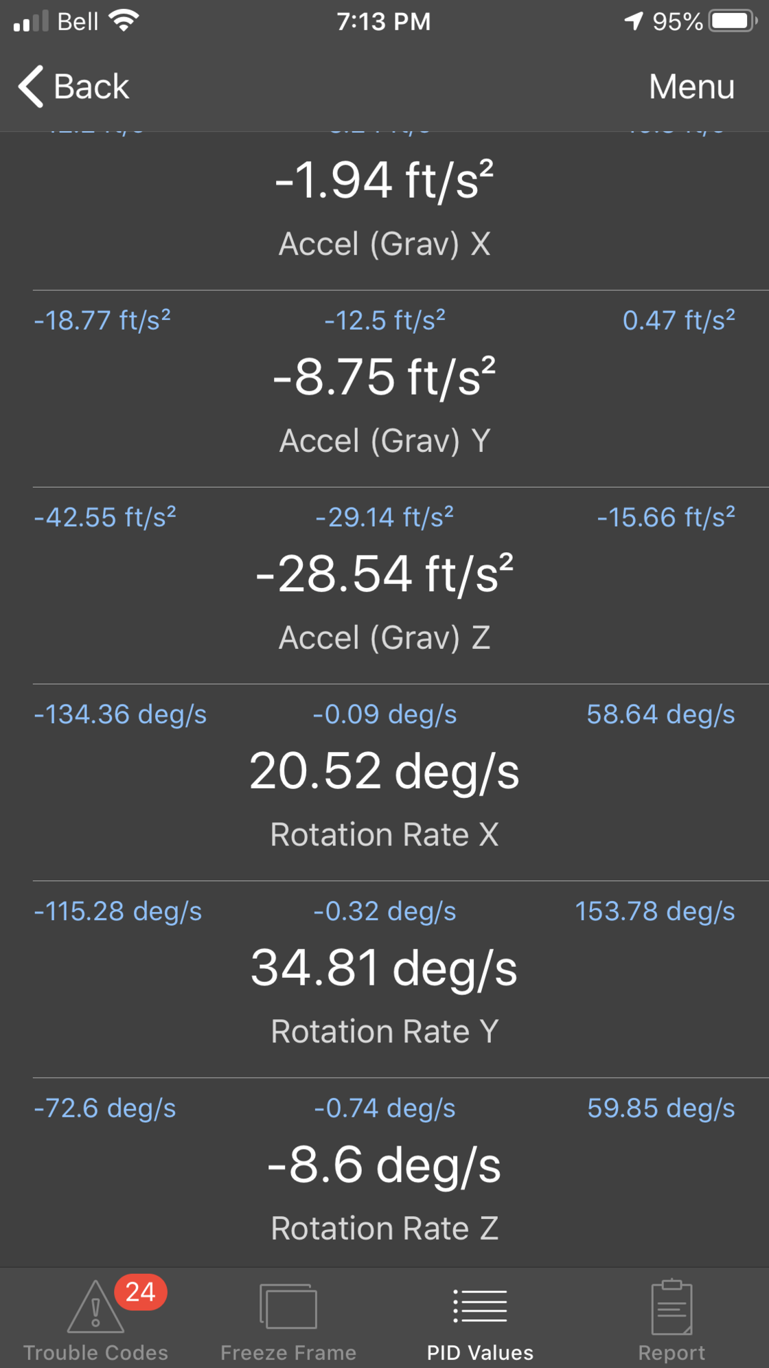

Old Mar 3, 2020 | 11:55 PM
  #75
Mod7.3's Avatar
Mod7.3
Joined: Aug 2019
Posts: 135
not sure if I did this properly but these were readings after I tried to start then pushed play after on forscan app. Only cranked for about 5 secs but results did not fluctuate other than the EBP going from 4.1 to 0 up and down.
This is without start, just turn key on. In table format
