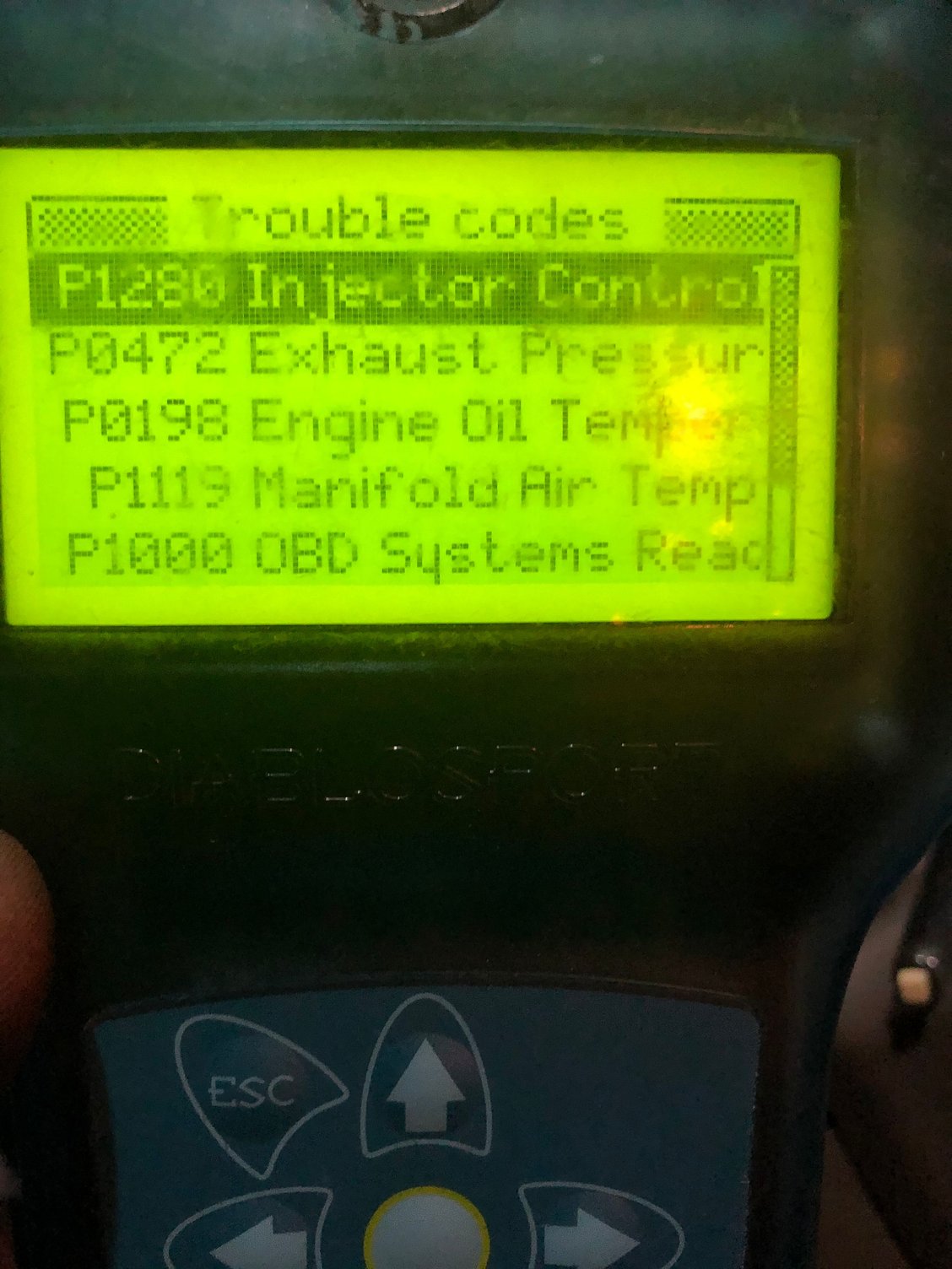

Hey all, looking for more guidance on some maintenance gone wrong.
I started with Oil Cooler seals and did a bunch of work in the valley with help from many here.
I put everything back together and it would not start. Two codes, P1000 and 0381. Glow plug lights in cab operated normal.
Did some research and found good description of how glow plug electrical works to fix 0381 and no start. Link below.
Changed out the glow plug relay from new harness I did not install yet.
Aaaanndd?!?!? No start, engine light and multiple codes.
I used a new battery I had on drivers side to start, and passenger side battery was low so maybe that’s a part of it? Only changing out relay caused so many codes, or lopsided battery’s? Something significant I’m missing? Any help would be greatly appreciated.

Cranking it over now. How much cranking can I expect to do after Hpop lines and fuel bowl? Will the low pressure codes disappear once enough pressure is built? Is the IPR code 1280 common after replacing hpop lines, fuel bowl etc. Would a bad IPR prevent a start?

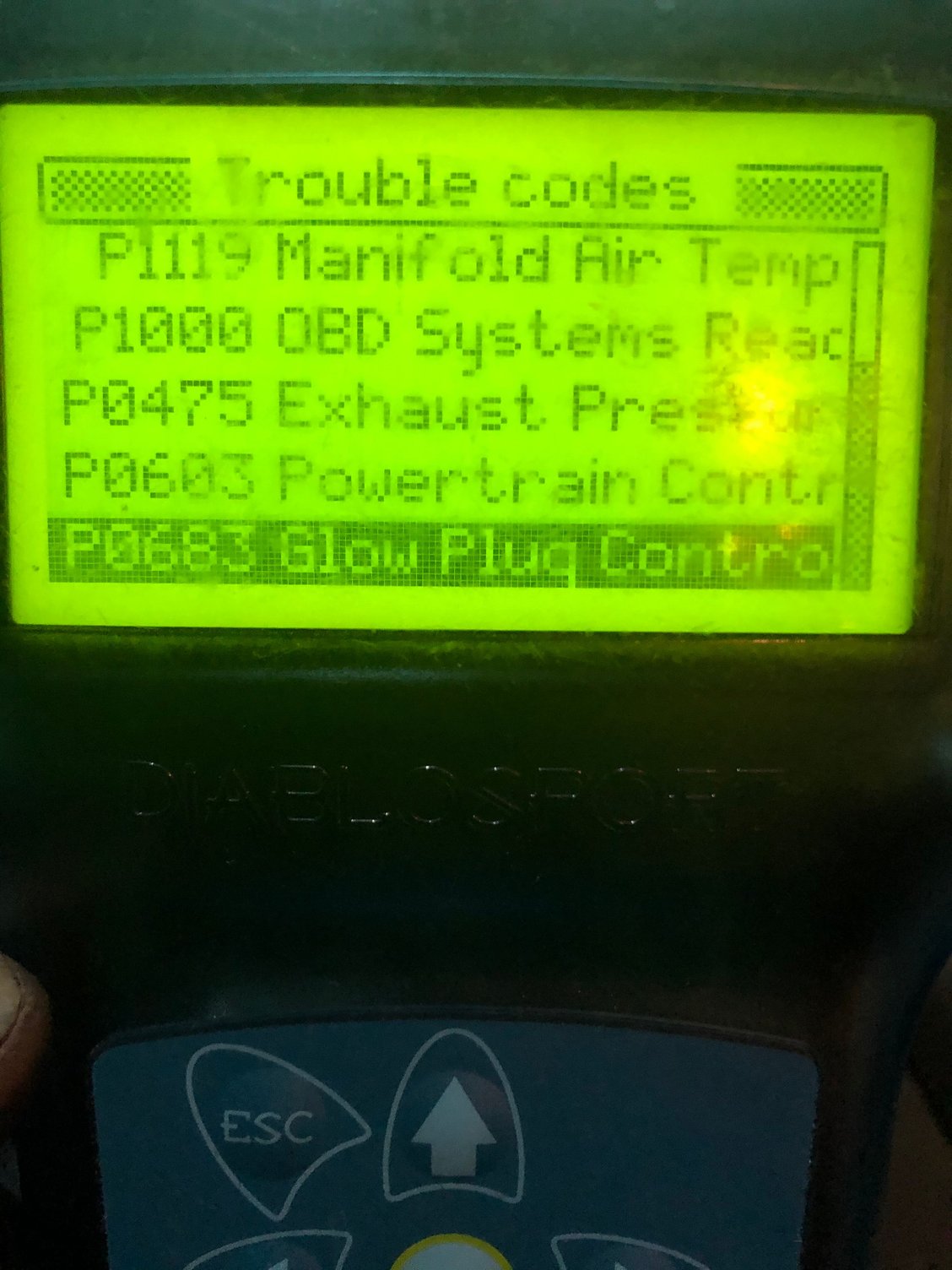

Well crap. Tried to start again and no go. From a few you tube sources it looks like it takes 3 or 4 start times of about 15 seconds each to get the air out of system after replacing hpop lines. I did fuel bowl as wel so might take longer but think I gave it a good run.
I will try pulling the ICP and start to see if that could be it. Then maybe put back on my old GPR just to see. Then maybe take out IPR and make sure insides are ok (already removed solenoid and put back). The maybe install the new main harness. (This seems like good run down of glow plug issue
Seems like I’m getting the clicking and usual pre start sounds
Strange that with my original GPR, I only got two codes when trying to start it, p1000 and 0381 After I put the new GPR in I got a bunch of codes. I did mess with the harness a bit but hard to imagine I did that much.
With the key on, I was not getting power from the big bolt on the GPR (closest to the fuel bowl). And still getting 0603 and 0683 re glow plugs.
I was pretty diligent with each job so don’t think I screwed up IPR insides. (IPR shouldn’t cause a no start anyways). Got a bit impatient near the end and maybe missed something.
