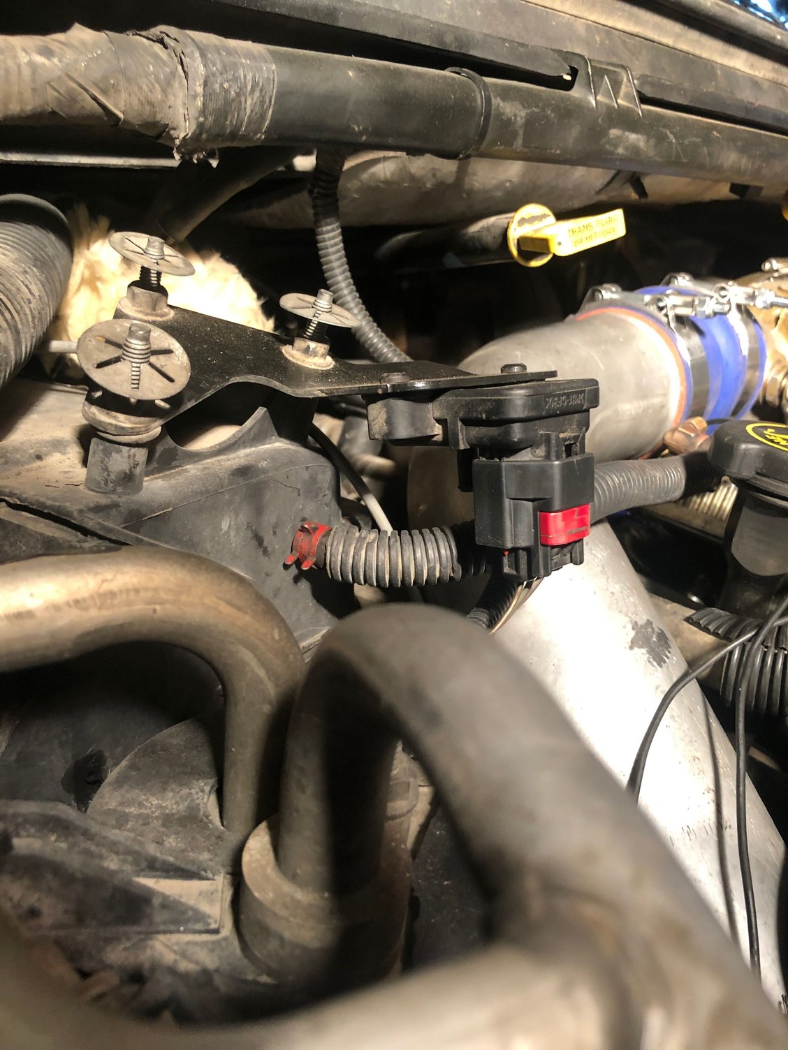

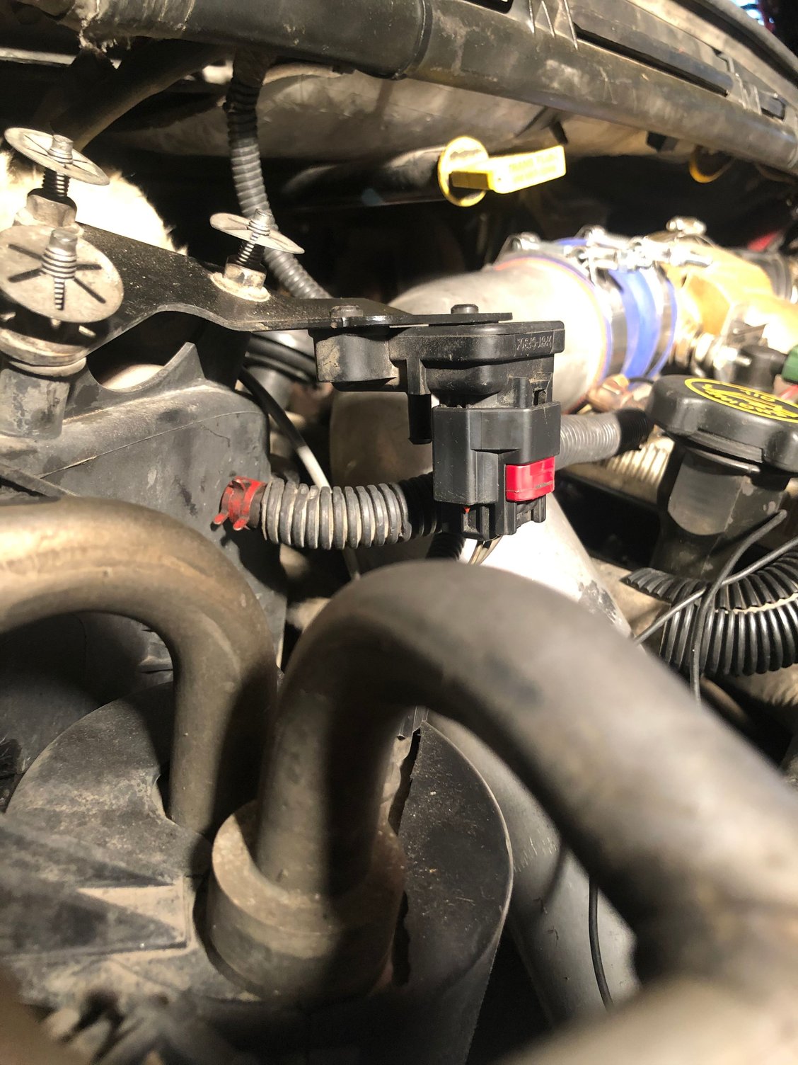

Can someone explain what this is and does?
Old Feb 26, 2020 | 01:40 PM
  #44
FordTruckNoob's Avatar
FordTruckNoob
Joined: Jan 2005
Posts: 13,135
Likes: 4,732
From: Henderson, NV
MAP sensor. It measures what pressure the air going into the engine is at. Stock PCM will defuel and trigger the SES light when this sensor tells it that the air pressure is ~24psi.
  #45
Sous's Avatar
Sous
FTE Leadership Emeritus
Joined: May 2014
Posts: 27,355
Likes: 5,951
From: Lake Hartwell, GA
FTE Emeritus
MAP sensor. Provides Manifold Air Pressure reading to the PCM. Essential part in a healthy truck.
