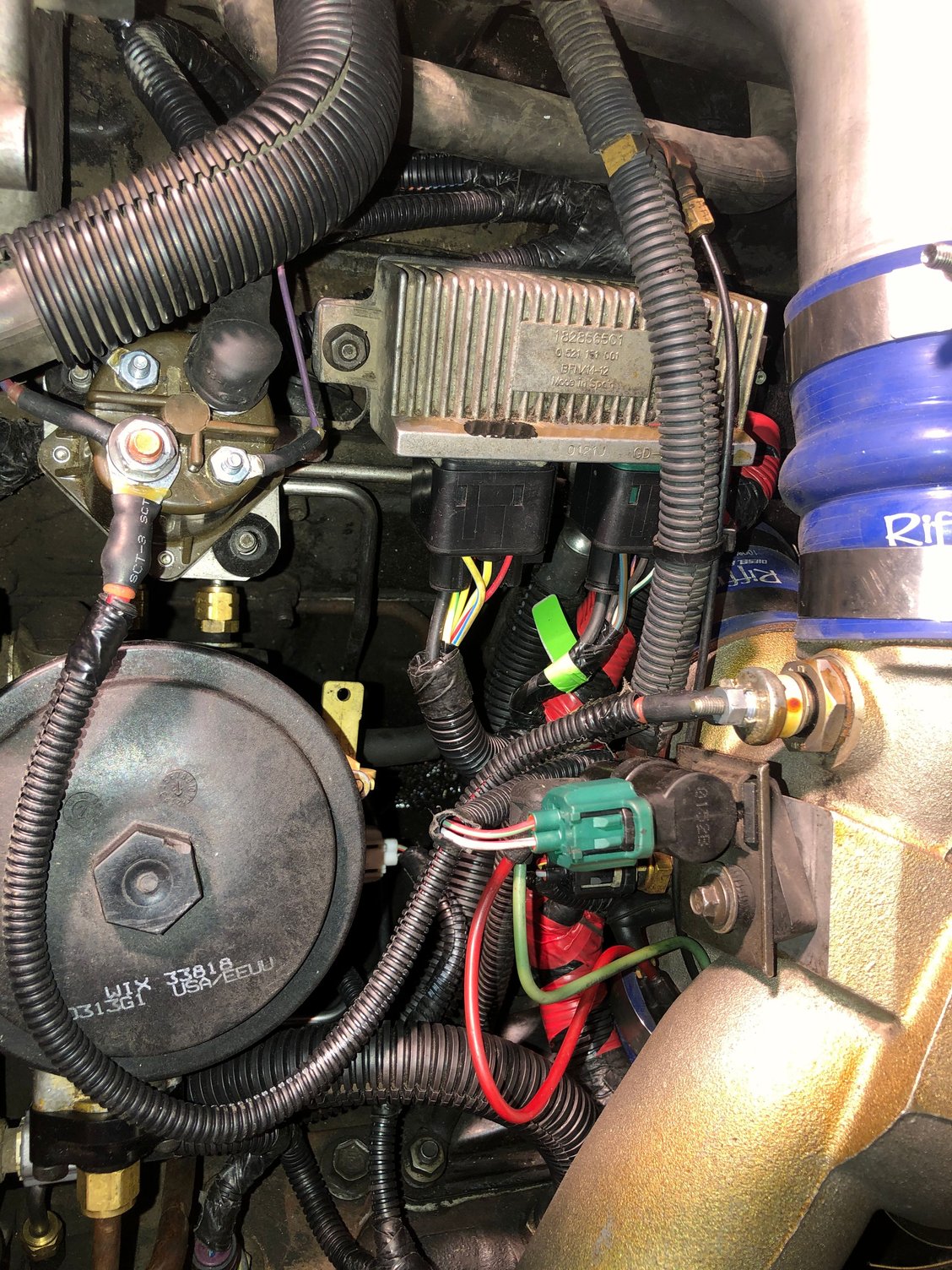

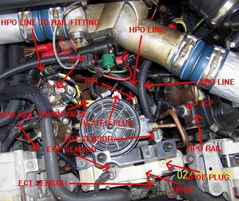

Regarding pic and labels above.. Icp correct. I don’t have a GPR as in pic. I have the silver finned that allows for more detailed glow plug info (required for ex being people hauler instead of truck?).
I replaced the main engine wiring harness so all connections and plugs should be fine. ipr on order.
I mention fuel because it seems like I’ve been getting no smoke at all Just spitballing. I clearly know just enough to be dangerous.

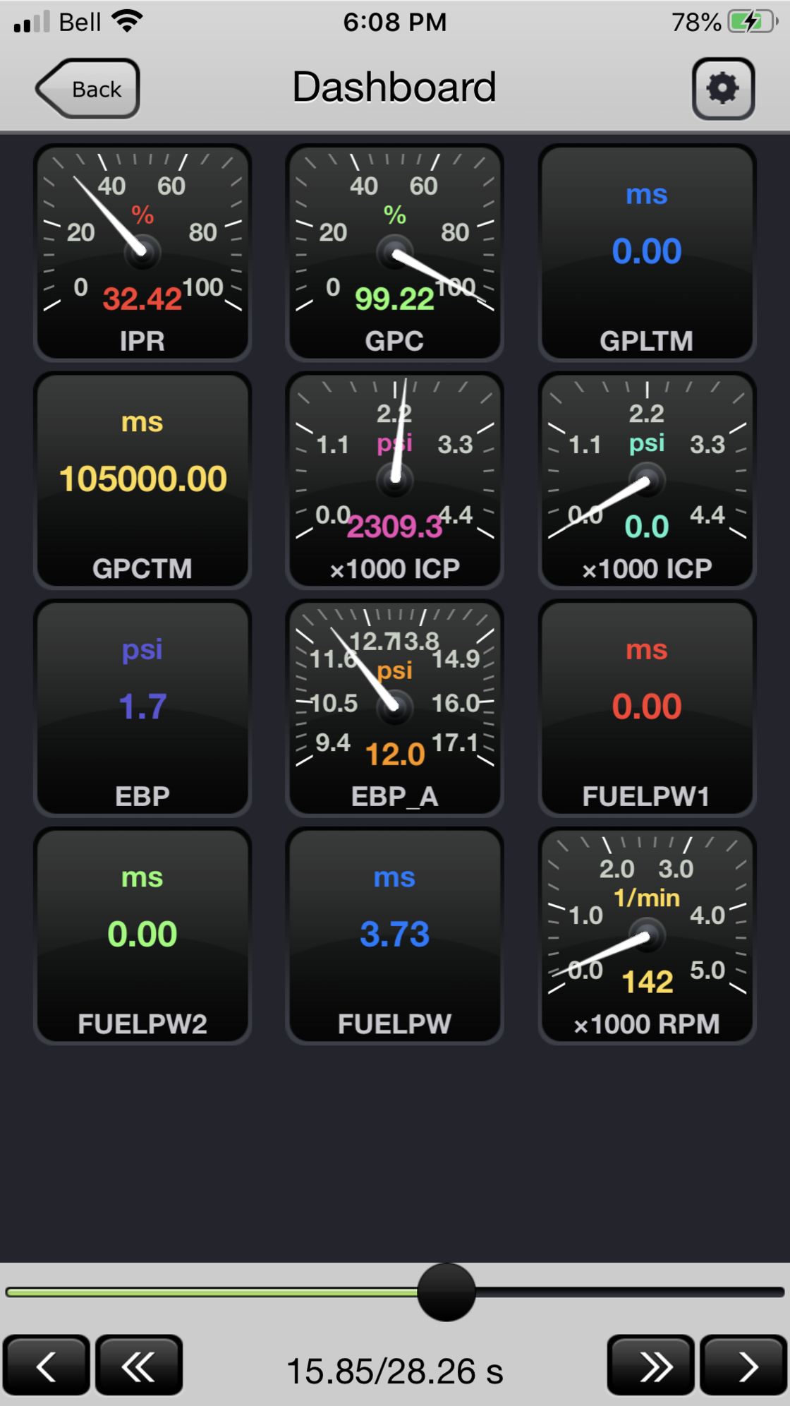

This is forscan reading with icp pulled. Ipr went to 32.42 and icp to 2300.
I then plugged back in icp and IPR back to 64 and icp both were about 180-190. Not sure how to reset forscan to record again so don’t have a pic of second try. Wondering why they have two gauges often? Two icp gauges?
not sure if this sheds any light.

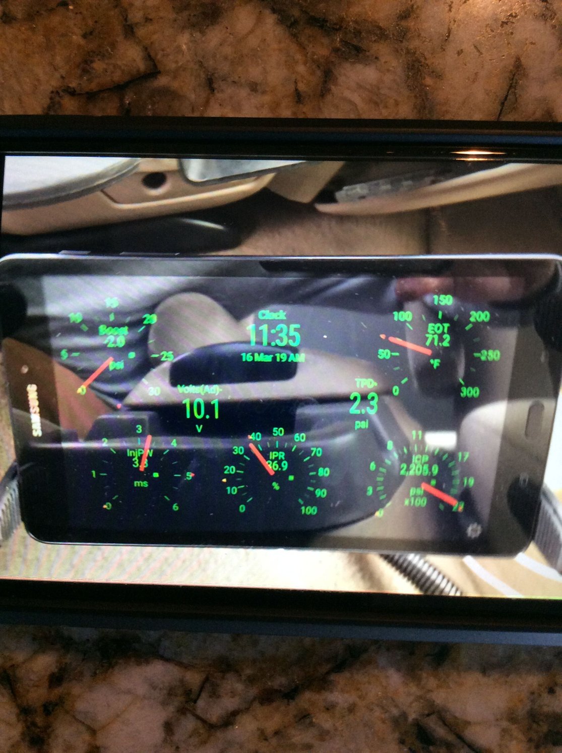

This is a screenshot of my numbers on my truck. This was a “crank but no start” I was having. The engine was cranking for ~5 seconds when this was taken.
i use Torquepro as a monitor so it looks a bit different than your Forscan.
The numbers look similar to yours with your ICP unplugged.
If you unplugged the ICP sensor (pcm then defaults to number) and you got the numbers you say 2300 psi ICP and 32% IPR. I would think the truck would start with those two HPO numbers?
untill the HPO issue is ruled out something else comes to mind I haven’t seen mentioned is PATS. Being an EX is your PATS functioning normally? I have no experience with PATS but have read treads here on FTE of issues.
Last edited by slowsure; Mar 7, 2020 at 07:21 AM. Reason: Linked picture didn’t work
its a good thought as I’ve had that “no start” issue before. It comes with a blinking theft light and I have not had that now. But every time I reconnect my battery’s after I recharge, the alarm (pats I assume) has gone off for a minute or two (which is normal I believe). I don’t think it’s contributing but will keep an eye on it I do have a (now) inactive remote start that I should remove that could be a draw on my battery’s and that issue where the radio and windows are delayed going on, usually at start up
