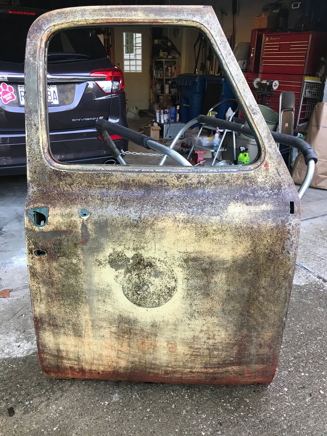

Did a little more CLRing today. What do ya think?
Before
After
Old Aug 8, 2019 | 04:43 PM

It is Kevin, these doors that were on it are pretty shot so I decided to see what CLR could do.

How long did it take you to do that door?
I'm pondering doing this to my truck.

An hour and a half a door probably. Did inside and out of both doors with about a quart of CLR.

BJ,
Good job on the door. I have never used CLR. Those would be good candidates for the electrolysis process also. Just would need a large tank, like a 275 gallon tote with the top cut out.

Saw it on U Tube and since they needed bottoms I thought I’d see what CLR would do. I was pleasantly surprised.

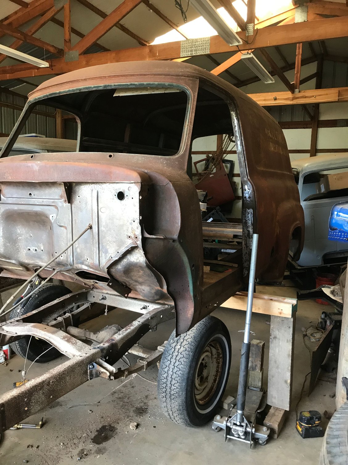

Well life does get in the way sometimes. And the Midwest has been too darn hot to get anything done. But I snuck off today and got a little done on the 53 Panel. I managed to get the body off the chassis, all by my lonesome. I’ll have to re engineer the supports to put it back on but for now Mission Accomplished.

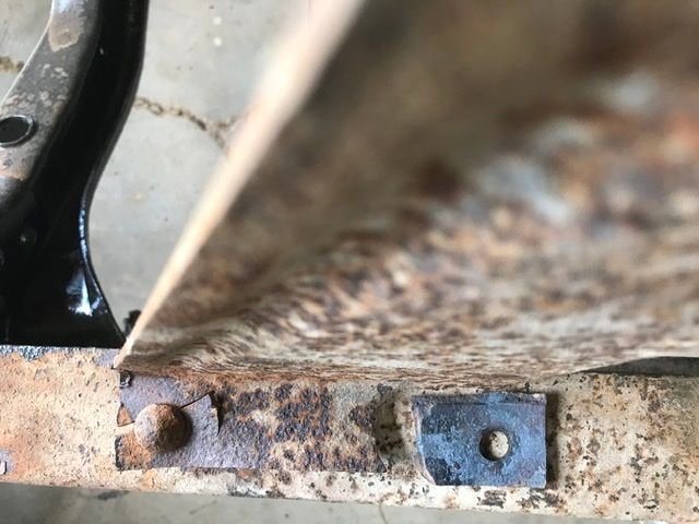

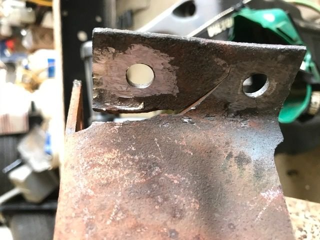

Removed the cracked front cab mounts. Luckily I knew they were cracked and bought a set from Kevin a while back.
Passenger side front cab mount
Same mount different view
Drivers cab mount.

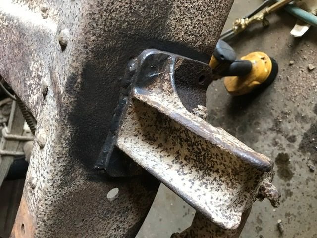

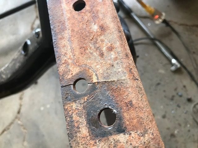

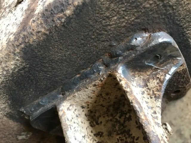

After I got the body off the frame I got a couple more surprises. Frame’s cracked at the Passenger Front cab mount and the PO welded the passenger front spring mount to the frame. It’s fun finding this stuff ain’t it? Think I’ll call it a day.
Cracked Frame
Passenger Side front Spring mount
Welded along the top
Welded down the rear

Lifting a panel body adds a whole new wrinkle in that task. It makes removing a regular cab by yourself look like child's play.
Why in the world would you weld the mount to the frame? I get that he thought he would never need to move it, but still......
Bummer on the frame crack. It's always something for sure.
