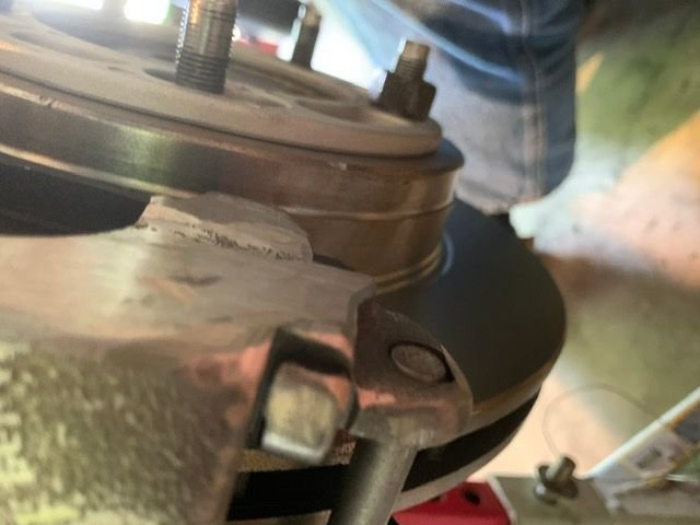

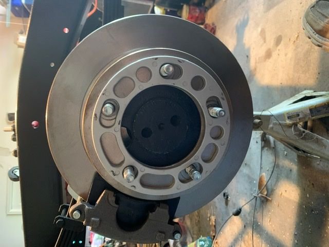

Time keeps a ticking. Well I got the fittings, installed them and bled the brakes! I decided to put on roller wheels instead of the new Wide Whites so they didn’t get marred in transport to the shop and while installing the body back on the frame. BUT when I went to install one of the rollers on the rear end it Hits!

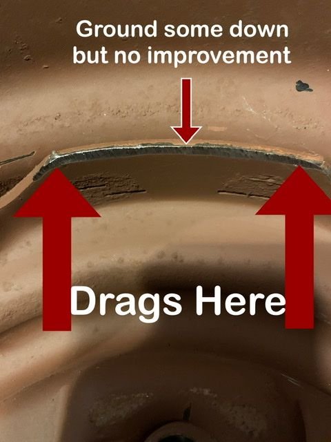

Glad I didn’t opt for the powder coated calipers. After several installs, removals and grinding sessions I couldn’t get the roller wheel to spin freely. So I thought maybe it’s the wheel. I installed one of my Wide Whites and everything cleared.
Feeling like a (dunce) I tried the other side with a Wide White first, it hits, I haven’t returned to grind down the other caliper yet.
Why Oh Why is nothing just straight forward and easy?

Thanks John, I forgot that part. I ordered 1/4” spacers when I first tried the roller wheel. Even with spacers it hit. It’s hitting on the wheel at the edge of the lip that’s riveted.

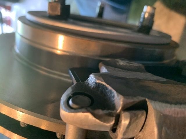

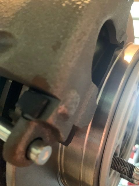

Here’s a picture of the 1/4” spacers and the ground down caliper to get the wheel to clear. I did find out there are two (at least) different length caliper pins too.
Finally no more rubbing!
1/4” spacer thank goodness I installed longer wheel studs.
Couple of grinds but still dragging
Grinding near caliper bolts seems to help
More grinding near caliper bolts
Two differently length caliper bolt lengths. Long ones were a problem.
