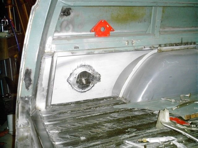

I hooked a timber wide enough to span across and under those ribs for lack of a better name above the magnet and just rapped a chain in the center and lifted with the engine hoist..I like to lift from a high point so there is less chance of rolling..

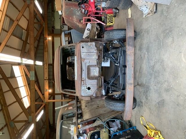

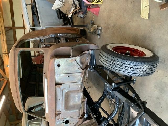

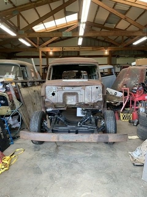

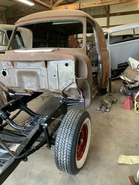

Well it’s back on! Wasn’t pretty not bad for working by myself. Sorry, but I can’t get them to post straight.

Here ya go, BJ!

Looks like an old Ford barn now..

Abe, how’d you do that? I tried twice even flipping the originals to be correct after the FTE Site rotated them And they still came out rotated.

Too many projects John! But I hate to see them waste away in fields and barns.

That bad huh....

I saved them to my tablet then flipped them using the editing feature on my tablet. Then I posted them.
