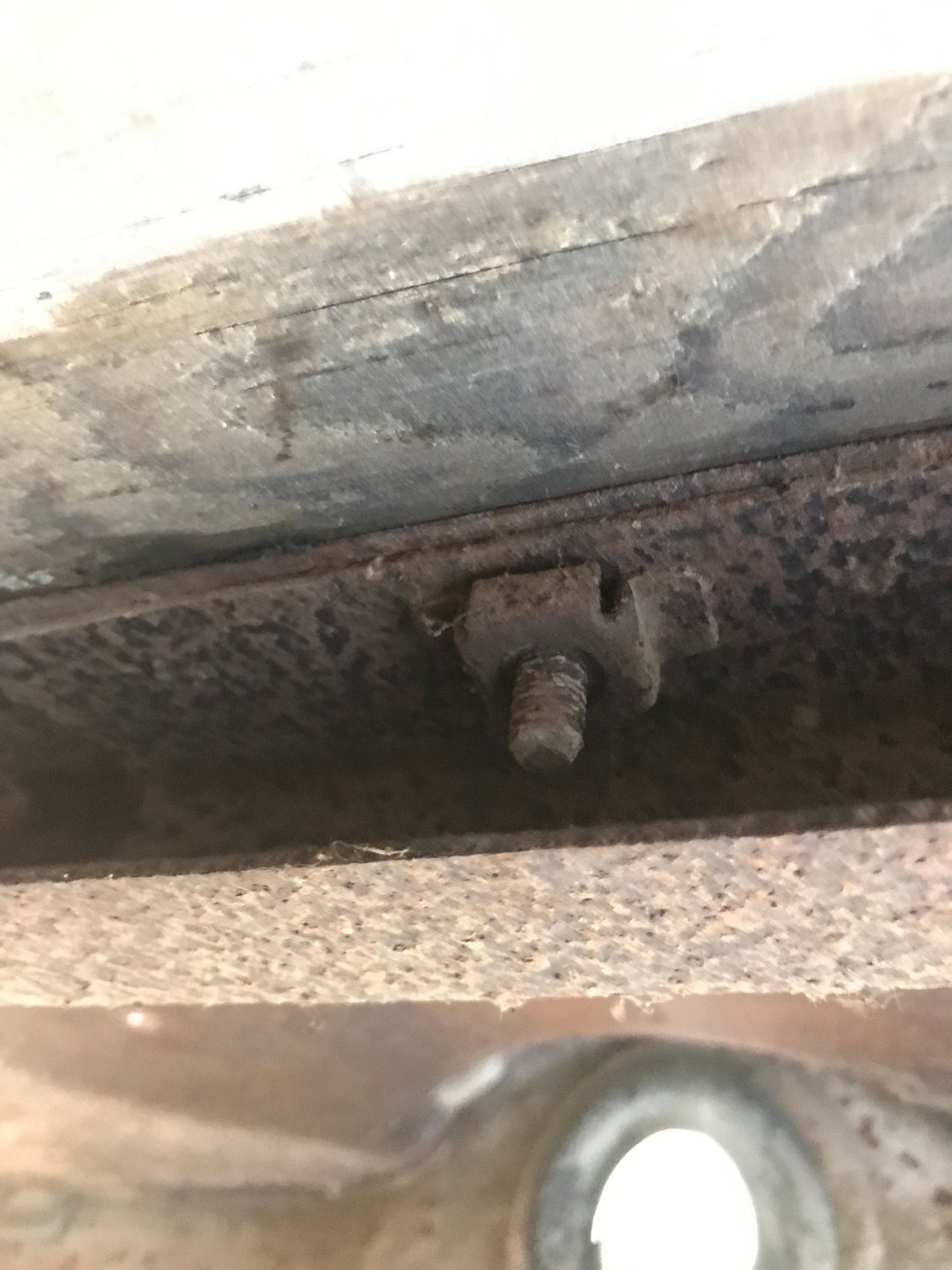

My problem is that these screws screw into something but I can’t figure out if it’s a caged nut or something else. If it’s a caged nut I’m golden if it’s something else I may be in for lots of work.

It's been a very long time since I removed those on my panel but I'm sure if you crawl under the panel you will see if there are caged nuts there. I can't even remember if it's a Phillip's head on those bolts or a square head..can't tell in your picture..

I’m drowning them in rust buster. Even got under the Panel and tried wire brushing the exposed ends. I just didn’t think to look and see how the nuts were mounted.

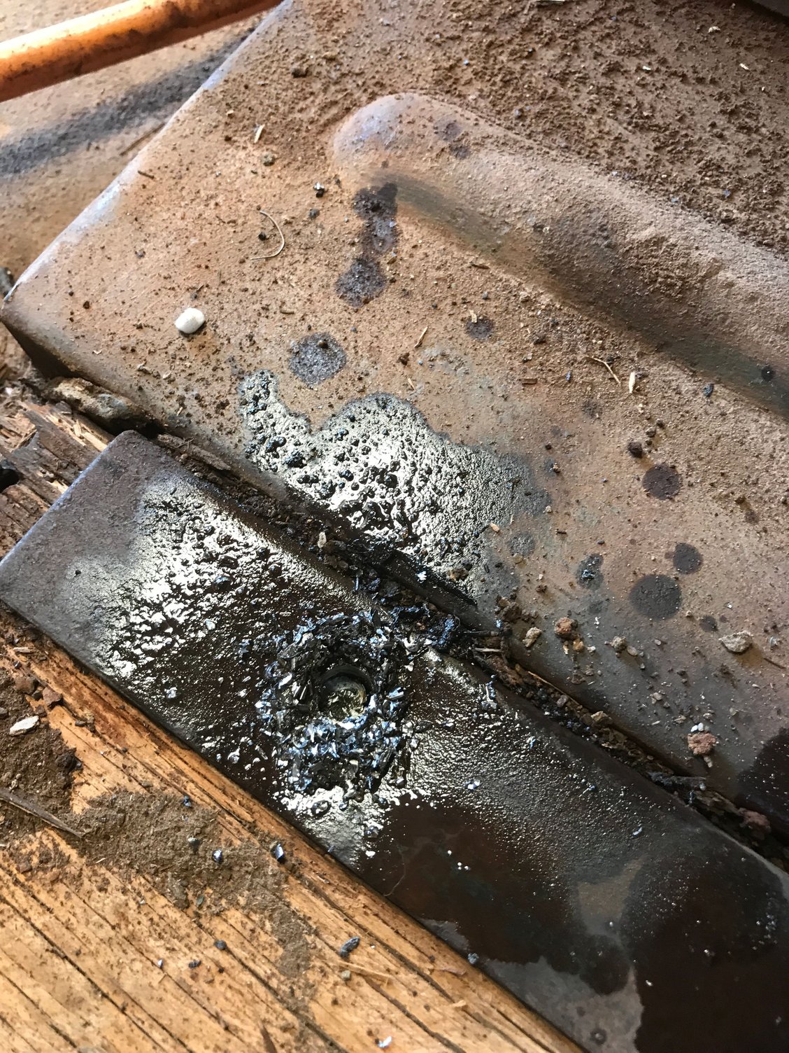

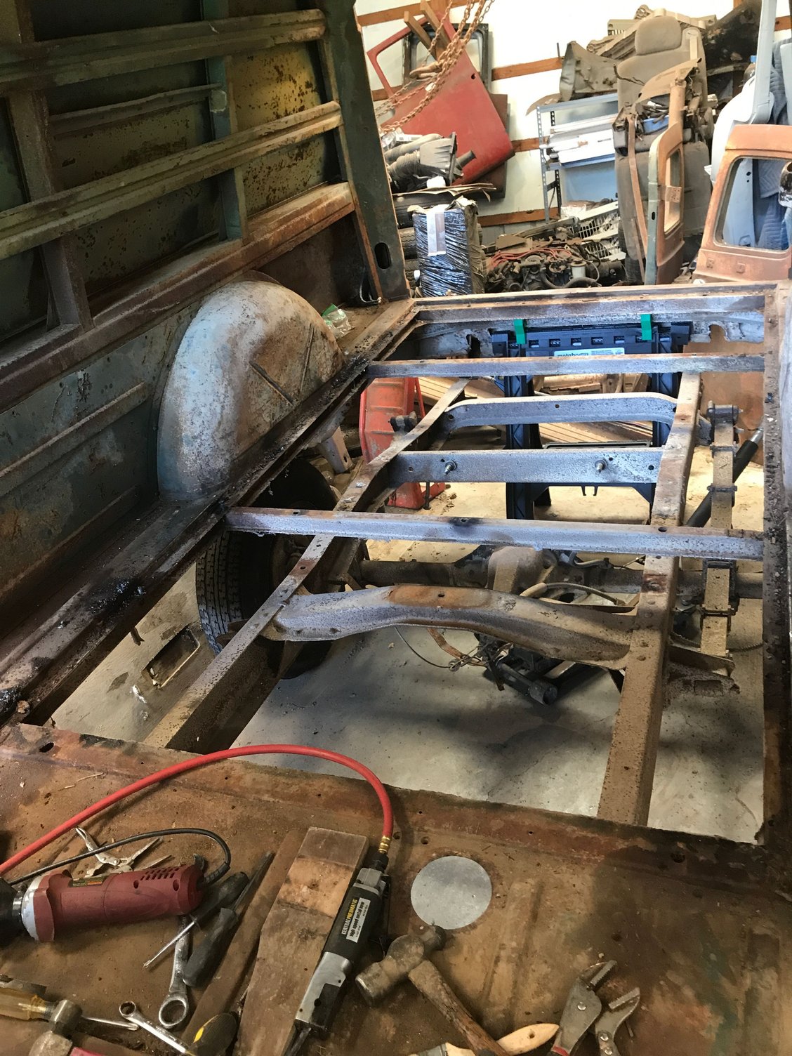

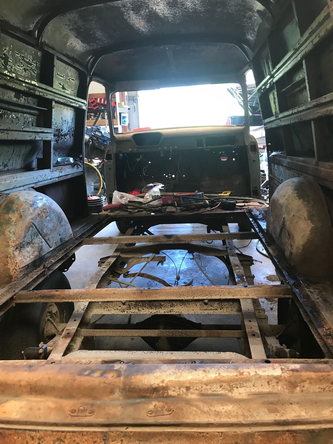

Well let me say a sheet of 3/4 plywood is Heavy, around 68 LBS. But I finally got it out. Most of the side screws I ended up drilling the heads off. Couldn’t get a cutoff wheel close enough to cut them off.
Here’s today’s progress.
Bottom of side nuts
Drilling the heads off
More of the same
Shot from front to back with plywood removed.
Shot from rear to front with plywood removed.
