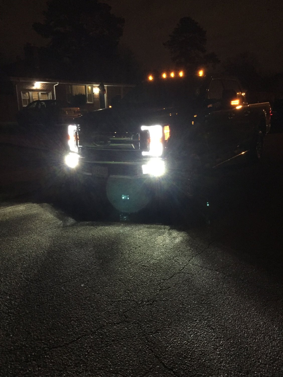

Beam tech's
Took the plunge and bought the beam tech's! So far so good, I really like the light that they put out and they make the truck look great!
