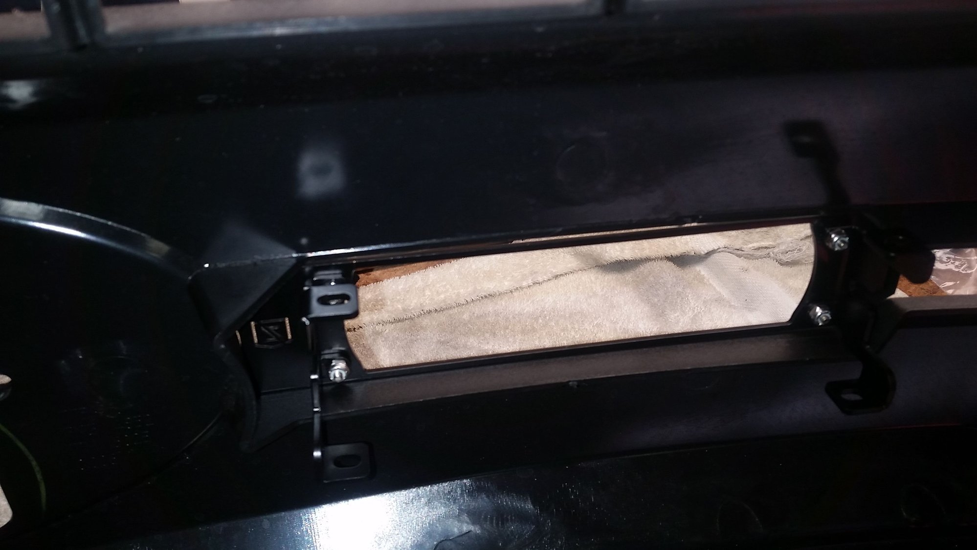

good to hear. how are all the LEDs holding up?I
I
ve been screwing around with the led grille from zroadz, there brackets dont fit my black grille. Trying to figure something out before sending back. The brackets are only for grilles w/chrome inserts.
