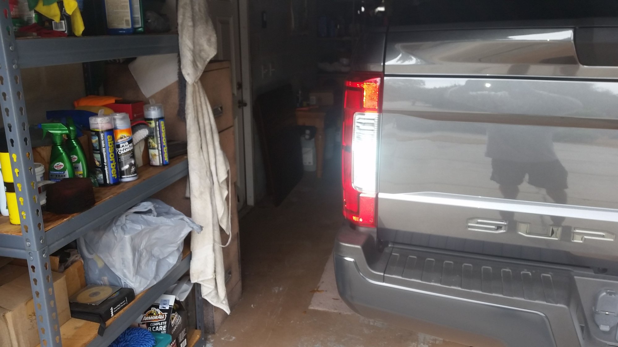

Done and reverse. Listen to poncho. I put on w red gaskets n very tight. Til I noticed when one fell off how easy it was to twist on.
Old Jan 20, 2018 | 11:42 AM
  #56
jsavelli's Avatar
jsavelli
Joined: Nov 2017
Posts: 462
Reverse is hard to see due to sunlight but no mo yellow
