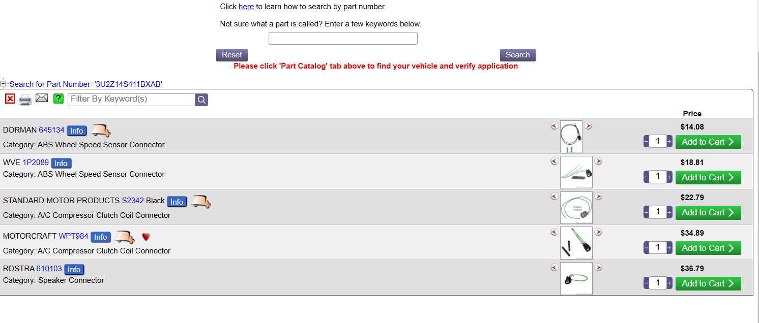

For those who did this and wanted to run another led off that circuit, the following part numbers marry up to the speaker wire kit 72-5600. I am going to splice two female plugs like the one coming from the truck to 1 male connector so I can use the same circuit for my existing running board lights and my new led light up door sill.
