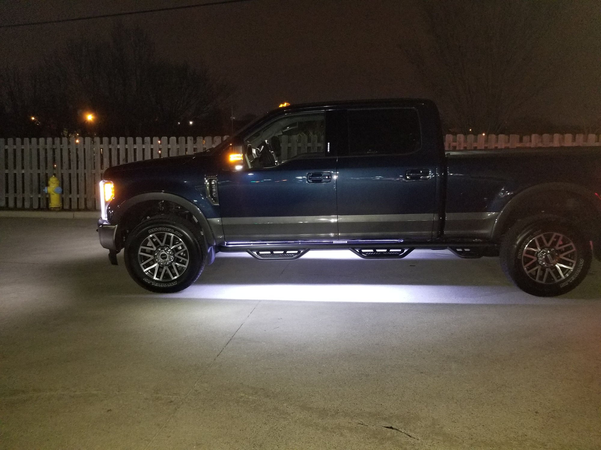

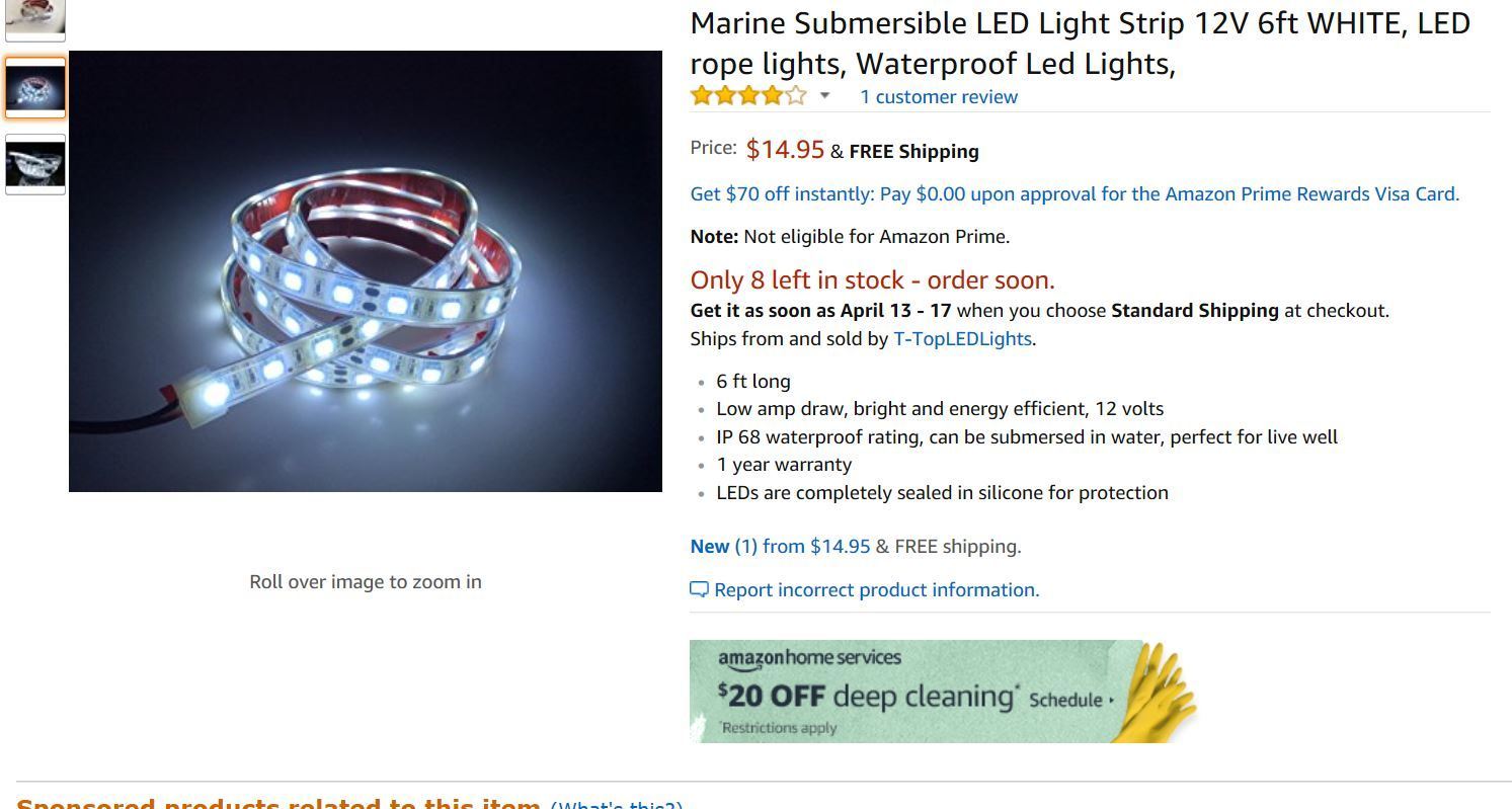

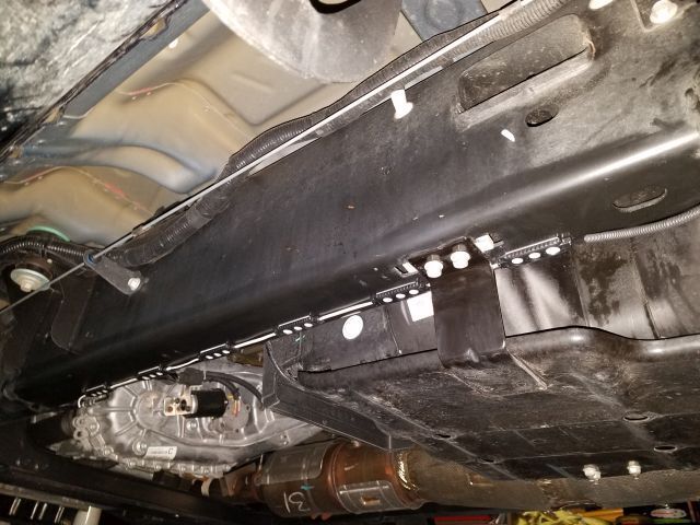

I used the connectors above and these lights, I was actually inpressed with the quality and water proofing of the lights. Installed them today, will try to post a picture of them on at night later.

Here is a picture using above listed components.

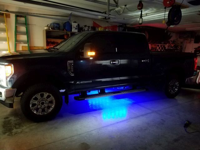

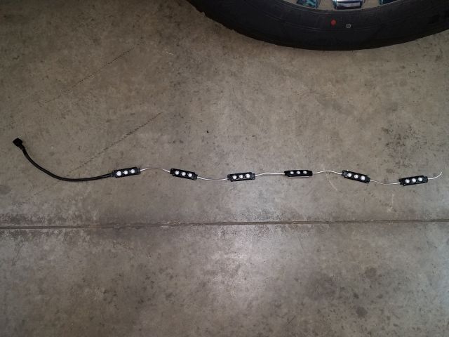

Originally Posted by 1956Fatfenders

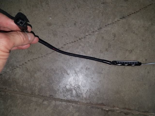

I ended up using LEDs from Oznium:
https://www.oznium.com/premium-led-module
I ordered 12 of the blue ones, 6 for each side. These came all connected together, so I cut the string into two 6-LED pieces.
I didn't feel the running boards needed any more light, but thought some under-glow would look kinda cool, and it turns off with the puddle lights.
After mounting, I realize there is room for 9 or 10 when I ended up mounting them, so I'm going to add 3 more on each side. This is the strip, connected to the plug ordered to match up with the existing frame connector.
The connector is soldered, with heat shrink tubing at the connections. Split loom was added on the feed end to make it look "finished":
Before plugging in, I put some dielectric grease in the connector. Once everything was mounted, I sealed the end of the split loom at the connector with clear silicone.
I couldn't find a good place to mount the lights on the lower edge of the cab, so I put them on the bottom of the frame. With the design of the lights, they shine straight down and are not visible from the side of the truck.
The floor in my garage is hard troweled, so the is a lot of reflection, but I think it looks pretty good on a Blue Jeans truck.
Wear did you get the plug to match frame connector? Part number? from ford? Thanks

Can somebody please show a pic of where the plugs wire comes from. I don't have the plugs so I want to see it I can splice in where they come from. Please

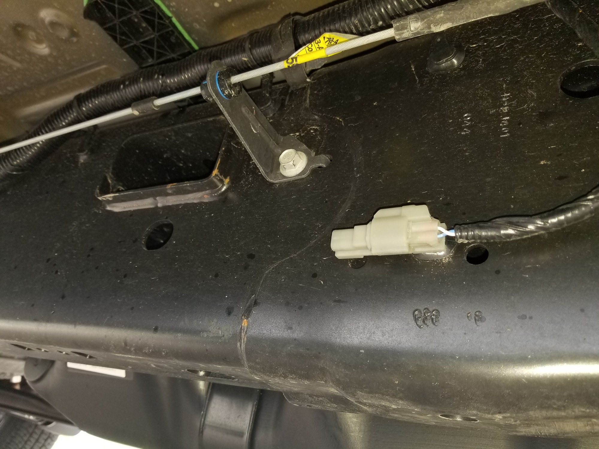

Here are the plug wires, they are right by the back of the rear door, on the outside of the frame.

Can you show a pic of where they come from. I don't have them but maybe can splice in where the originate from
That looks pretty darn nice. My parts will arrive Thursday.

Are the light strips being held to the truck with double sided tape, or did you use another method?

I used the double-sided tape that came with the LED lights augmented with a little gorilla Super Glue.
