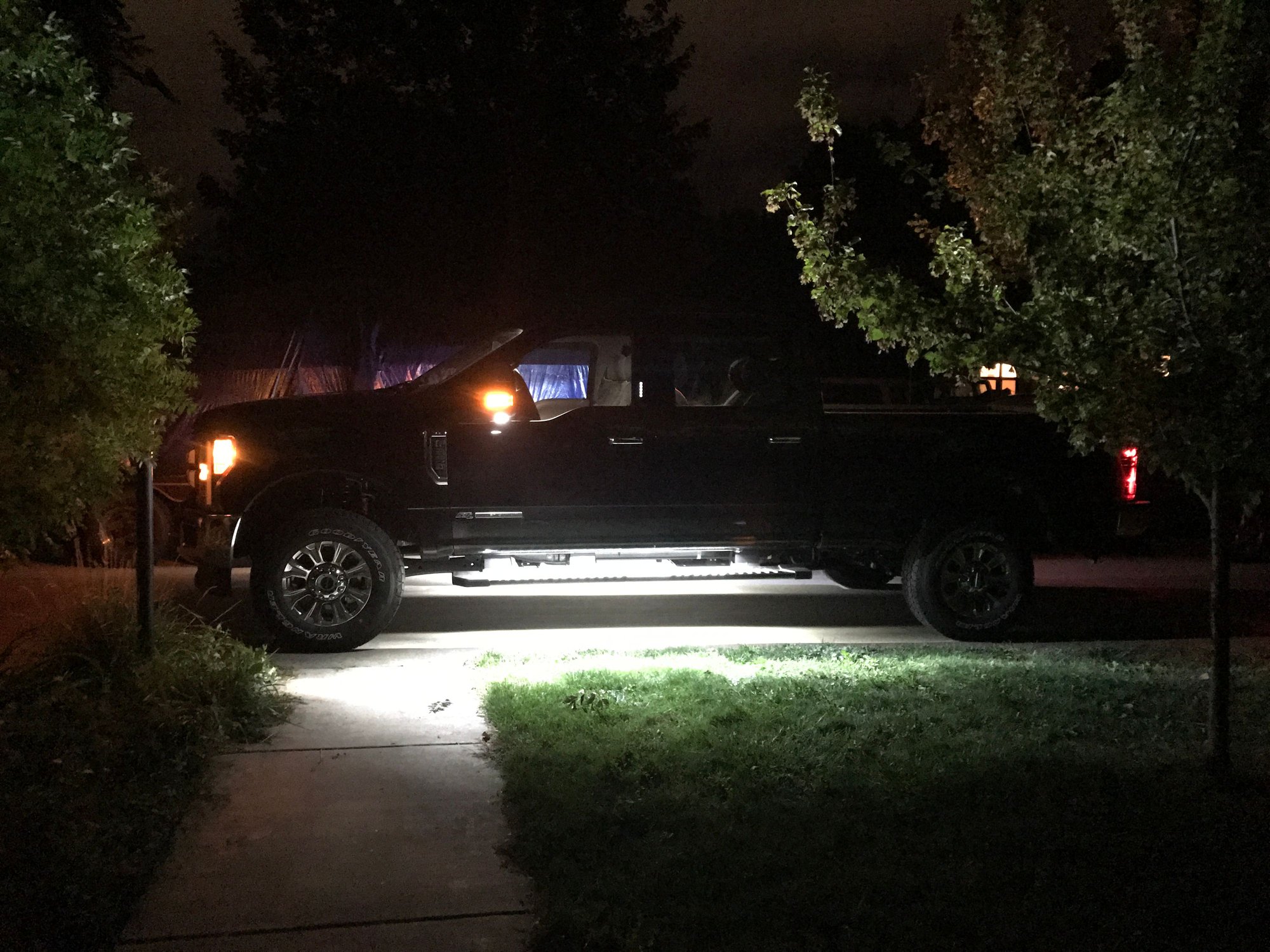

Alright folks, I took a stab at the install and after much time thinking about it I finally started, hesitated, scratched my head, and finished. I used a volt meter to test which probe worked on the top marker light, and on my truck it was the middle prong, so I tapped that wire. I had a lot of debate about where to run the wires, but followed where other wires were ran. The final result was worth the 6 hours of time I took to do from start to finish (with a lot of hesitation in there). I took a video, but will have to figure out how to upload video or a link to it after uploading to YouTube or somewhere.

To clear this up, I ran lights above the running boards and they do indeed illuminate the running boards and the ground when the rear lights illuminate (when I unlock the truck or open the doors as well I believe).

Pic since the YouTube upload was lower quality

I see that the lights illuminate when you unlock the doors. Which I like. Do they also illuminate when the door is opened (already unlocked)?
yes they do. I'm nervous now that they may be on when the headlights are on too. Not that I really care, but I think that's how it's wired since I tapped into the taillight. My wife was trying to diagnose for me while I'm at work, but I have multiple phone calls going on so I'll just have to test it tonight.

Assuming you did tap into the tail light, yes, they'll be on anytime the headlights or parking lights are on.
