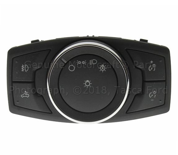

So I have the plugs for wiring in the running board lights. Is there anyway to wire these to work as oem (when puddle/courtesy lights are on) and also wired to an up-fitter switch to function whenever I’d like? I’m assuming just run a power wire down to each connector from the upfitter?
Use the plugs as designed; they will turn on when you unlock the doors, open the doors or anytime you want by using the cargo light switch.
Like the other response said...if you open the doors, unlock the doors, etc...they will work.
If you want to tie them into one of your upfitter switch, I wouldn't even use this connection and run the wire directly to the upfitter fuses...
I don't think you could run them both as they would tend to not have power unless the upfitter switch was on, or you split the wiring to your lights.

Thanks for the responses. I’m aware that utilizing those plugs, the lights will work in conjunction with the puddle/courtesy lights, but just curious if there was a way to have them function with a upfitter as well that way I can turn them on whenever (when the puddle/courtesy lights aren’t on.)That way I could have the best of both worlds if that makes sense.
