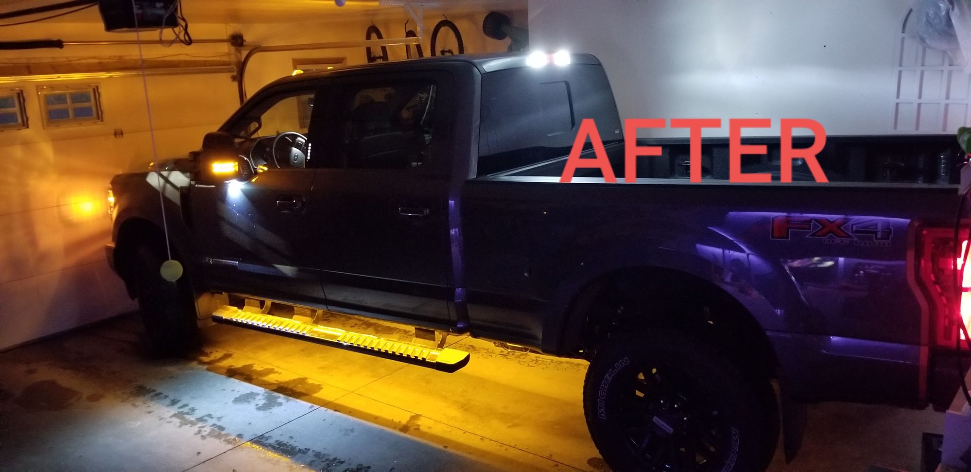

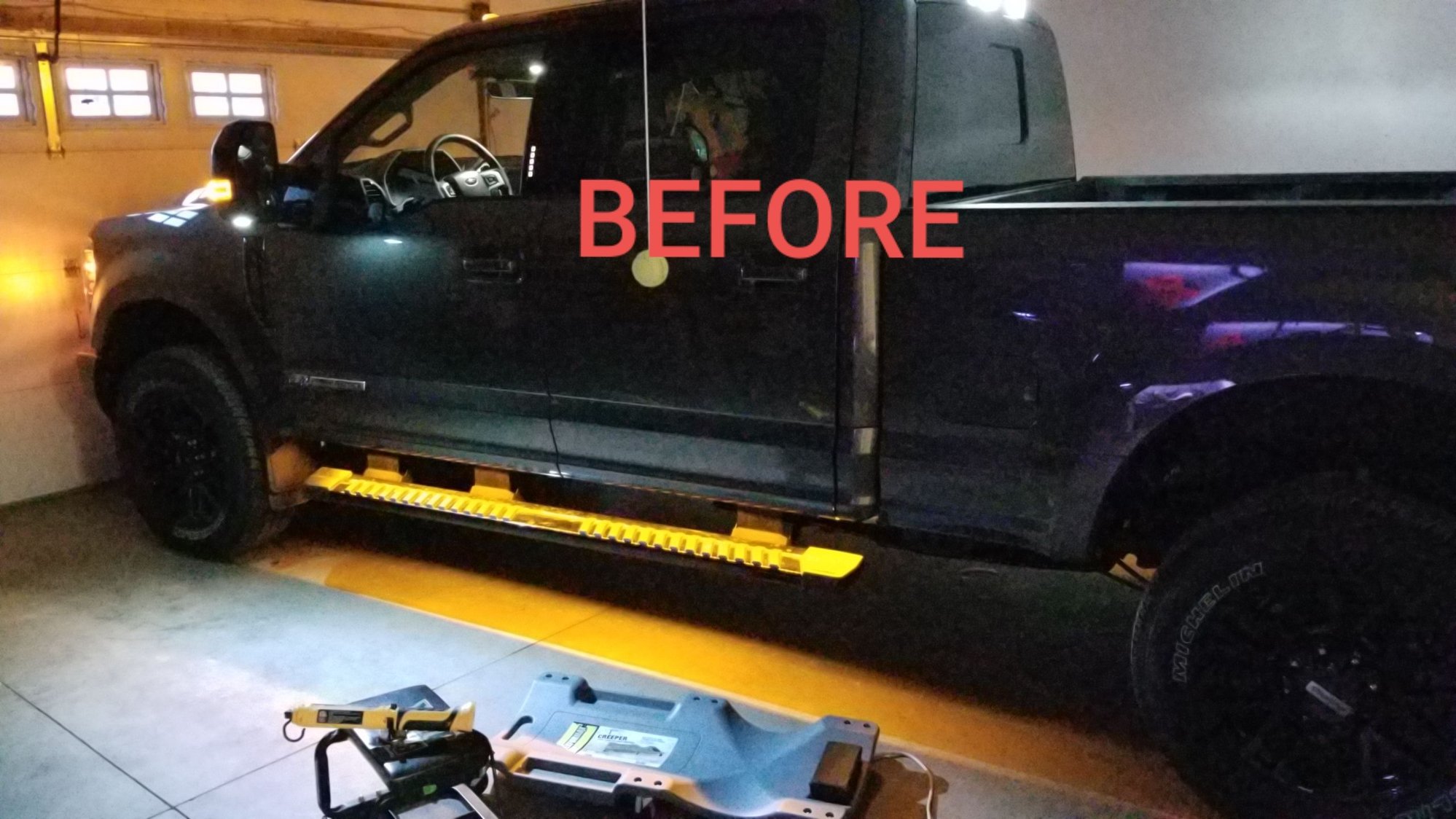

Old Feb 5, 2019 | 06:12 PM
  #149
KWDAILYD's Avatar
KWDAILYD
Joined: Mar 2017
Posts: 166
Originally Posted by '18_F250_4x4
Thanks for the info and will let you know (see) how they turn out.
I added another running board bracket on each side since I first posted the pics. Wanted this so there wouldn't be a gap between the second light and last one.
Old Feb 5, 2019 | 08:16 PM
  #150
'18_F250_4x4's Avatar
'18_F250_4x4
Joined: Sep 2018
Posts: 178
From: DFW
NICE!! I do like the three light look and will keep this in mind. Lights arrived so will start the process soon.
