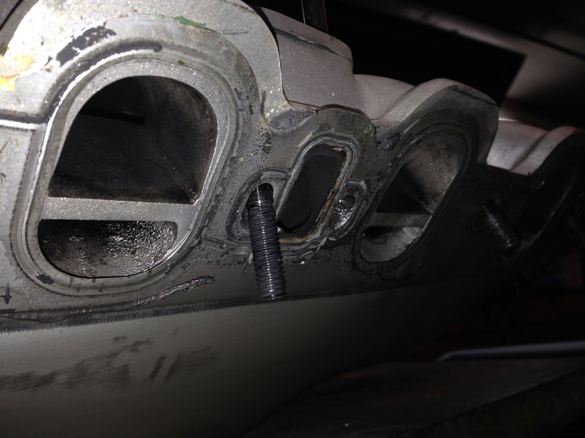

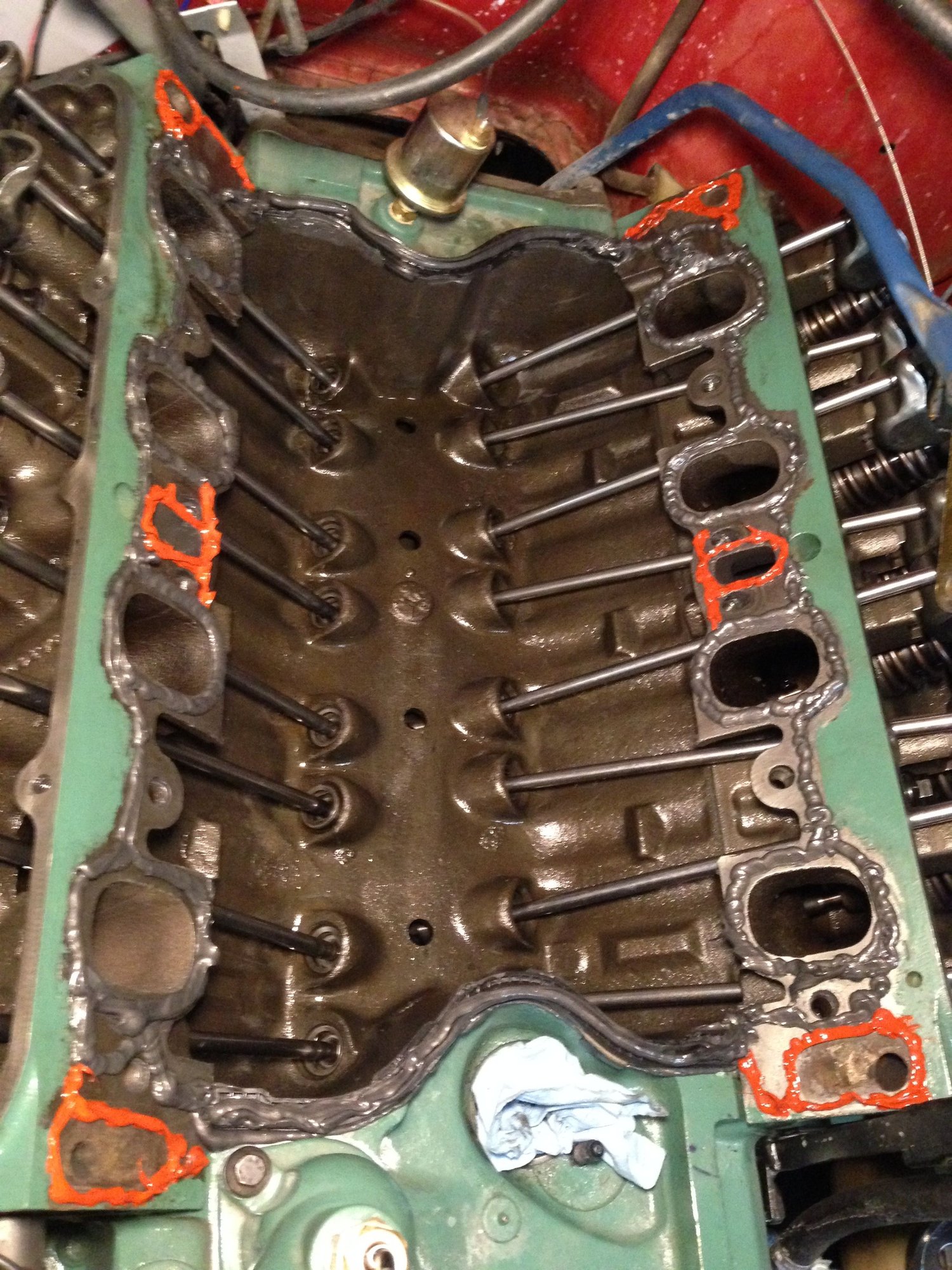

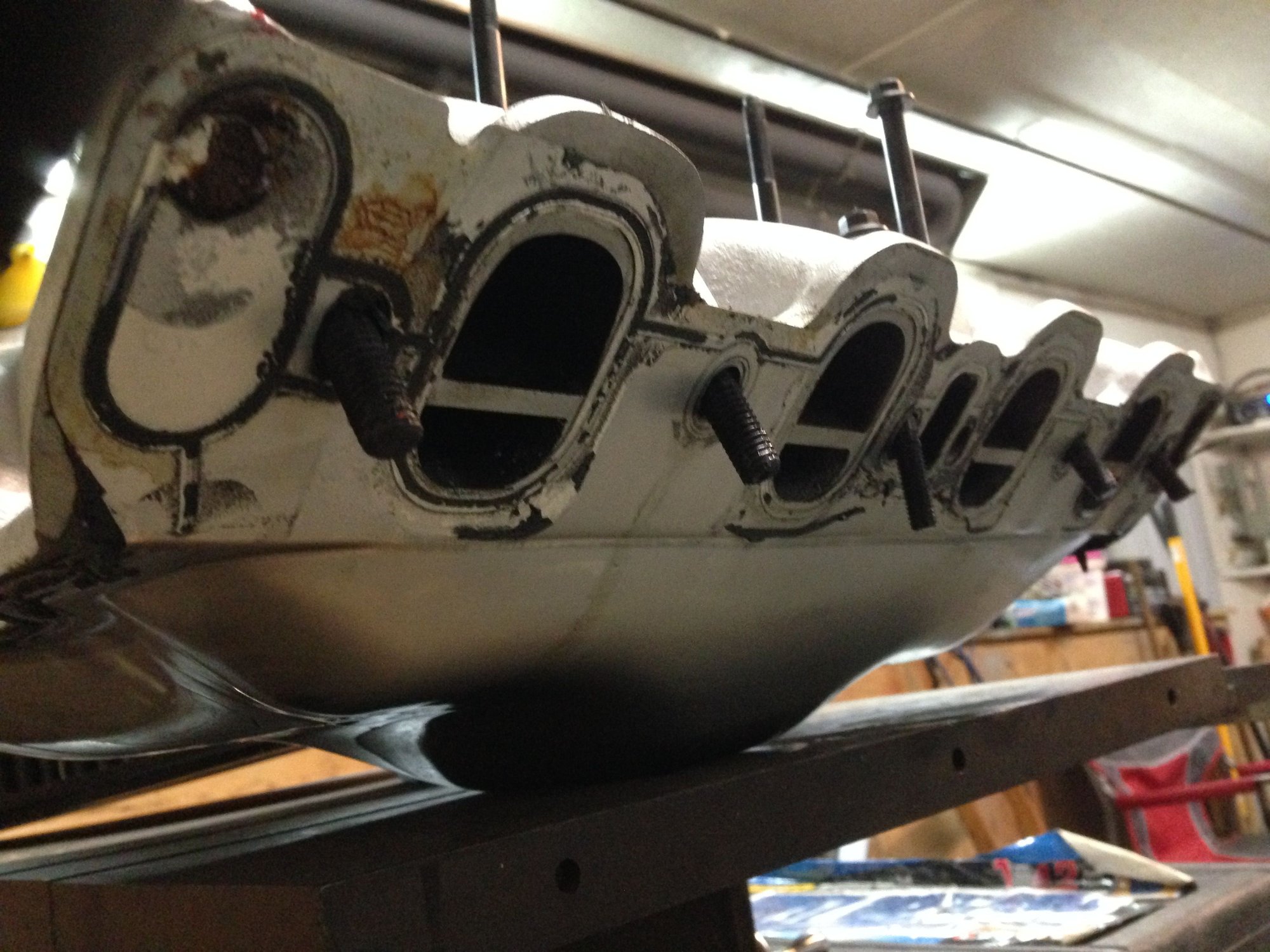

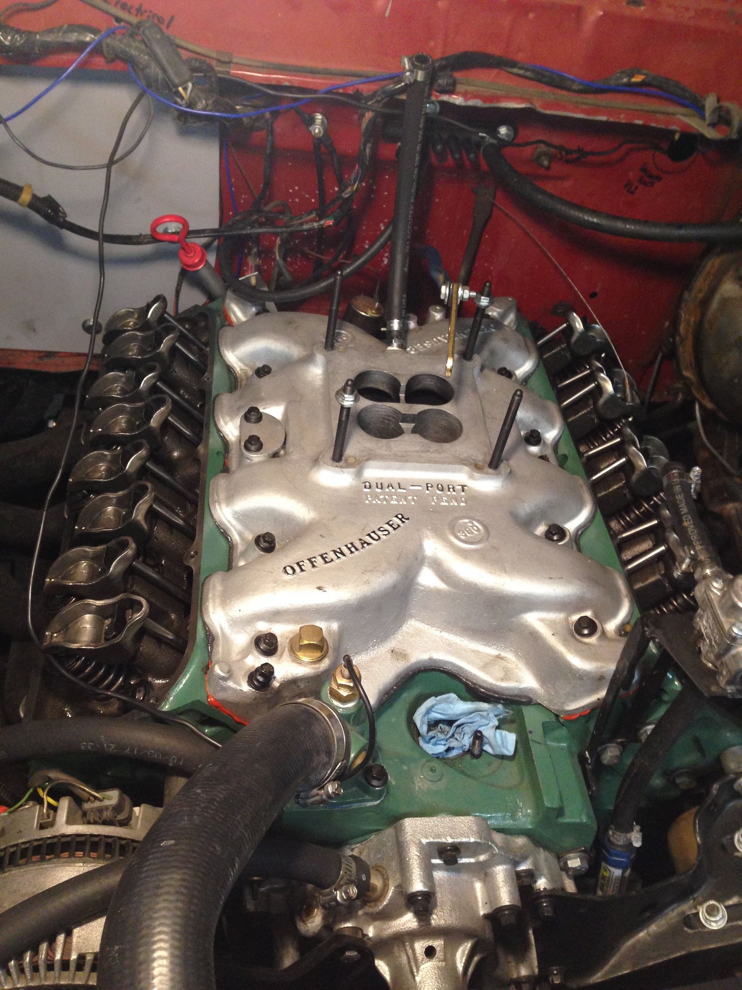

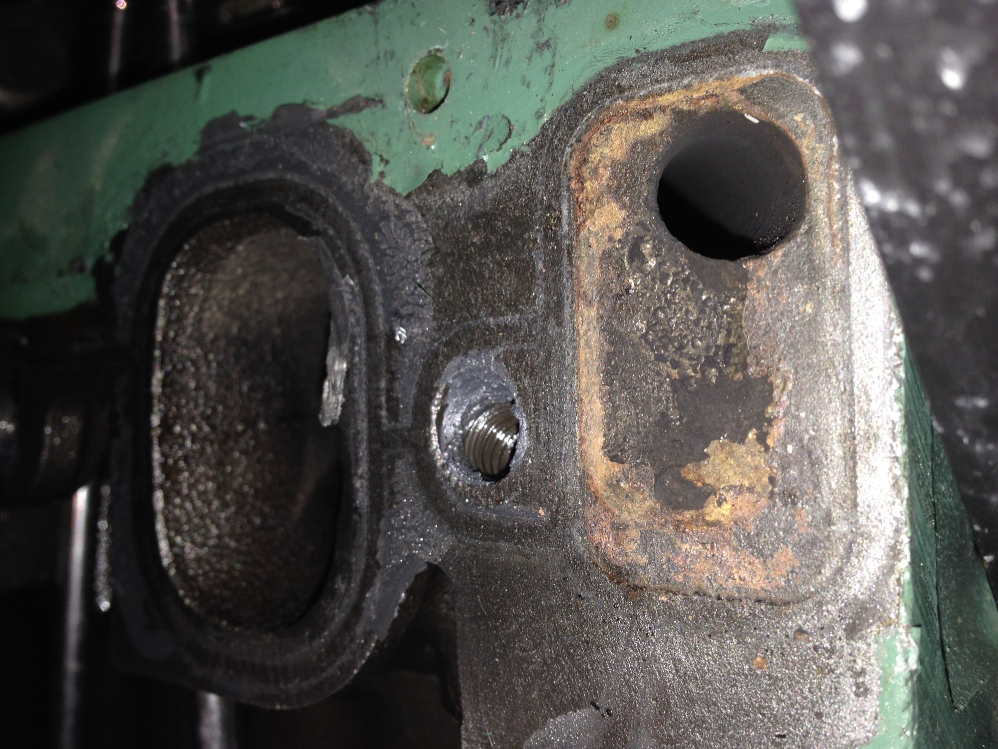

Yanked the intake today.

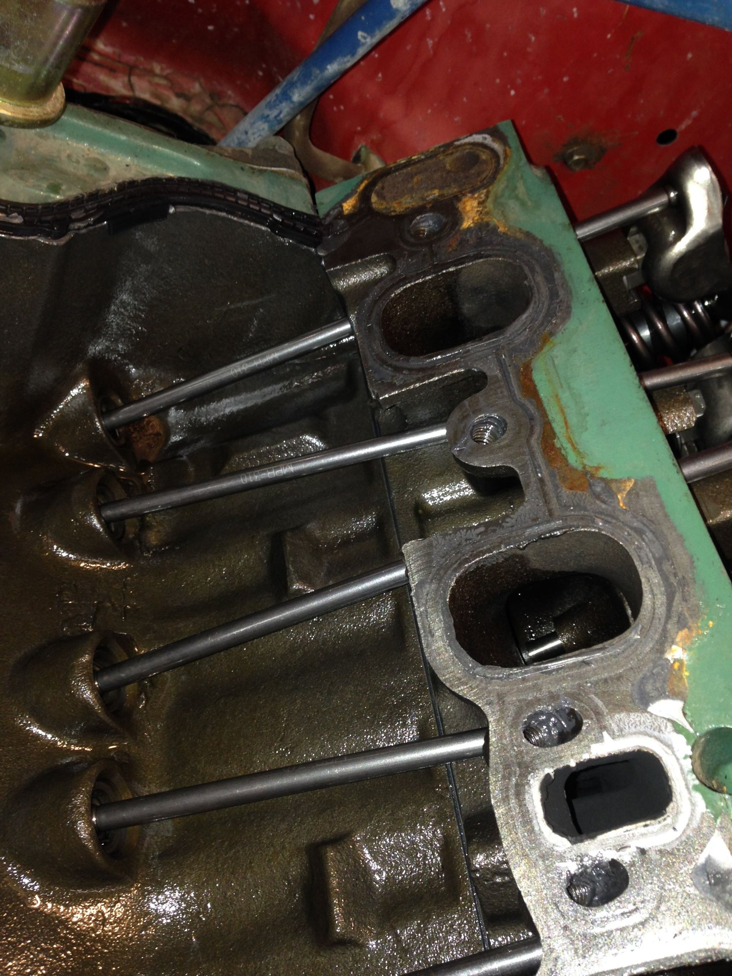

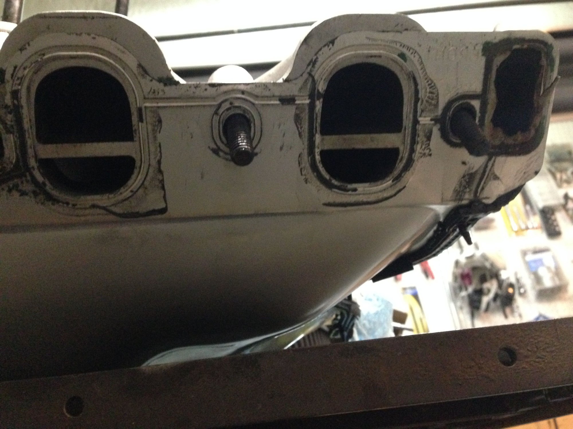

Found out that I definitely don't have enough RTV under the turkey pan... each of the intake runners was greasy/oily on its lower half. No wonder why my spark plugs are all so oily on their threads.
I'm planning on getting rid of the turkey pan all together... its creating a lip (restriction) between the intake and the head mating surface.

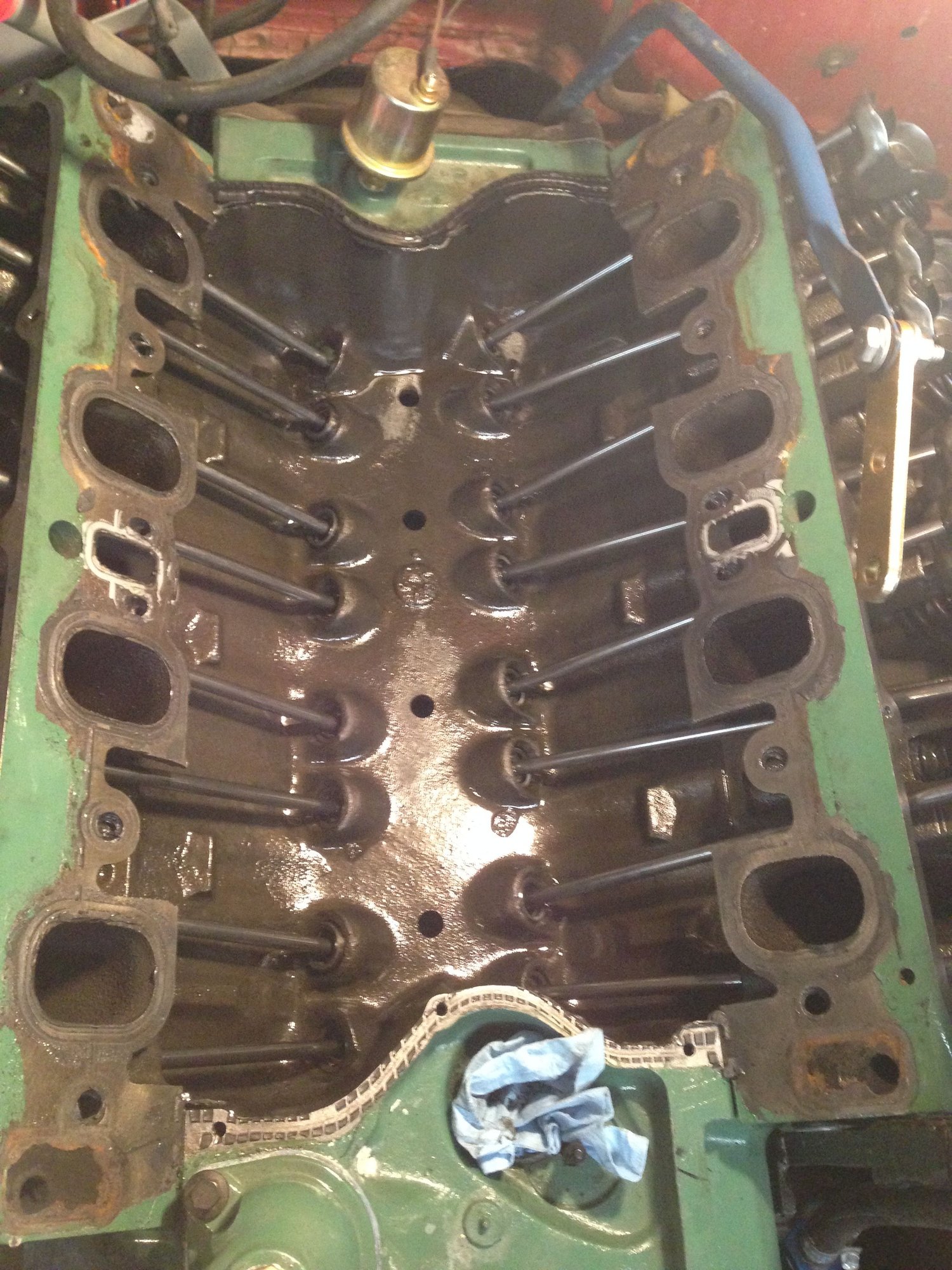

Notice the lowest part of the RTV on the turkey pan? It wasn't sealing up the intake mating surface at all.
Another photo.
Might be hard to see, but the bottom of the RTV is actually quite greasy/oily around all of the intake runners.
So here's the real evidence that something is wrong... notice how oily the bottom of the intake runner is?? The top half is bone dry. Cylinder #7 shown below.
I think I'm going to get rid of the turkey pan and just use RTV and the rubber gaskets on the China Walls.... Doesn't look like the turkey pan does much... Cylinder #8 shown.
Cylinder #5... Take special note of how oily the intake runner is, but also near the top half of it as well. This intake runner REALLY wasn't sealing properly.

The turkey pan did absolutely nothing for sealing up my intake runners... 7 of 8 runners had oil in the head.... even tho I had Ultra Black on both sides of the turkey pan (intake side and head side).

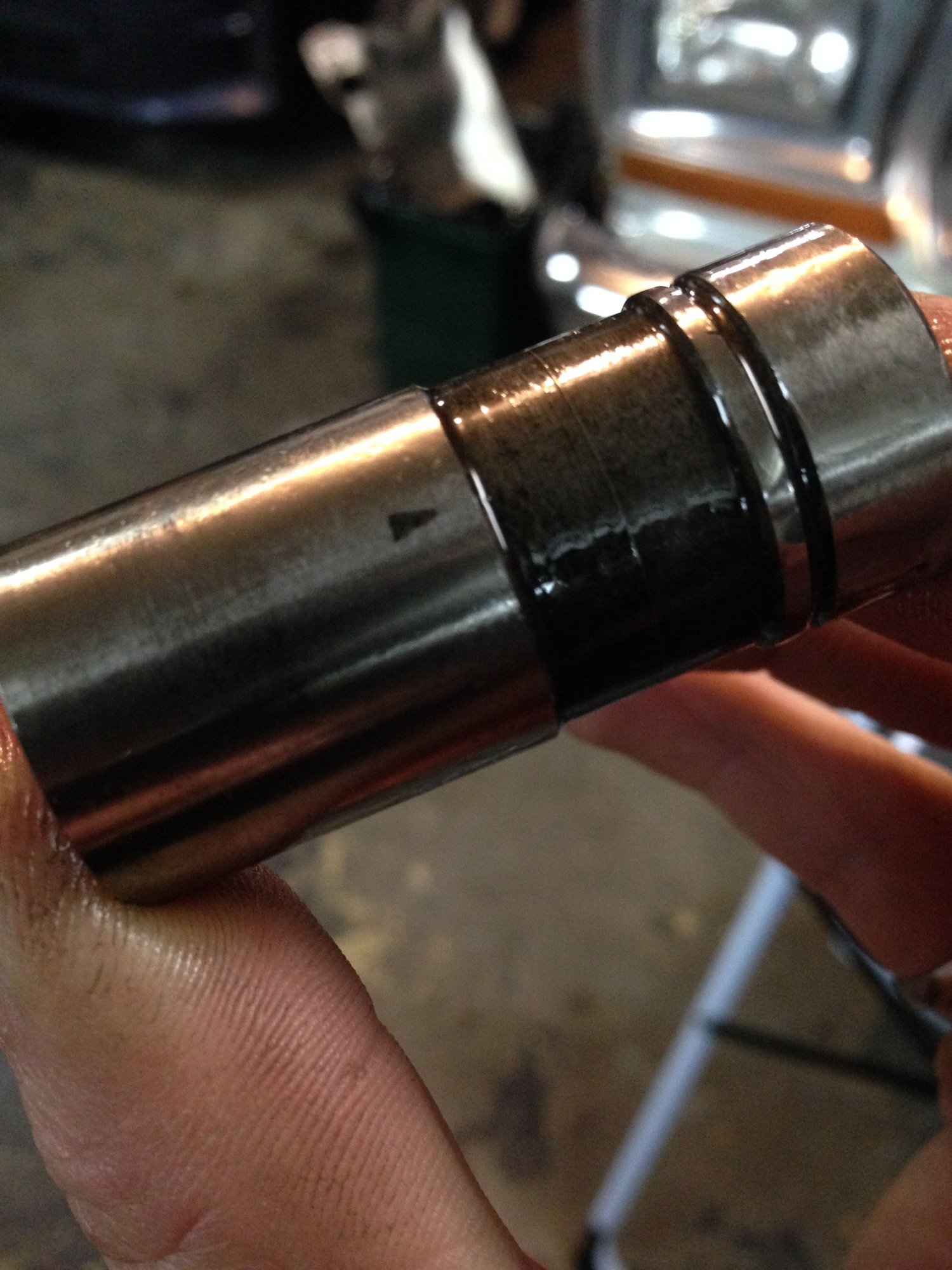

In other news... Found where my ticking is coming from... after pulling all 16 lifters, around half of them WILL NOT bleed down. Had the motor sitting cold for over 8 hours before working on it today. They had plenty of time to bleed out, and they didnt.
the lifters are definitely NOT comp cam lifters as I confirmed total body height with their tech on the phone to be 2.020" no matter which ones you purchase.
Mine have the following measurements:
body height = 1.985 (approximately; some are 1.989", others are 1.993")
total lifter travel = 0.100"
My previous measurement of 0.060" of travel was wrong as I was able to confirm the 0.100 total travel with a couple of bled down lifters today.
Its no wonder why my valves are opening slightly when I torque down the rockers... it's because many of the lifters are acting as if they're solid instead of hydraulic....
Are lifters repairable? It's very tempting to simply purchase higher quality lifters for a whopping $100... wish the shop would have done that in the first place....

Found my "ticking" problem over the weekend... and a couple other issues lol.

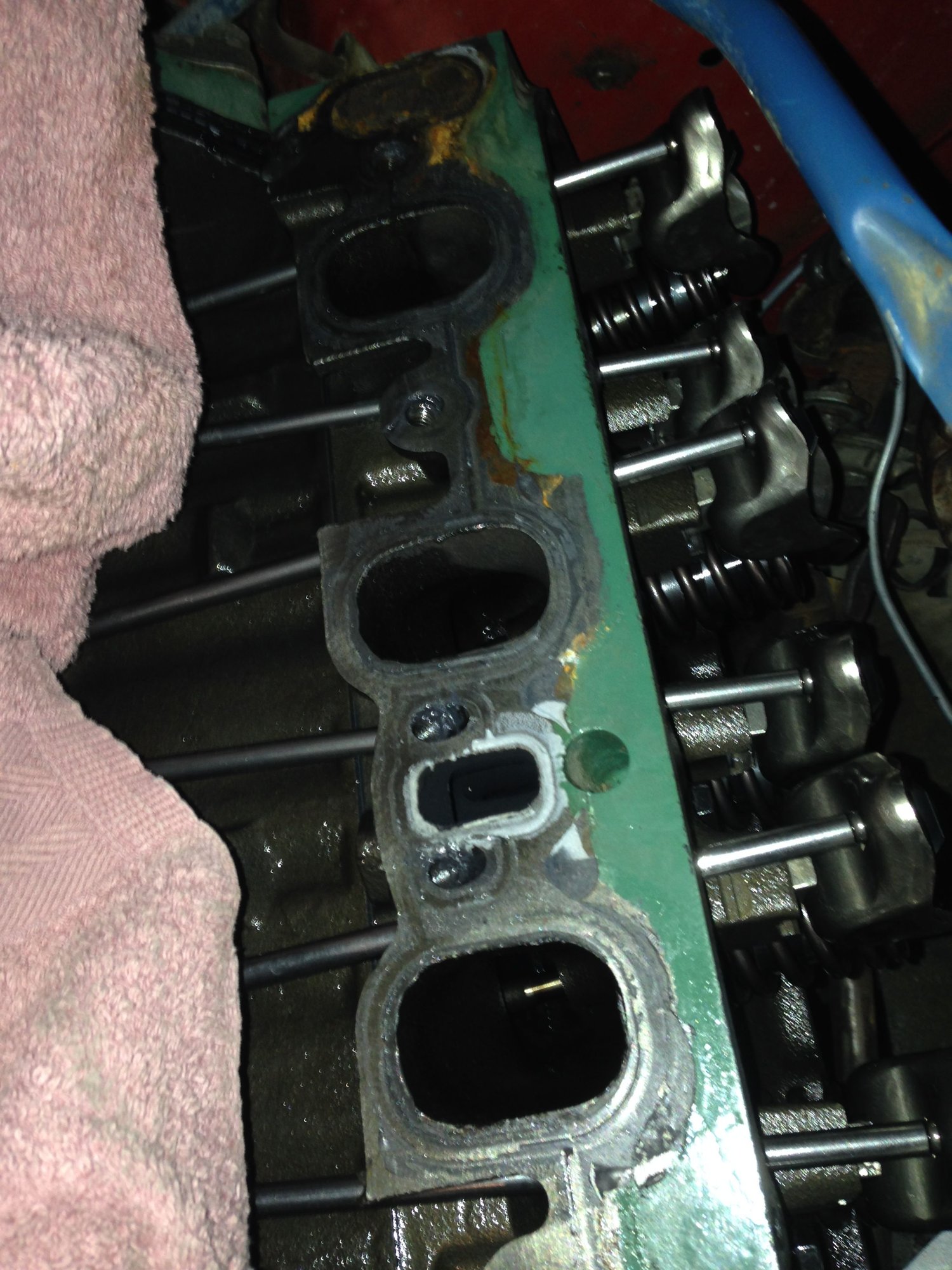

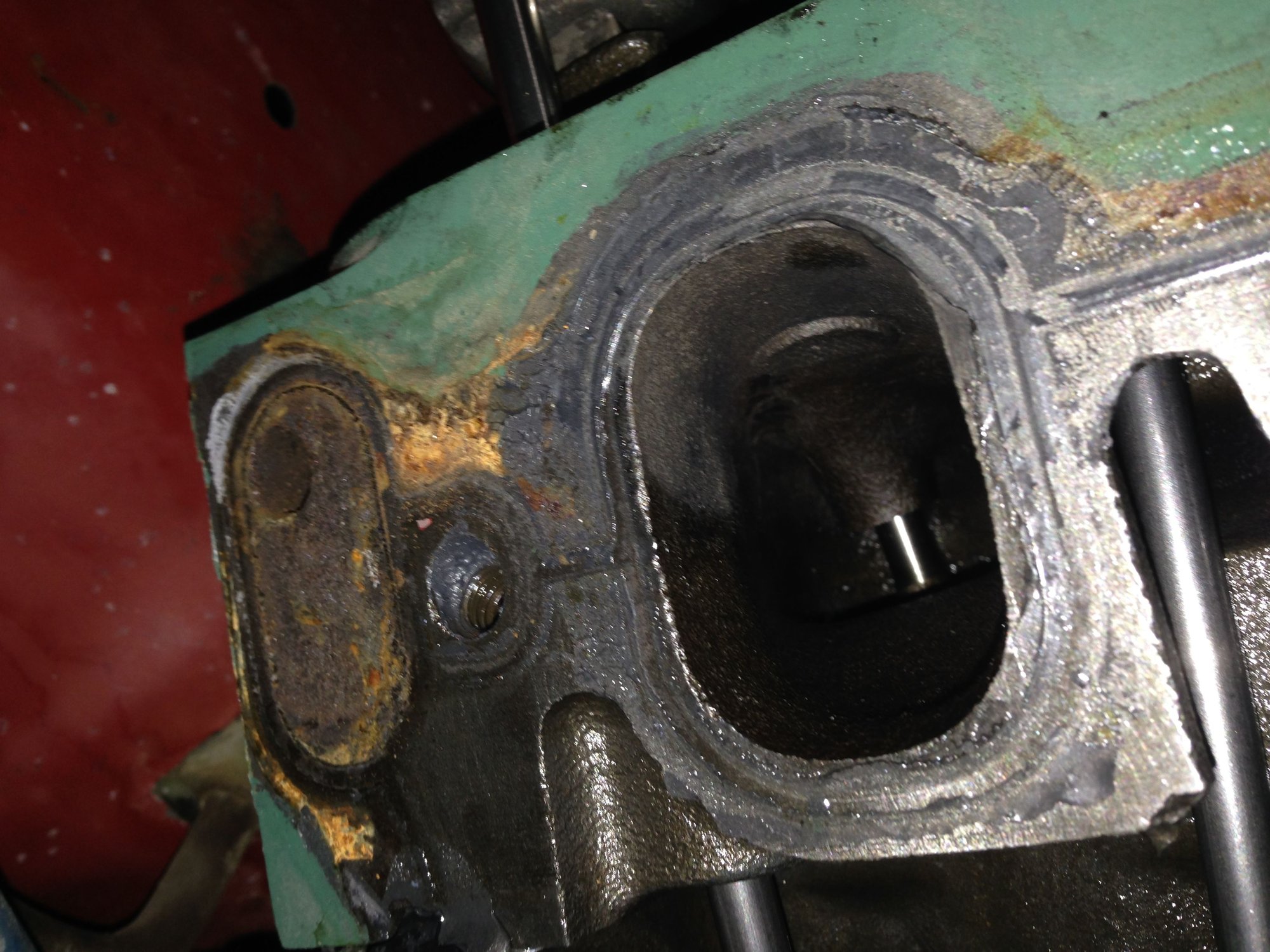

Intake didn't seal to the heads... thus why my spark plugs were so oily... I won't be using a turkey pan anymore...
The bigger issue - the lifters were NOT bleeding down like they're supposed to. Approximately half of the lifters are stuck and acting as solid lifters. No wonder why my intake/exhaust valves were opening slightly when the rockers were being torqued down!
Most of the RTV was blown out at the bottom of the intake runners, sucking oily air in from the crankcase into the head.
Evidence of that right here on cylinders 7 and 8. Bottom half of runner is oily, top half is not.

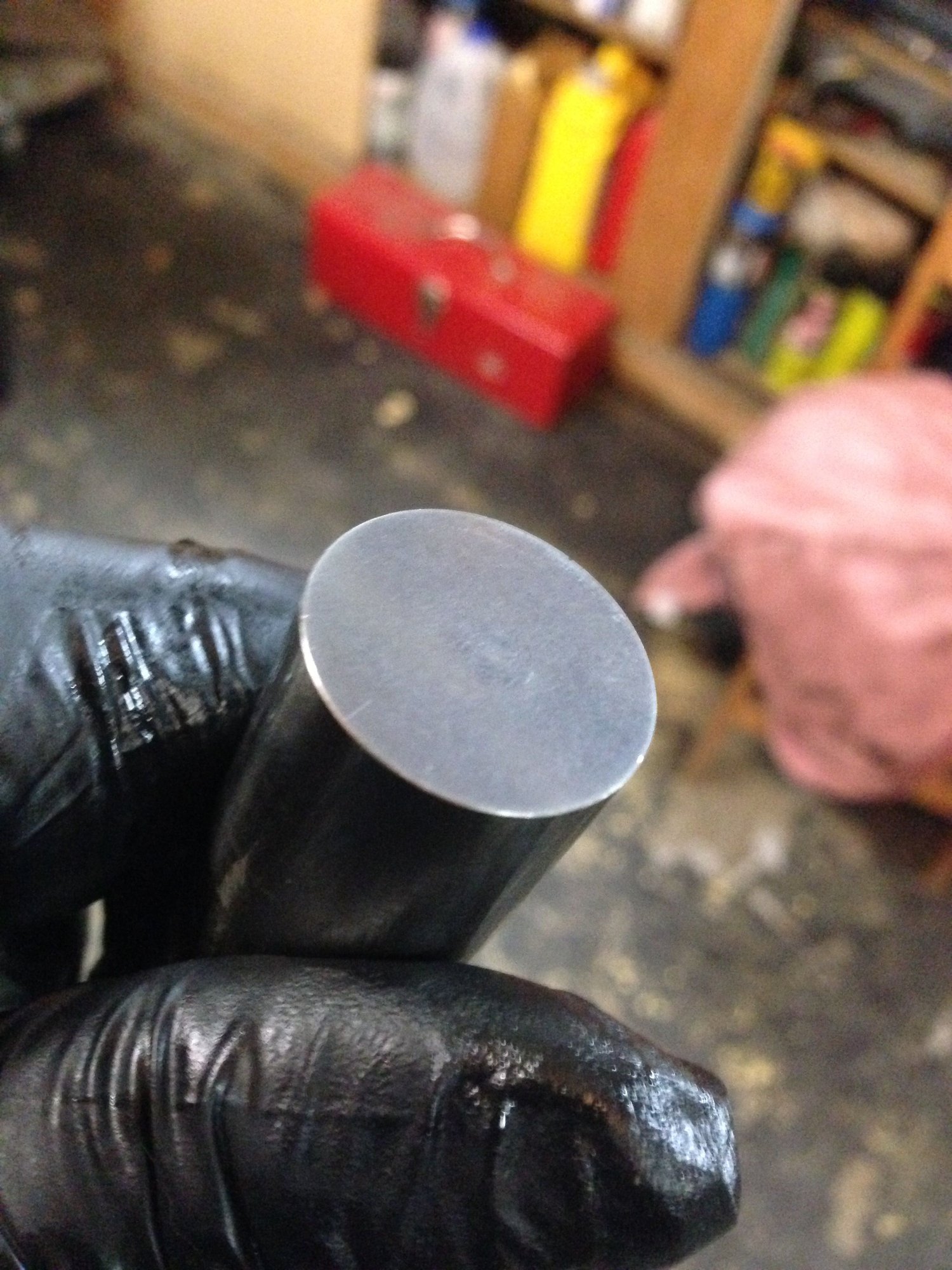

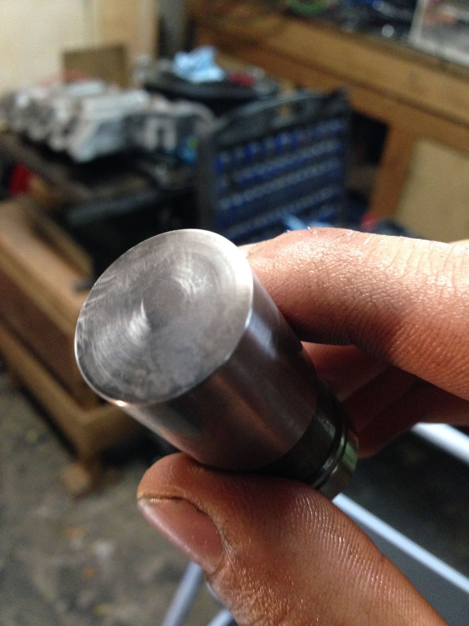

The 15 of 16 lifters of the lifters looked like this:
One lifter had a nice little gouge out of it... it won't catch anything, but I'm surprised by the quality of the lifter.... Under normal circumstances, this shouldn't happen with a "new" lifter...
Out of ALL the lifters, this was the ONLY one out of all 16 to show any signs of wear against the cam. Notice the scratch marks? Not good!!!!?????
After I cleaned everything up, I am temporarily using RTV all around without the turkey pan. Will need to purchase new gaskets this week and install properly once I get new lifters.
After the intake was seated.
Pulled the Dizzy to check for wear. Looks like it has an odd wear pattern... approximately 45 degrees worth of the gear was resting against the dizzy seat in the block... very strange wear pattern...
EDIT: All of the lifters are SQUARE. None are rounded at the bottom. Even the one with scratches was still square to the cam. None were U shaped or "cupped" on the bottom. That's one good thing I can say about my investigative weekend lol.

Those lifters should be slightly convex on the end, not flat or especially not concave. If you put a straight edge on the end and hold it up to the light it should only touch in the center.
Let me correct myself on the "flat" part.
I could fit a 0.002 feeler gauge under the outter edge of the lifter when against a very precise straight edge. When held up to a light, light would show up on the outer edges but not in the middle as you're describing.
I technically shouldn't have said FLAT because it does have some shape to it... but for all intensive purposes, it's basically flat.
I'm surprised there's no comment on the worn lifter from you Duster. I take it a wear pattern like the one shown is normal then??
