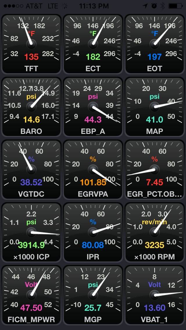

can someone please chime in on the above readings I got from my truck? I can't see how the EGR valve can bounce around that drastically but who knows...what about everything else?

Been so long since I had a functioning EGR valve that I can't comment on it, but it doesn't seem right. Please confirm exactly what that reading is (since it is in %, is it duty cycle?, is it the commanded value?).
Also, I would put the oil temp in *F to match the coolant (or vice versa).

Thanks Bis...Forscan says EGRVPA stands for EGR Valve Position Actual...with KOEO and at idle after being turned on, it reads 0% while after getting the engine to operating temps the %s increase....so to me the % corrolates to the % of the valve open at that particular moment which again I dont see how an EGR valve can go from completely open to completely closed, at the same
exact moment when the turbo is surging...This still could be a side
effect of the turbo surge though, or could be a cause of it, but no EGR trouble codes are present, just the PO299 Underboost
I just added in EGRVPD-EGR valve position desired into my dashboard so I will see how the 2 readings interact....I couldnt find EGR Valve commanded value but will look again under the OBD section...also added in Trans Fluid Temp and put the Oil Temp to *F! oops...

Is it possible that my EGR valve is bad and causing the turbo surging and giving me a PO299 Underboost engine light??I ask cause at Bismics request I added in the EGR Valve Commanded onto my dashboard on Forscan Lite and sure enough the EGR valve actual jumps all over the damn place while the EGR commanded steadily changes and rarely had a value of over 25% and thats at idle when both actual and commanded were close...
Something else I noticed is that the turbo surge is almost non existant when cruise control is on...not sure why that could be other than maybe the gas pedal is super sensitive and my right foot is shaky?! Or is there a logical explination for that? Also the VGT Solenoid % didn't jump all over the place with cruise on, while the EGR was all over the place with cruise on...In any event, here are some shots of my readings from Forscan...1 should be idling after a 20 mile drive, 1 should be full throttle and 1 should be going about 40mph
Tomorrow I am going to unplug the EGR valve and see what happens....I will be perplexed if the EGR does this same shenanigans
cruising
full throttle
idle after driving
