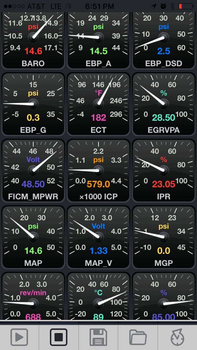

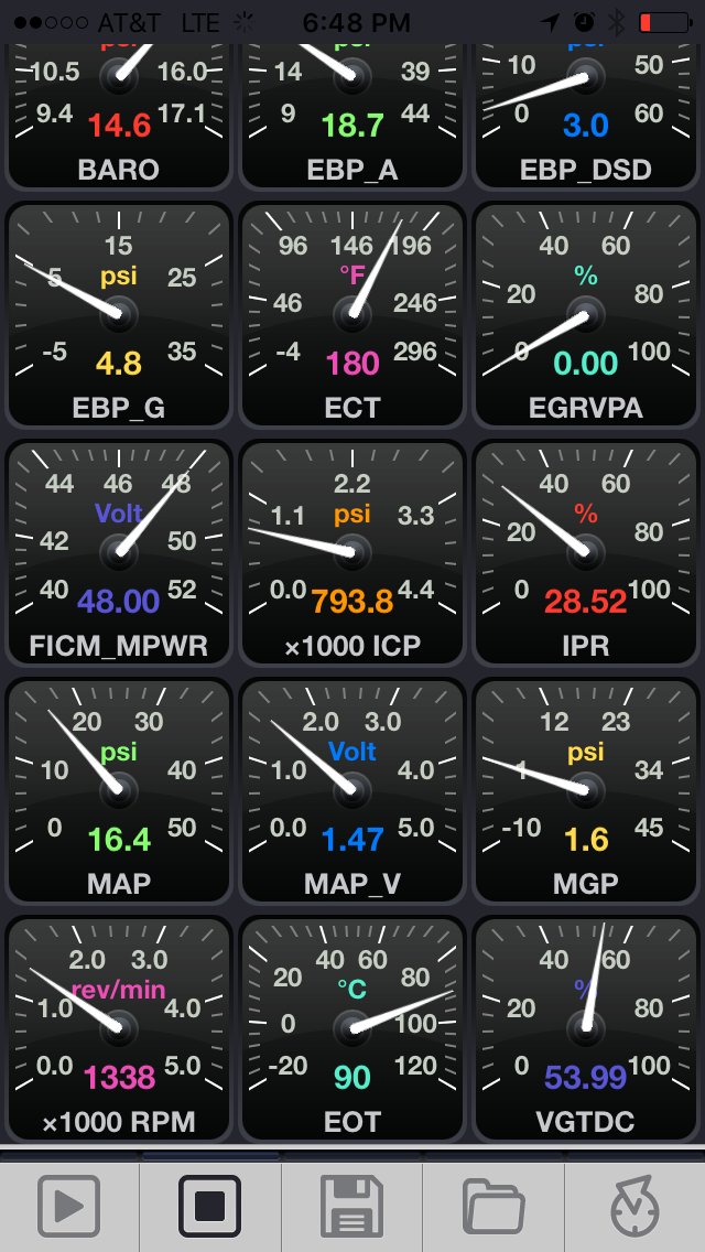

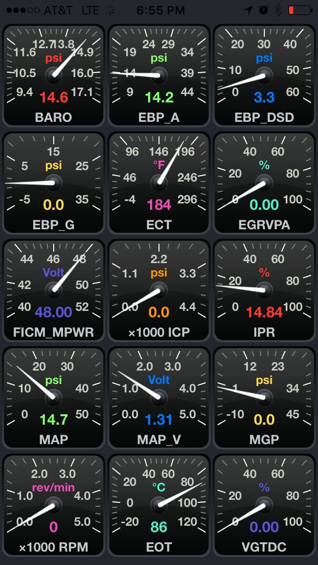

Well damn I feel like an idiot...guess thats part of being a noob...I added in EBP Absolute, EBP Desired, MGP and BARO in PSI..sure enough at KOEO my EBP was close to the MAP absolute...damn!
the other issue I observed and will show below in some pics, is that when driving at a constant speed my EGR Valve Position will fluctuate between 0% and 121%...I wonder if my EGR valve is bad, altho I have no engine lights or codes for a bad EGR...here are some pics
the first pic is KOEO, under that is idling after driving a short distance (5 miles or so), under that is driving about 35mph IIRC..notice the EGR surges between 0 and 121 while RPMS and VGT stay about the same...ahhh now im back to square 1! maybe ill disconnect the egr valve while its close and drive it and see what happens, I did the same with the ICP and the turbo surge was still there....oh well, please chime in guys!
Steve
