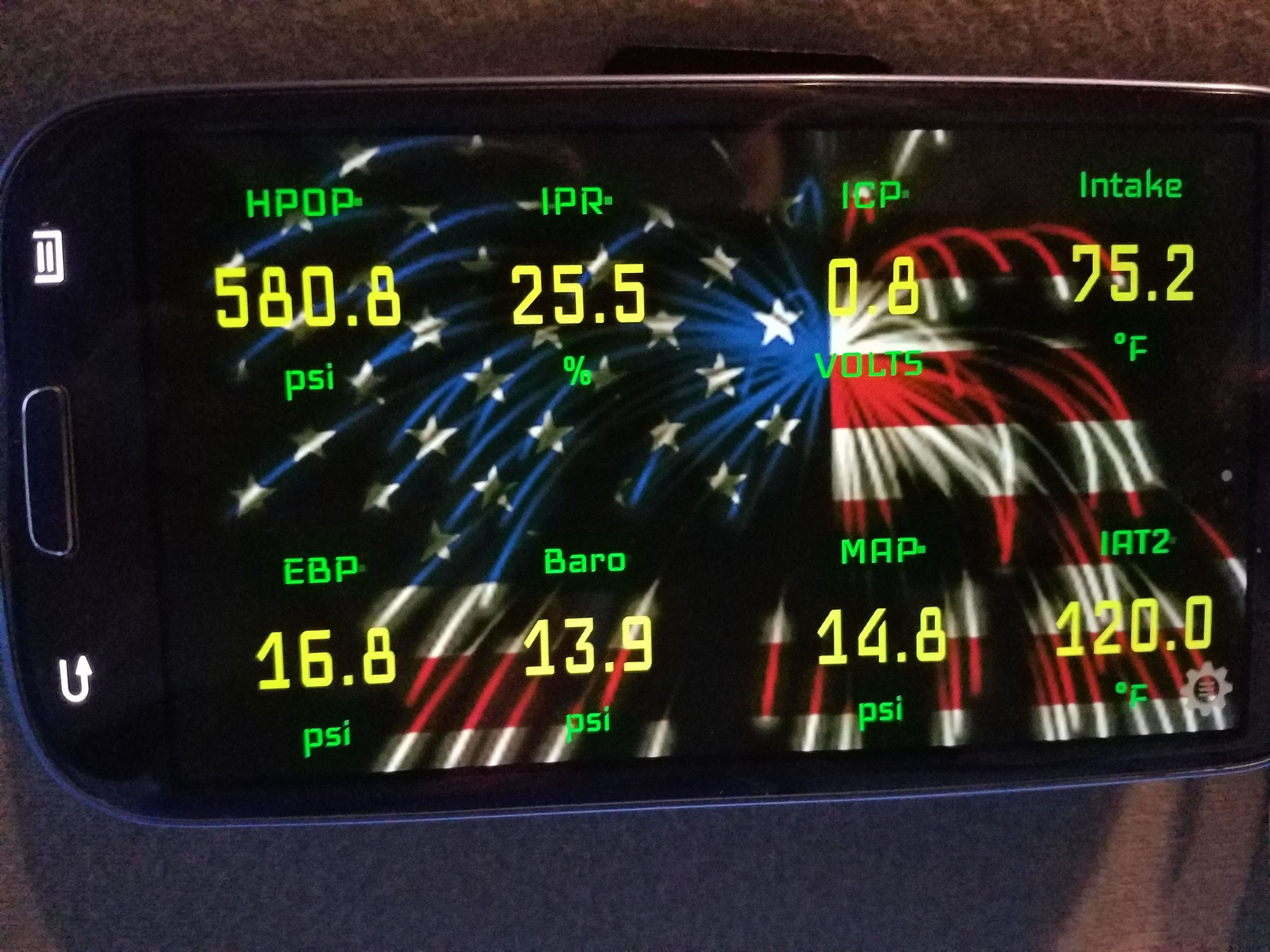

Which means we need to see MAP, BARO and EBP at Key on engine off, they should all read ambient pressure. Then again at idle. Then again under acceleration - don't crash the truck.

I'll post up those numbers when I get home from work. I checked them first and they were ok. I even cleaned the EBP tube again last Saturday when I checked all of my connections again. Wiggled all the wires and connections also with no change in numbers useing live data.

The best way to check things would be with IDS and
to a turbo test.
I did not catch the pre-test baseline.
Give it a few to upload.

KOEO
