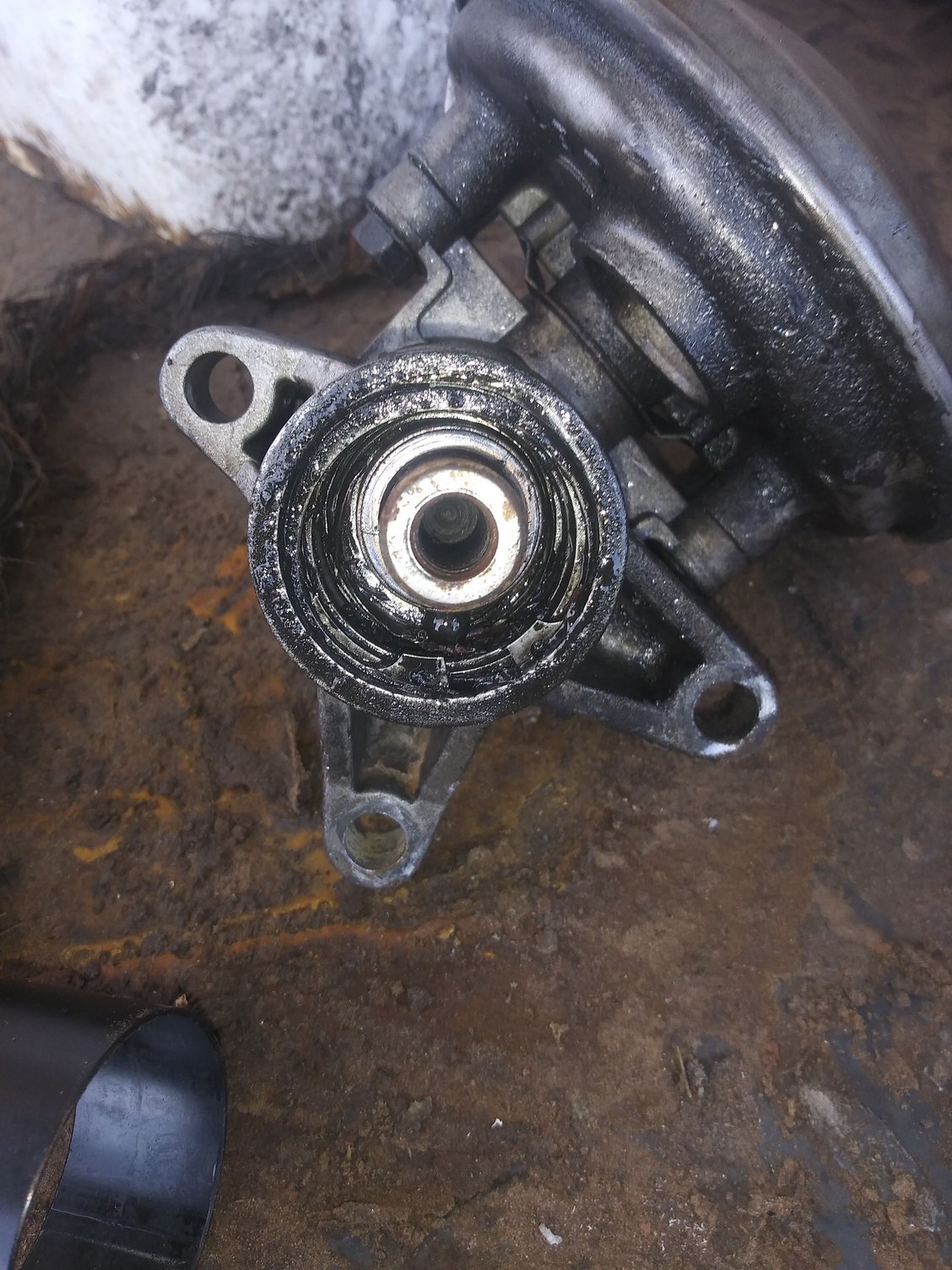

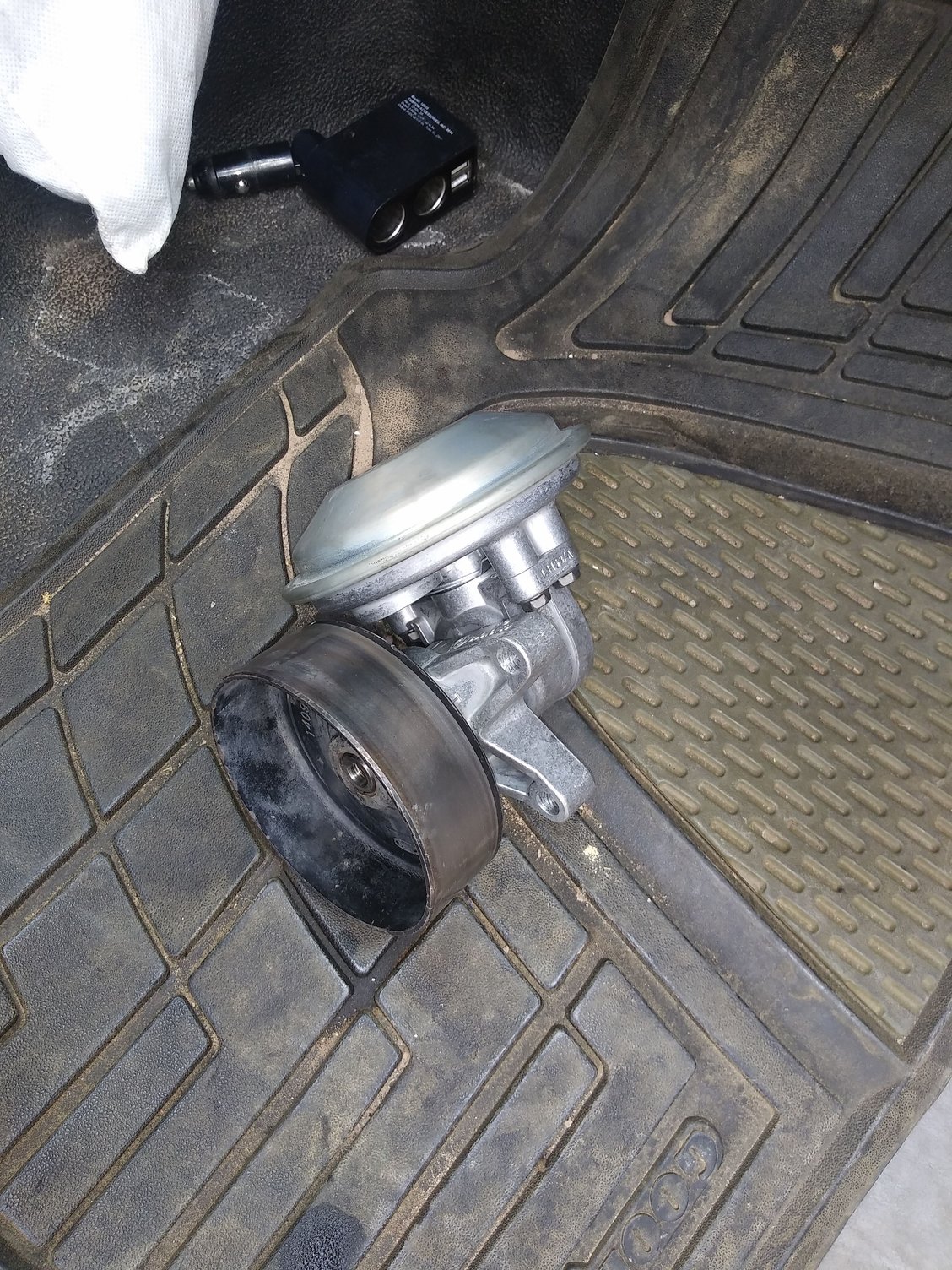

Not a whole lot has happened with the Mule, except a blown vaccum pump last week.
heres some pics of the failed bearing
What gave it away was the smell of burning rubber (serpentine belt slipping on the vacuum pump pulley) surprisingly there was no squeak or odd noises before it gave out.

That's what happened to mine when it went.,, except I lost all power breaks and AC.

I still had ac and power steering functioning due to the serpentine belt still riding on the pulleys, but with a seized vaccum pump i had hard brakes. The funny thing is the broken vaccum pump still works when you spin it by hand, minus the shattered bearing.

Mine seized, then broke free in January of this year. :/ Not cool! At least I was able to limp it back and park it.

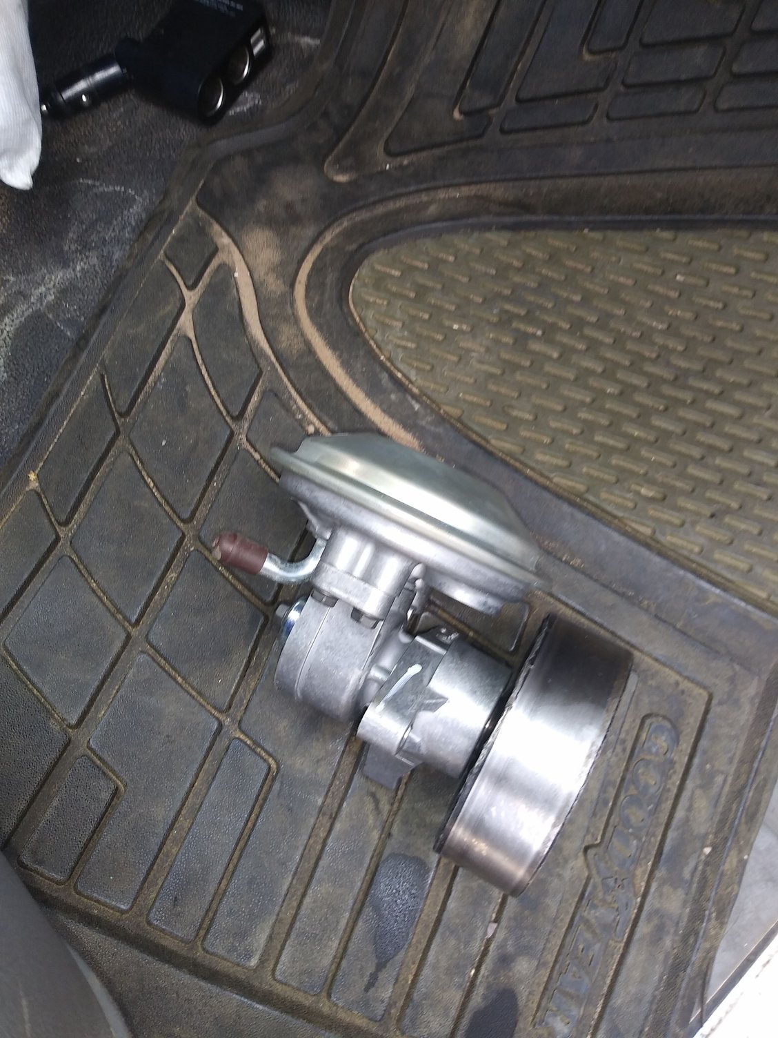

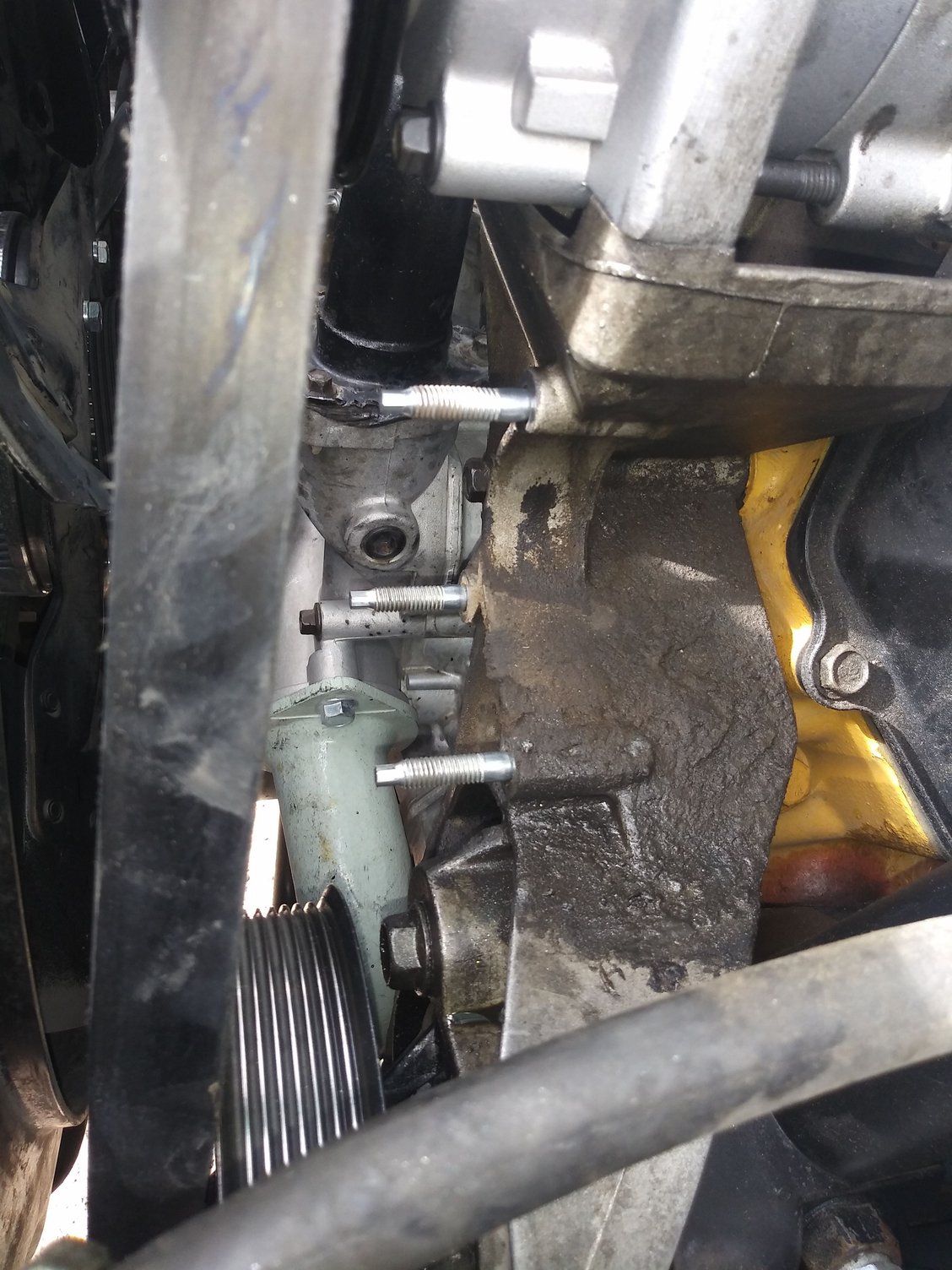

Installed the new vacuum pump today, and instead of re using the old bolts I went ahead and installed studs instead, and I'll tell you what its worth it, no more removing the pulley to re use them in the even of a future failure. I had some new left over 5.4 2v exaust manifold studs that were the same thread pattern as the vacuum pump bolts.
Dam i was posting pics up but dont have a picture of it installed, ill post one in the morning if anybody is interested.

Where did you buy the VP? brand?. What size are the studs?

It was under warranty, and its a Cardone VP, not sure on the thread pitch or size, believe thry are M10-1.5 60mm?
