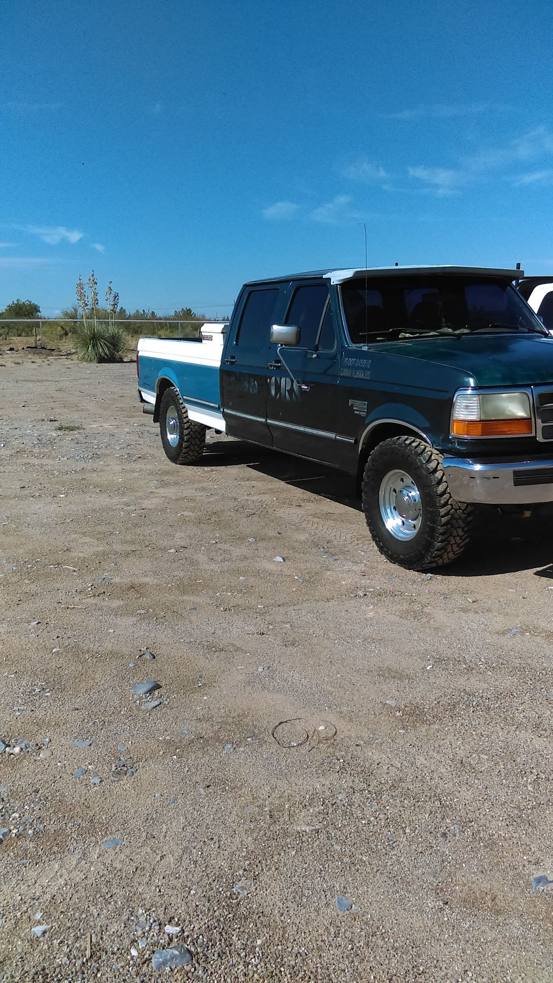

OK manage to test drive her today over all satisfy with a big *** grin on my face except...... I had a hard *** time installing the down pipe, even had to bang the down pipe in several places to fit and still is rubbing on the firewall, it's either a 2" body lift or cut up the firewall. Also I'm having a hiccup with the truck stalling on me when coming to stops, random not always but the rpm drops to 400rpm then dies, I unplugged the ICP cured the stalling part, but still have the rpm drop, there's no way I can monitor my truck as I haven't had PCM reflashed to accept OBDll, but I'm suspecting bad IPR O rings.

Hey Byron I'm planning on changing the IPR right now (remember the baggie with all the sensors I had) well I have a couple of IPRs and one almost brand new so I'm using this one, S a matter of fact I'm installing it right now lol....

Problem fixed IPR cured it.
Even went to wash her.
