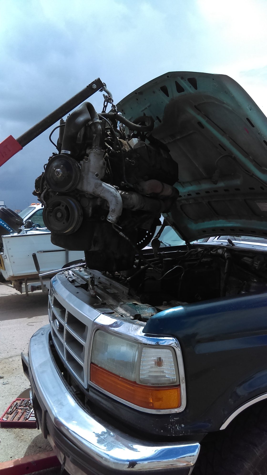

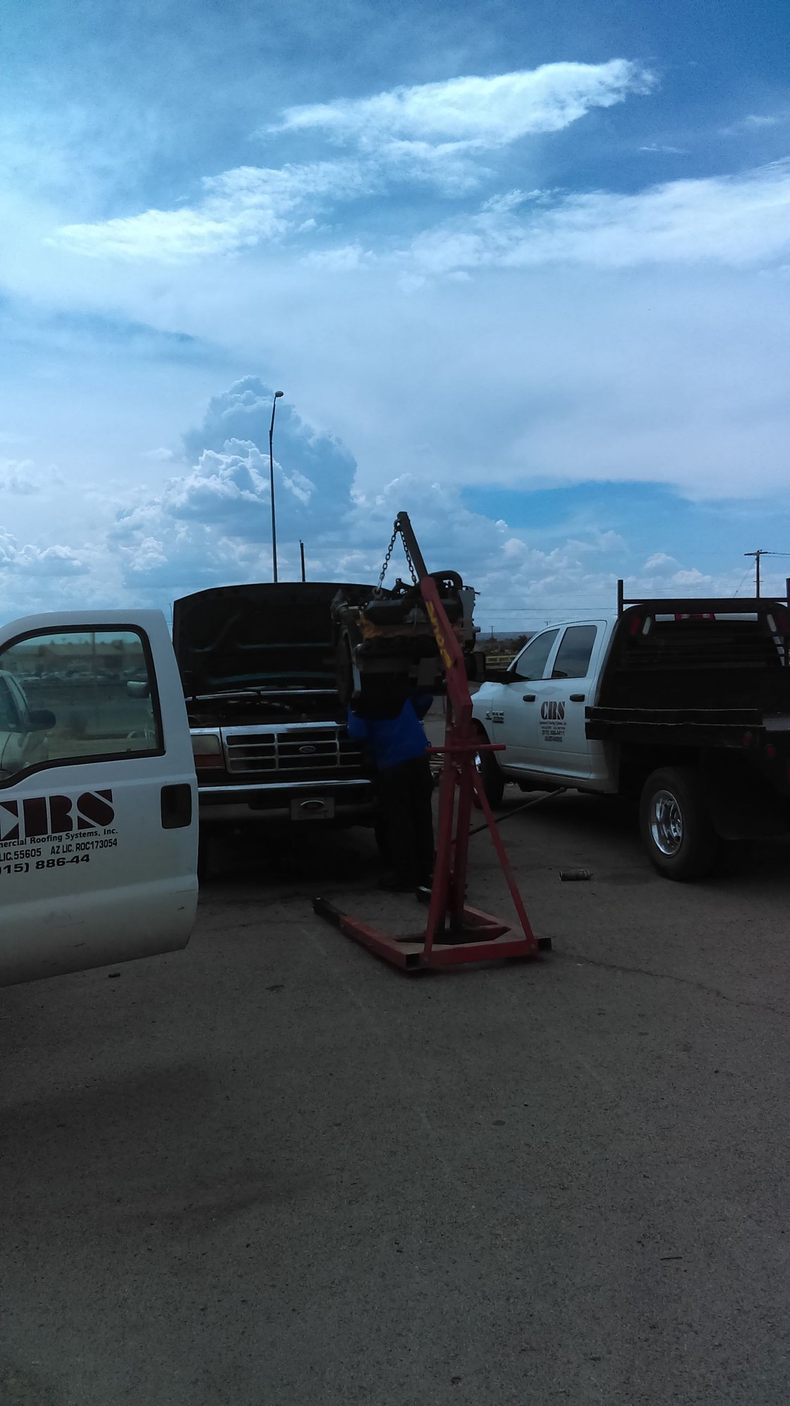

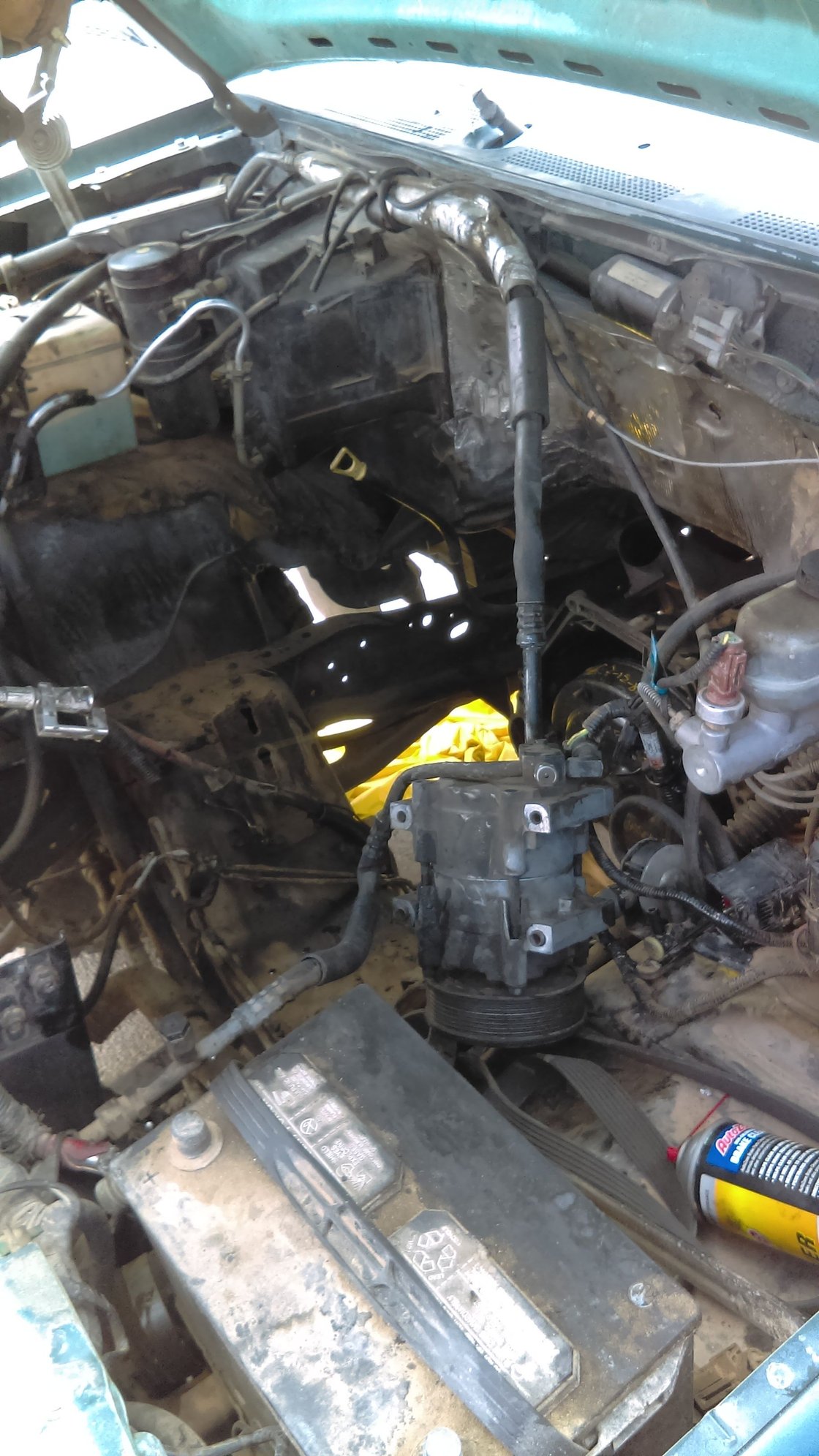

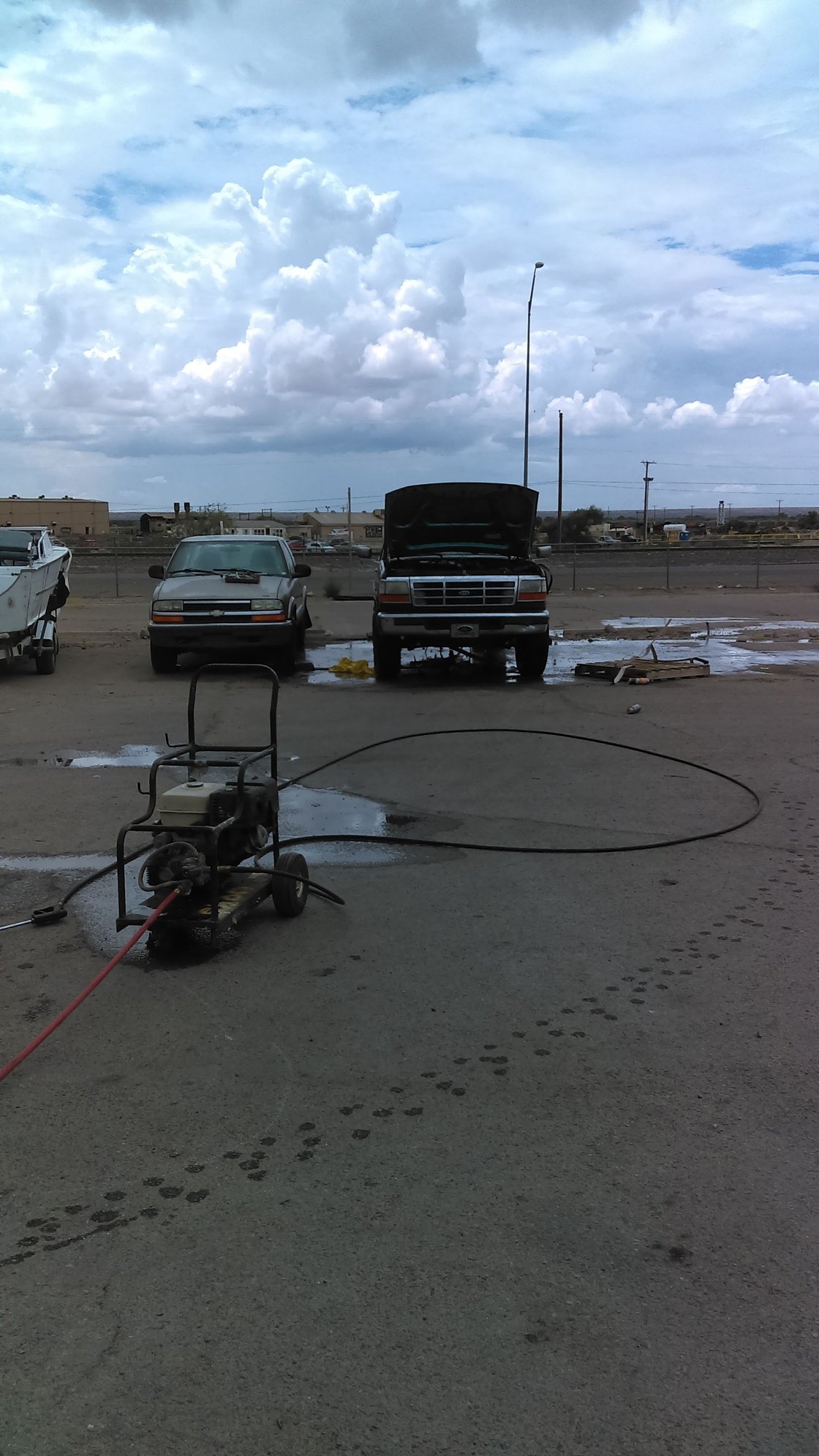

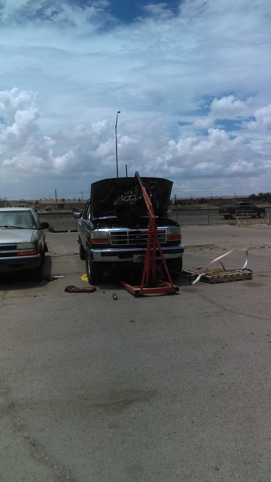

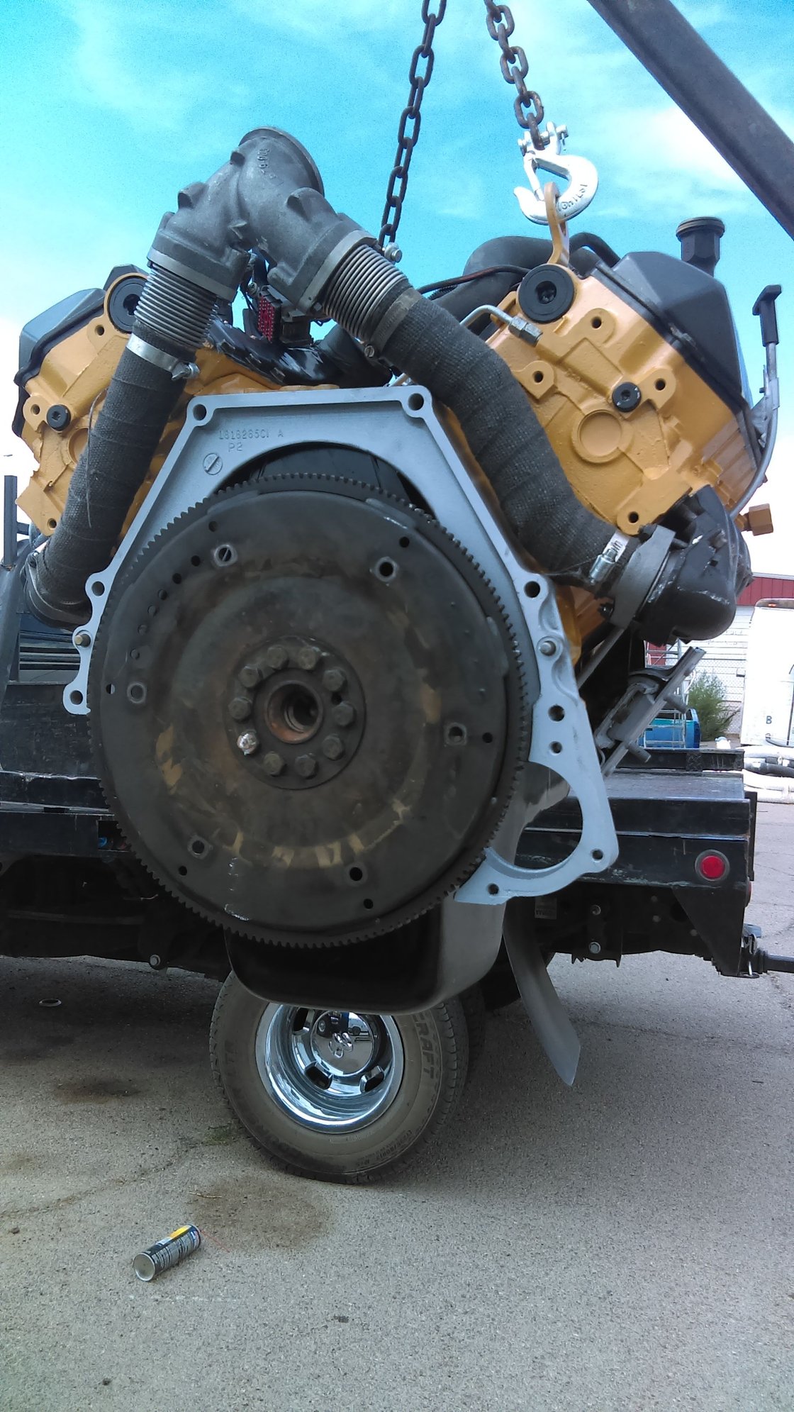

This happened today, finally the beast is out.
It was easier than I thought, took me 10 minutes wrestling it around by myself and finally came out.

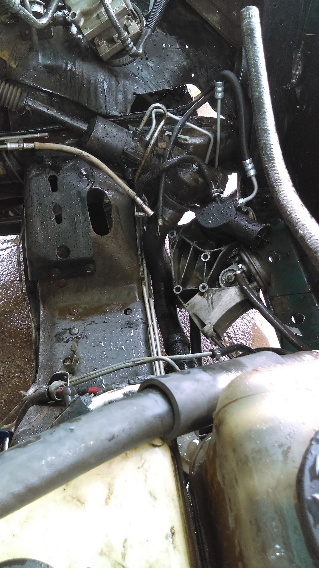

Started washing the engine bay, was not as nasty from last time the engine came out 400K ago.
The triple Disc TC I installed almost 2 years ago.
Hopefully when all is said and done I should have the engine installed by Tuesday, and hopefully running.
More updates to come ...

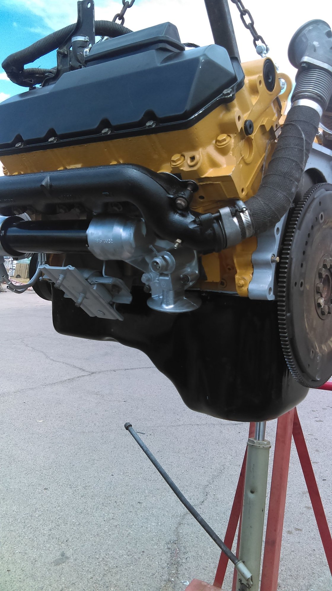

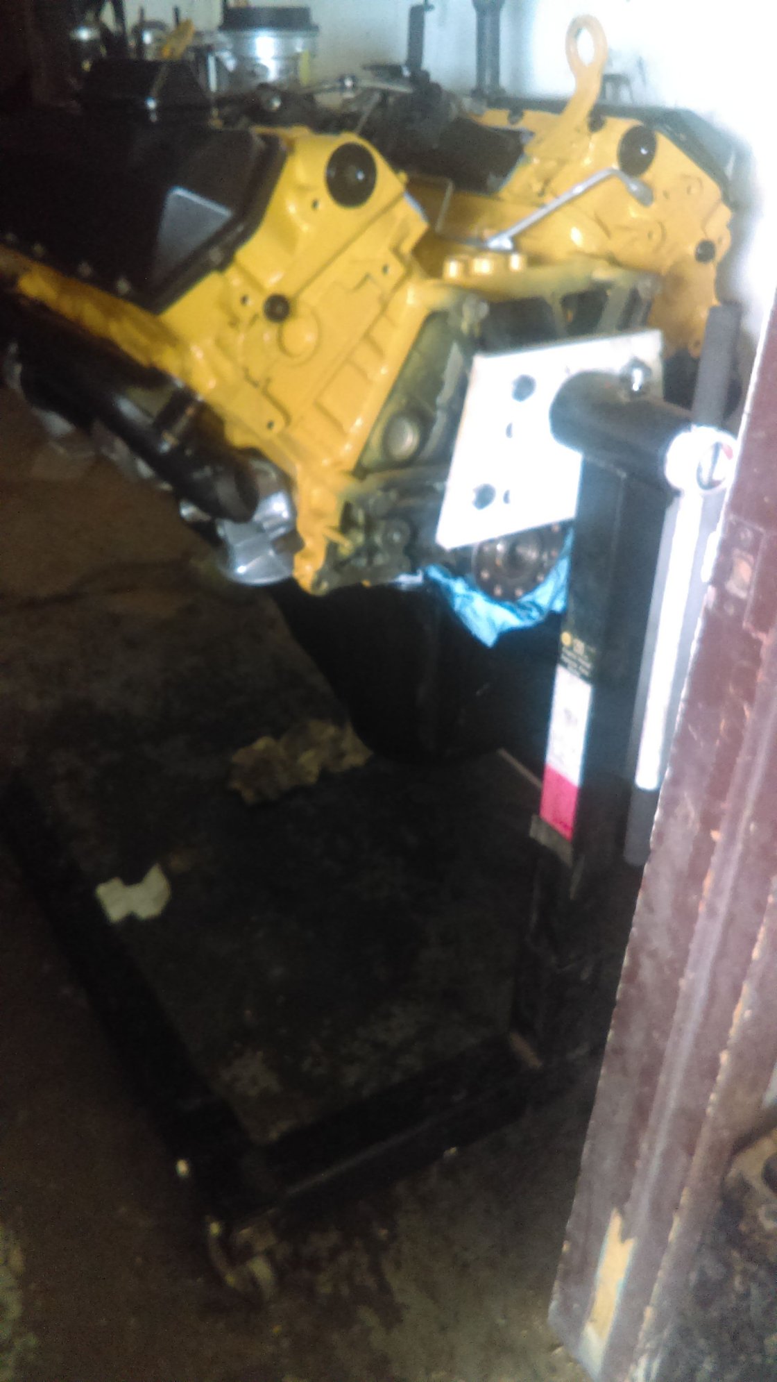

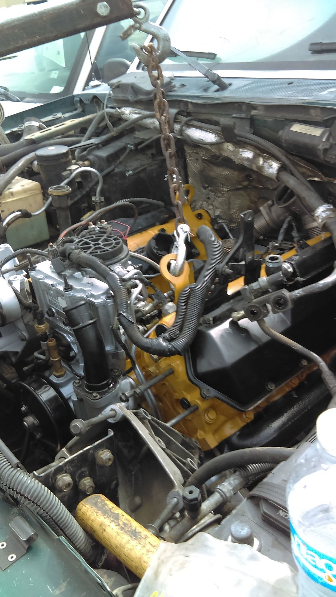

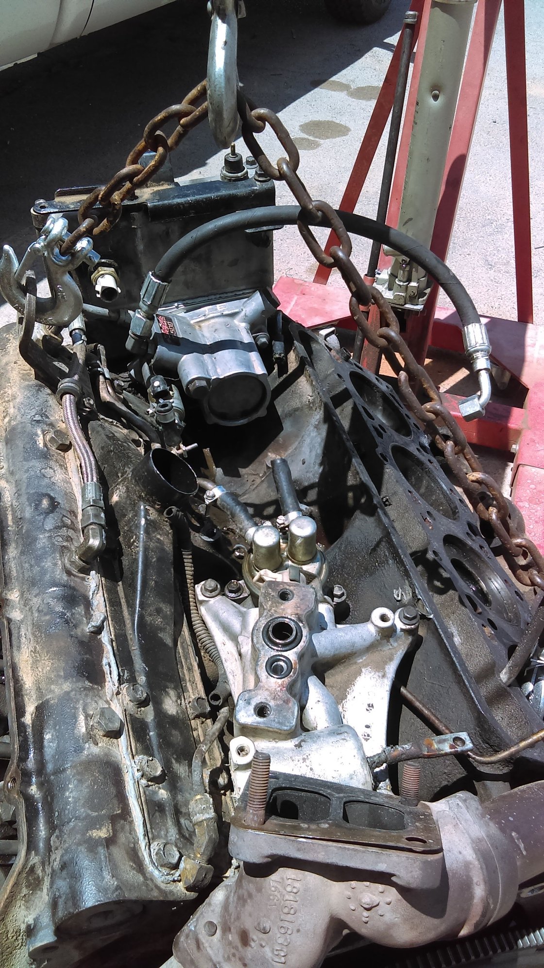

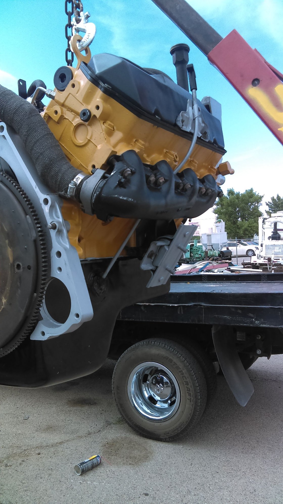

Still working on putting accessories on the engine, I can safely say it can go in the Mule.
Water pump out my old engine, and no visible cracks or cavitation.

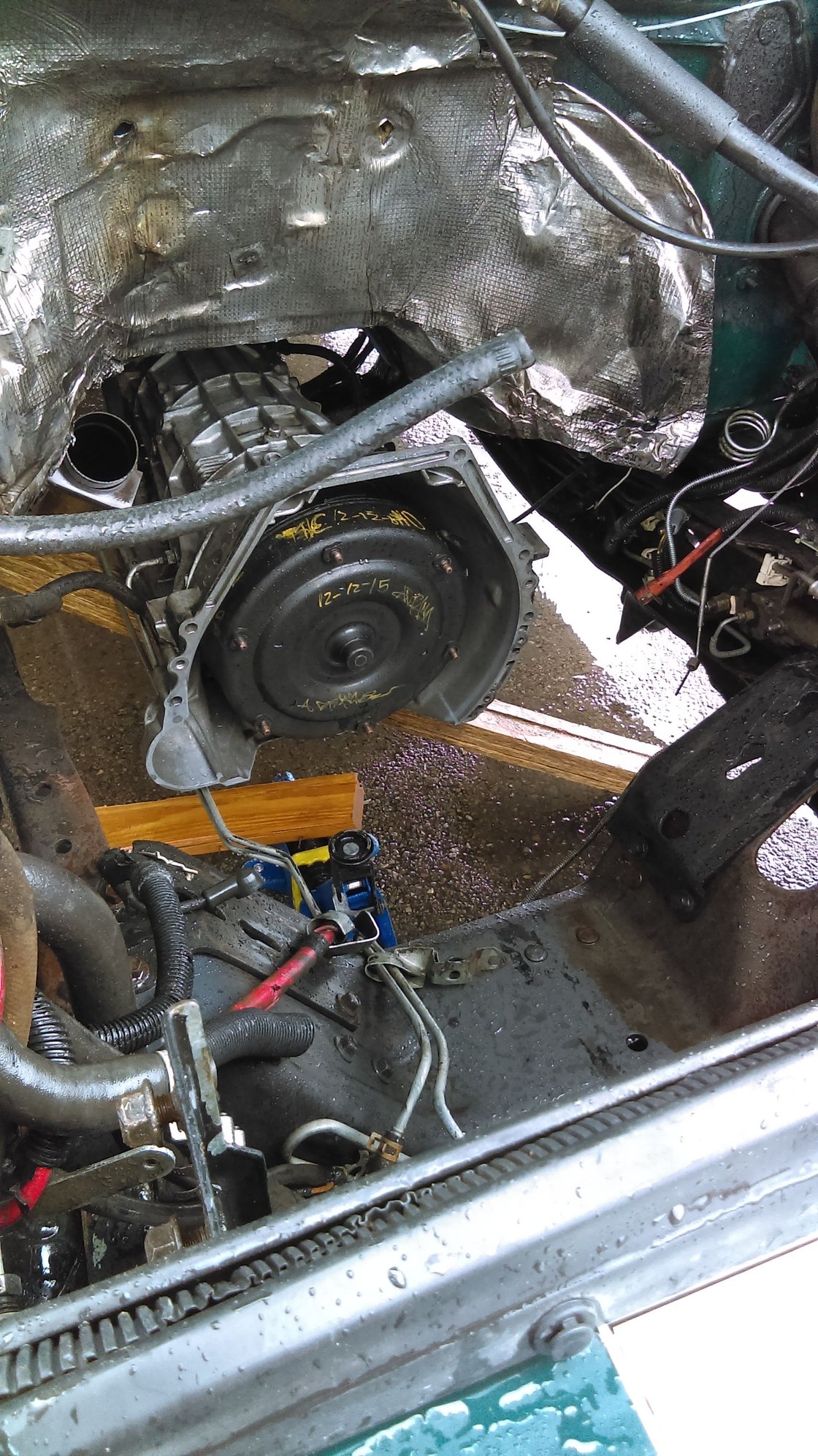

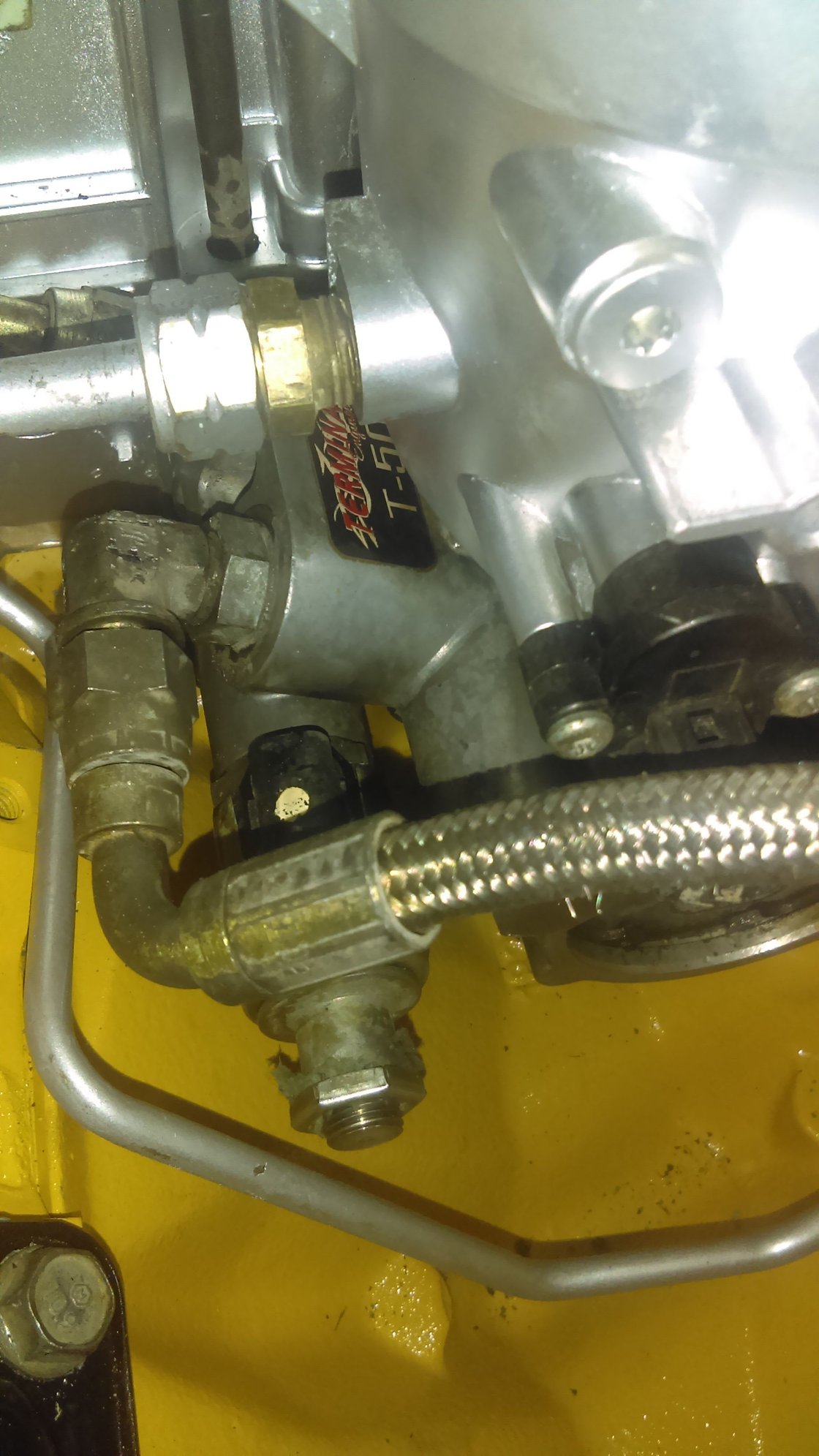

Taking out my T-500
Fuel bowl out and look at the mess

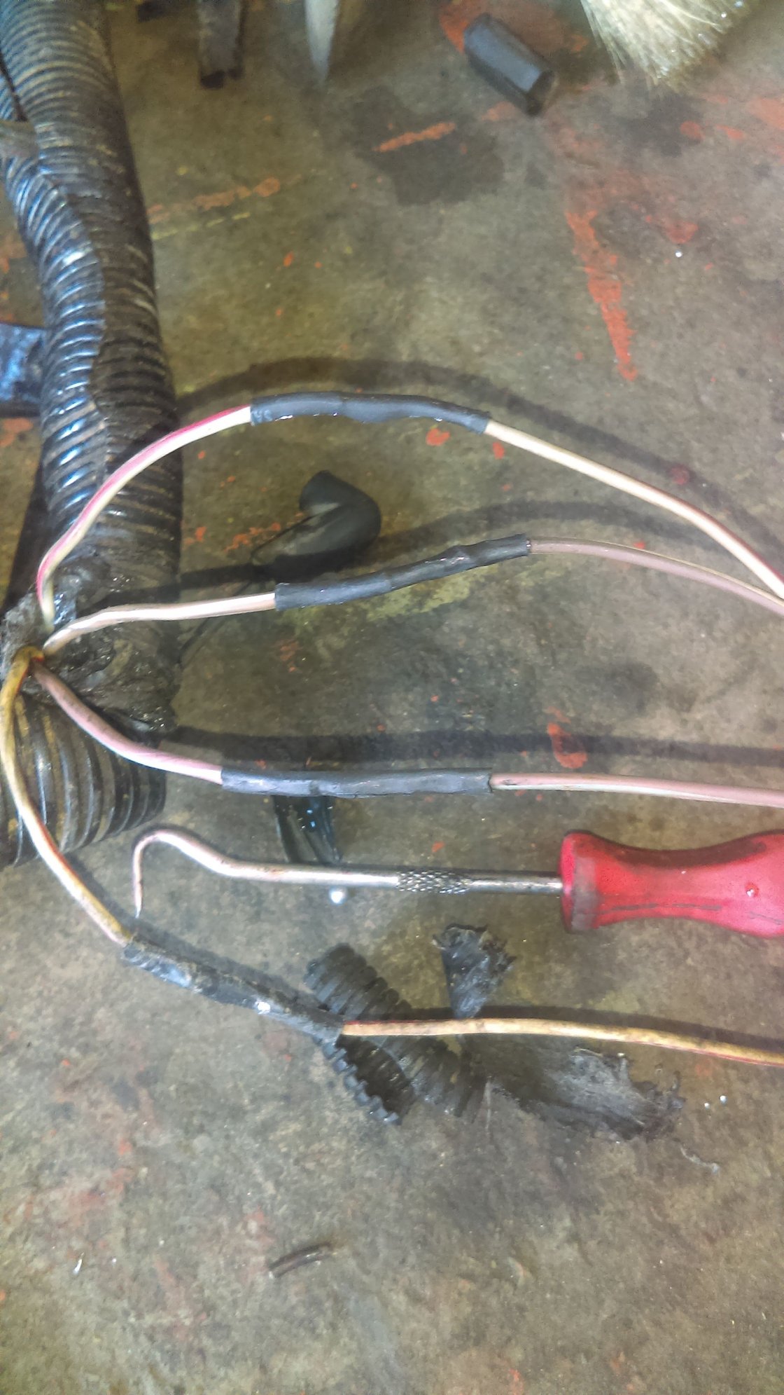

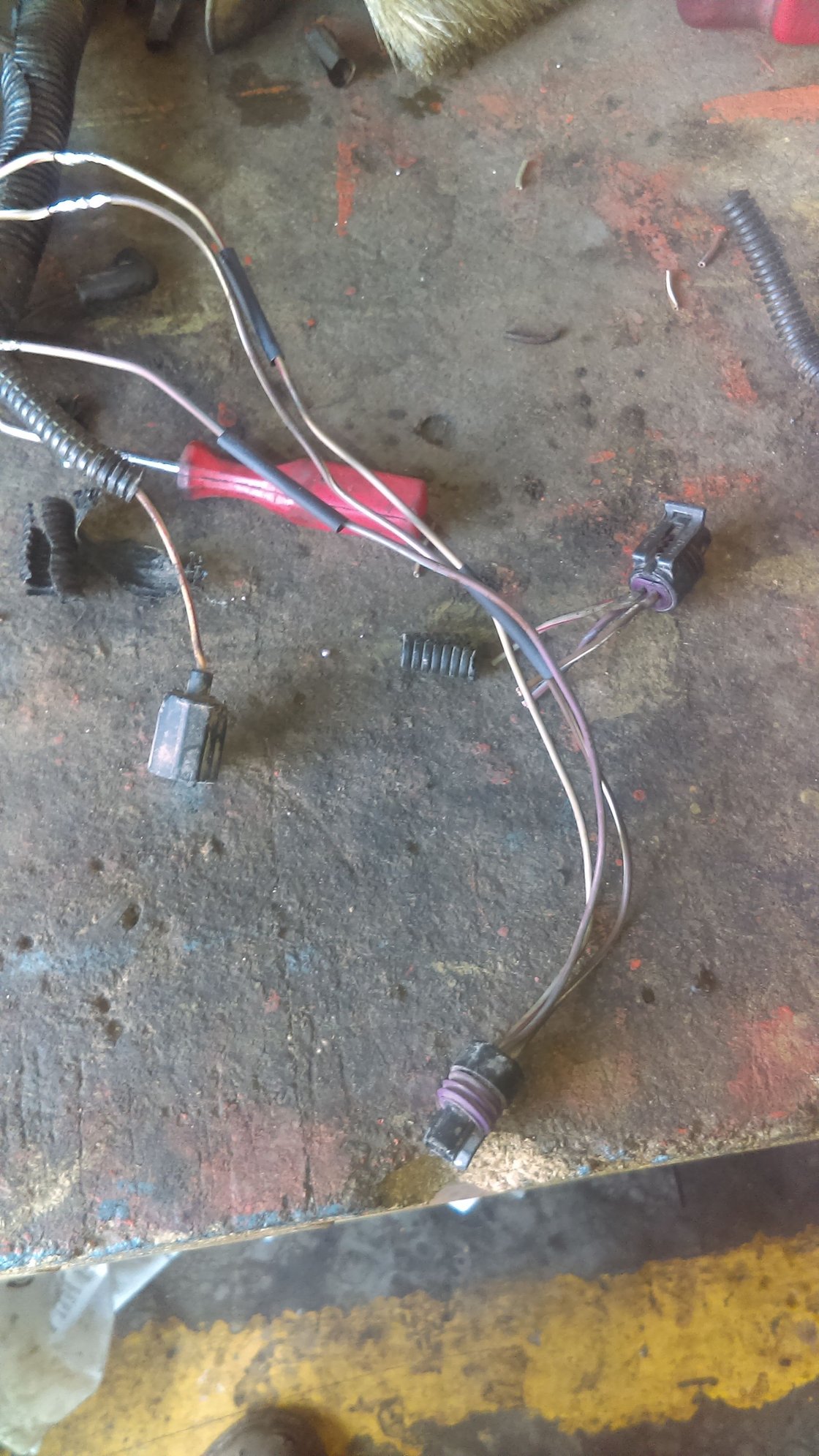

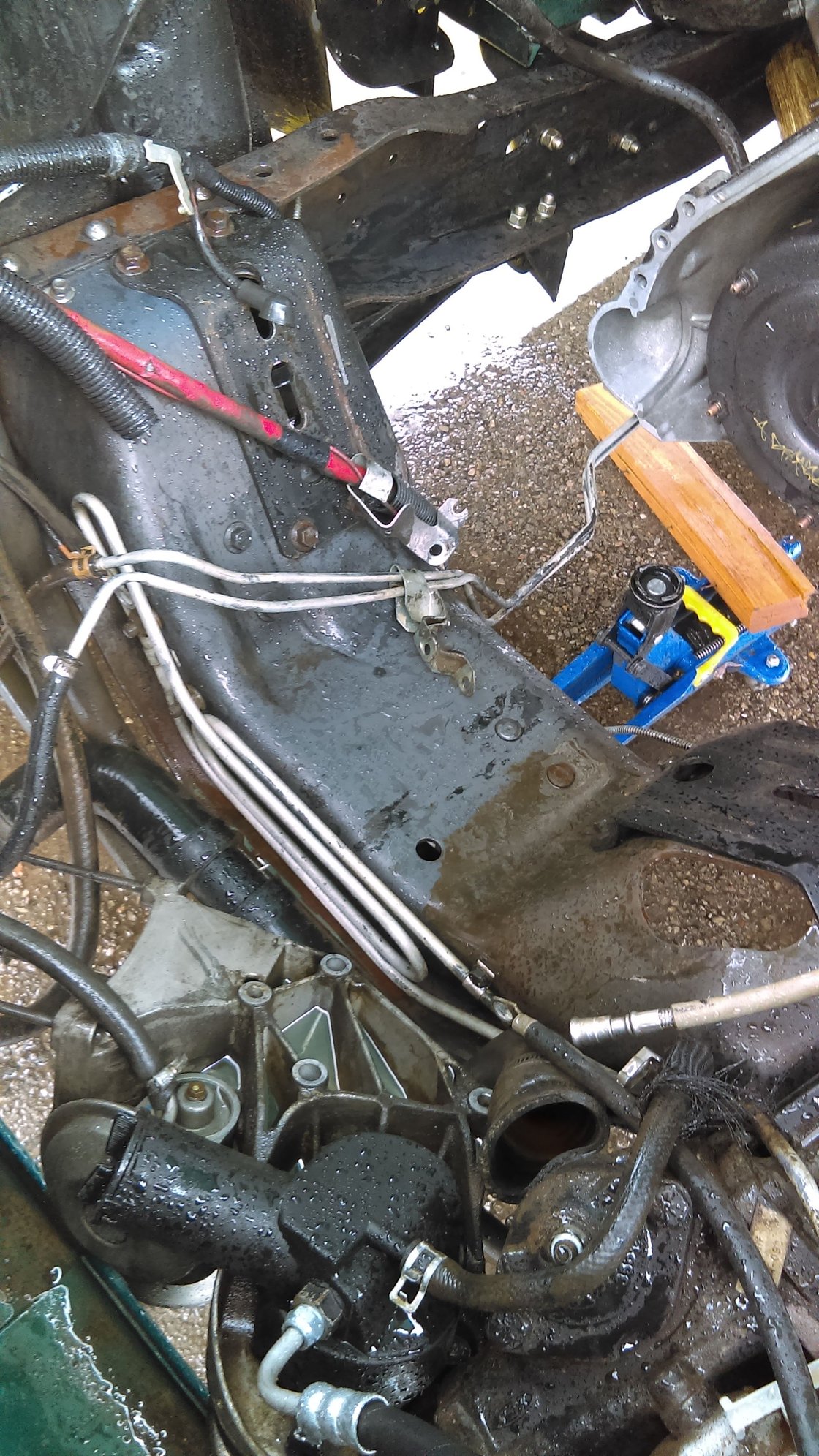

Had to extend the EBPS wires as i used the super duty EBPS bracket and line also had to use the SD oil pressure switch as the obs has a different thread pattern so I jihad to solder the pig tail for that sensor
Soldered and heat shrinked.
T500 in its new home

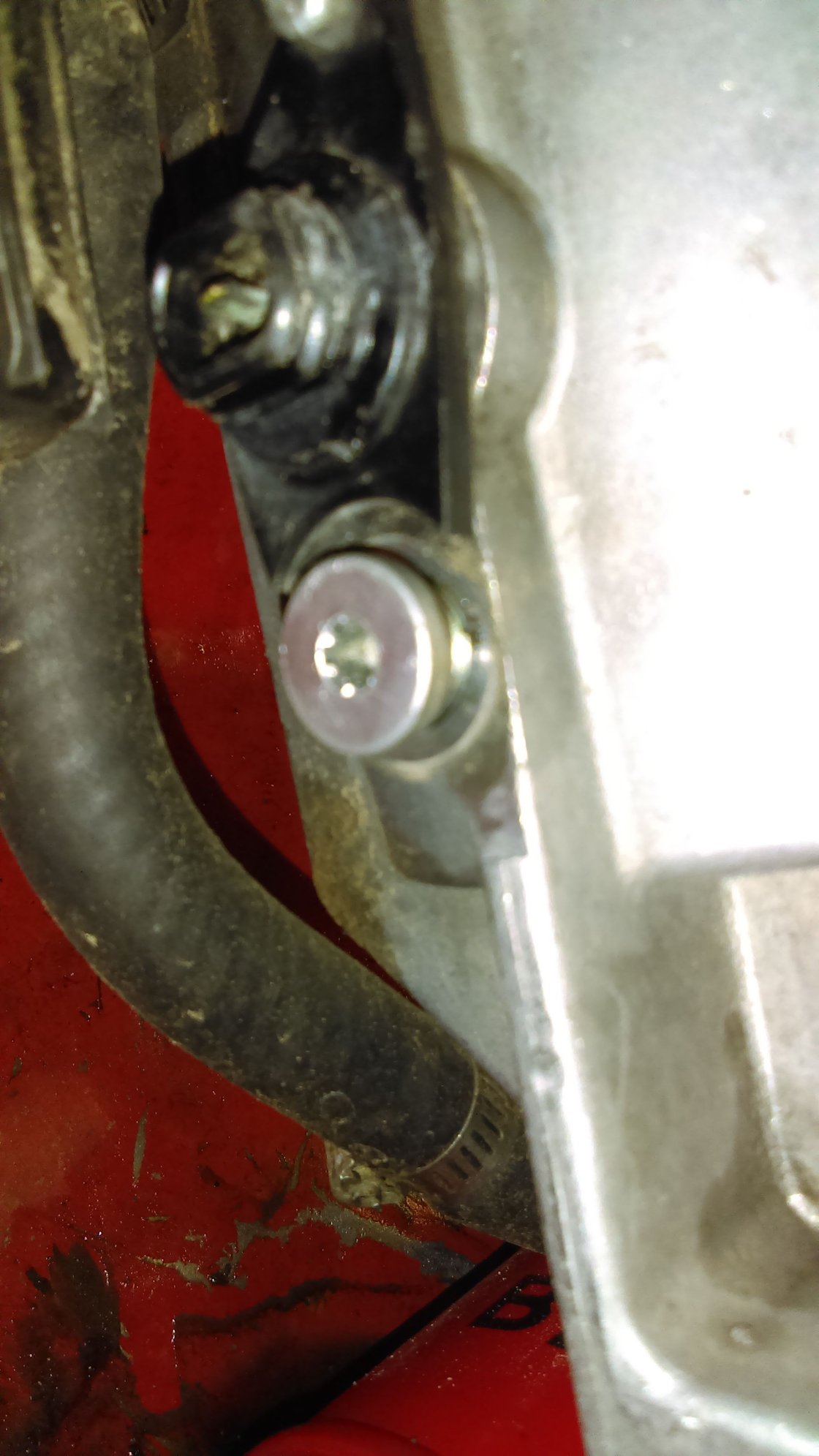

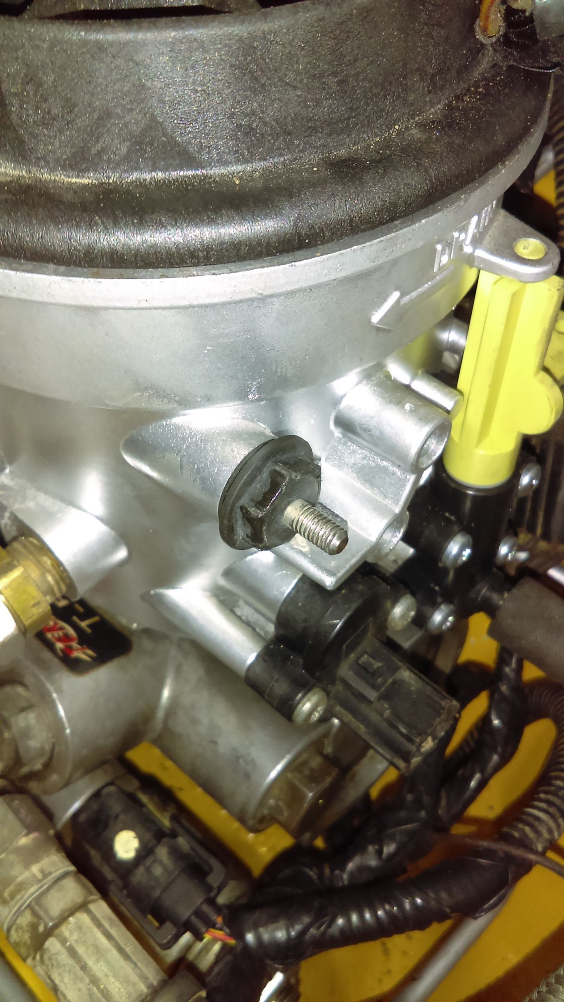

Ran into a small problem with the OBS Water in fuel sensor so I improvise and thanlfully theres two 30 torx screws with the same thread as the WIF sensor this is the plug from the SD on the OBS fuel bowl
And heres the WIF sensor
Harnes installed

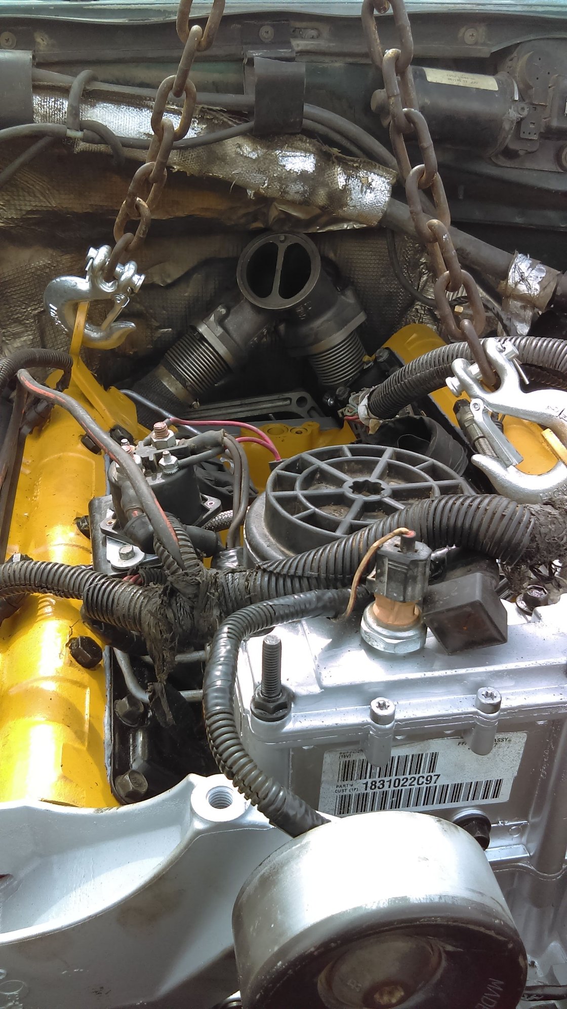

Finally she's in
Heat wrapped headers
Tapped the new manifold fo my EGT probe
Everything is bolted on just need to connect the harness, and grounds. Next is the electronic pump.

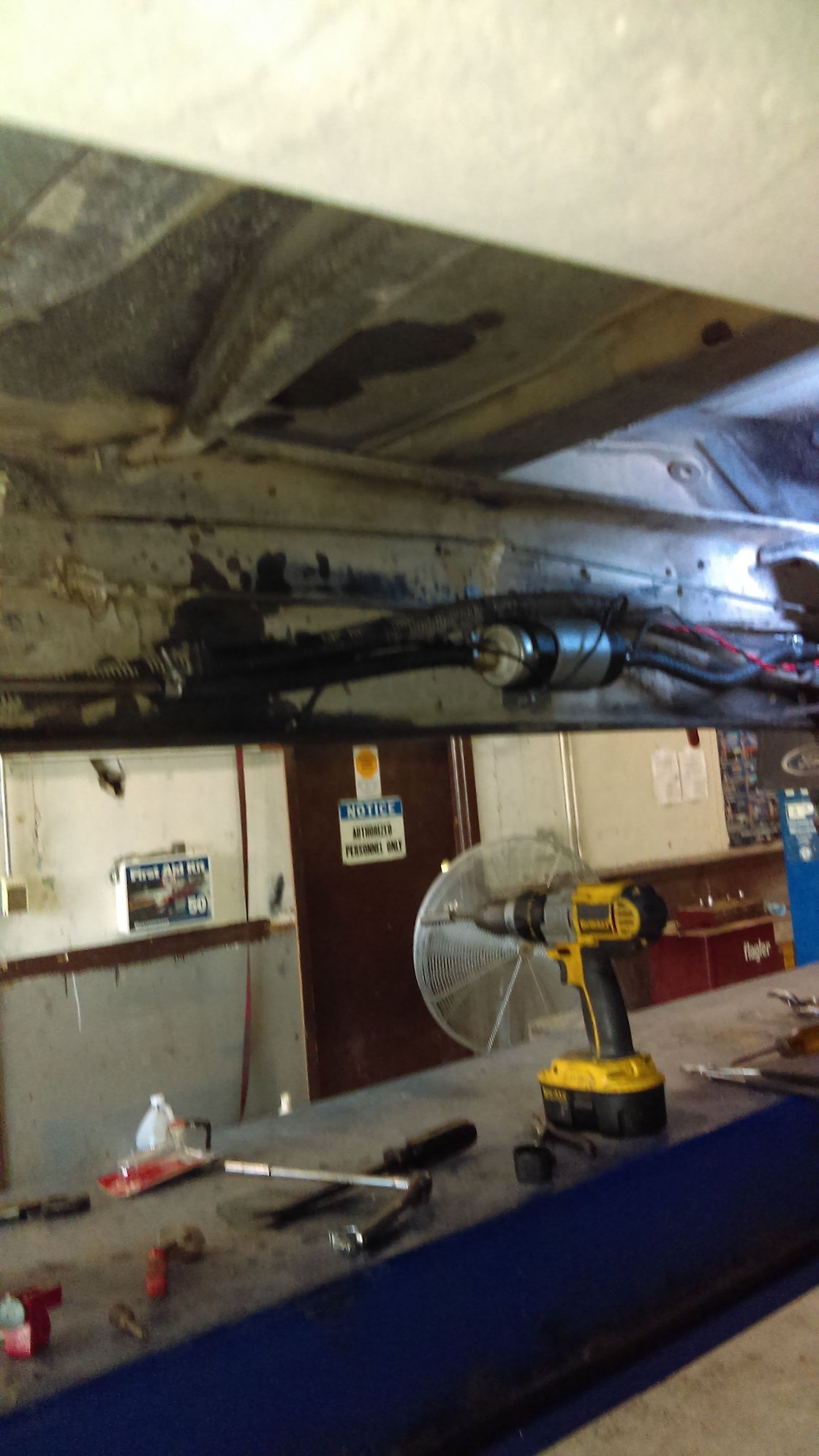

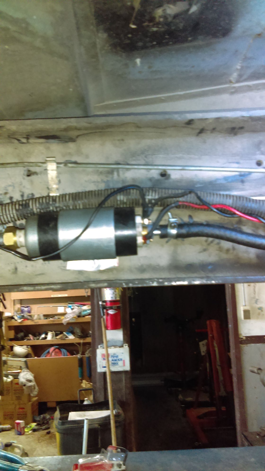

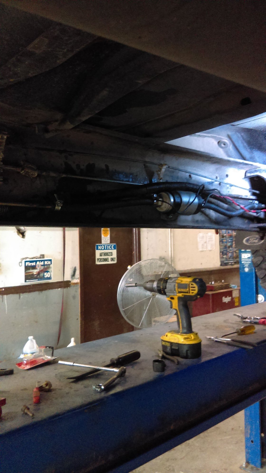

Got the electric pump plugged and working,
The bracket for the fuel was made out of TPO metal sheets courtesy of the shop scrap pile, so the inner part of the metal has a coat of soft TPO membrane while the back side is a 24 gauge sheet metal.
Still need to wrap the wiring going into the cab, I did a manual ON/OFF switch, for testing purposes, still need oil pressure switch and a relay, but we got fuel to the fuel bowl And got her started I'll post some pictures and a small video, once the turbo pedestal arrives so Ivan install the new turbo and start mocking up the down pipe
