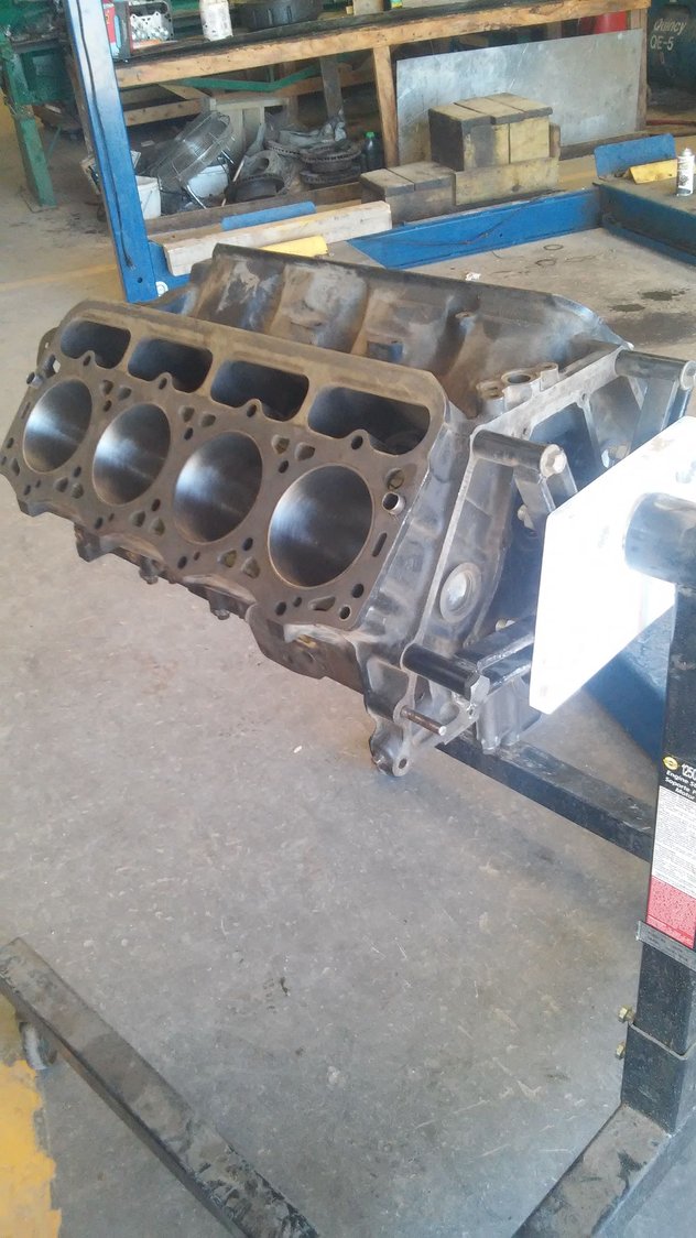

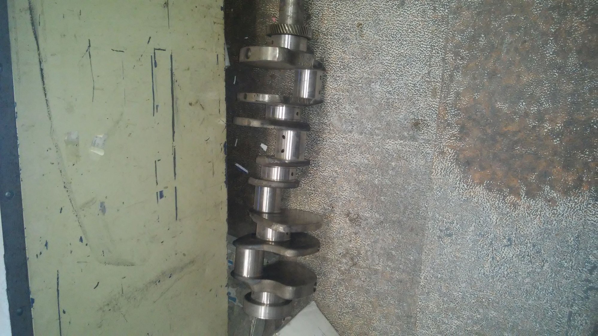

I only wish it still had life in her but shes gone, no coolant in the oil thou, but theres moisture in the oil fill cap wich is weird? I dont want to risk on damaging my stage 1's and T-500 hpop now would I.... all parts needed are here block machined heads done all I need are those stupid Rod bushings to get done.
Parts.
Bare block machined and ready to go.
Oh and polished crank

Looks great Adam. If all you need are the piston pin bushings I'd say your glass is a lot more half full than half empty.

Looks like quite the pile of goodies!
