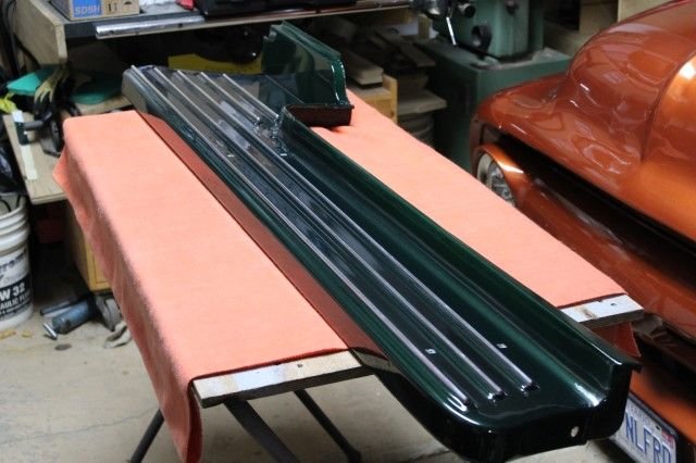

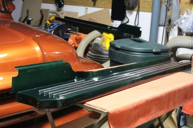

Did a few pieces today then put on the step strips to finish off the running board..

Those look great. I really like those strips on the running boards and would love to do that when I paint my truck one day in the not so foreseeable future!

Running boards look fantastic, John!!

I got those strips from here.. Half Round Accent trim | Smart Parts

Sounds like there is hope for those who want to shoot paint in our shops! I was going to add some stainless strips to my running boards but I was going to use a flat piece about 5/8" wide and 1/8" thick. I like the half round you used too. Did you use double stick tape to mount them?

No, they come with 1/8 set screws and nuts to attach them. The set screws are spaced 8 inches apart.

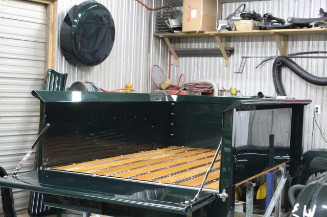

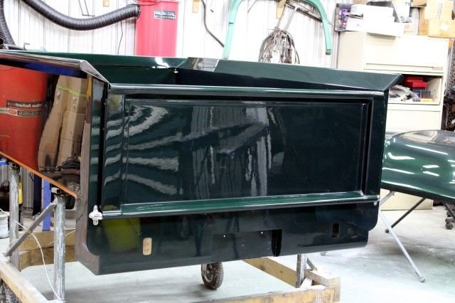

Assembled the bed the other day and got around to taking some pictures today..

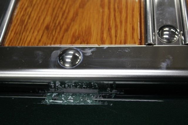

From: northwestern Ontario

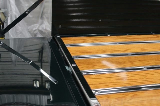

Unfortunately that stainless strip at the end of the boards had a slight bulge in it and when I opened the gate it scraped some paint off to the primer so off came the gate to see why it happened, I discovered that one board wasn't completely set forward. It's now fixed as far as clearance goes but looks like a paint repair is in order in the future.

Beautiful job John. I've been waiting to see it all put together. What is hanging on the wall that seems to match the truck ?
Do you mean in this picture..? It's a tire cover from a Toyota SUV, I was thinking of using it mounted flat in the bed but still need to make a mount for it that won't do any harm to the bed boards or skid strips..

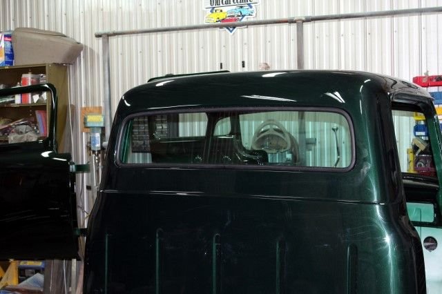

Well the glass professional did make in town as the roads were clear, 3 attempts and I wasn't happy with the way the trim was fitting, we couldn't get the trim to seat properly in the rubber molding, he was going to stop in again on one of his next visits to town. I didn't get much sleep thinking about it and decided to remove the glass again to save time, time equals money..
Well it's back in and fits much better, the secret we found was to take your time and finesse the trim in place. My wife and I spent about an hour getting the rubber and trim in place to where it fit much better and only took about 20 minutes to rope it in place. We should have done it ourselves the first time and not hired a professional.

The back window only took about 10 minutes, the wife looked at me when we put it in and said to me later .." we could have done that "...and we should have..lol
