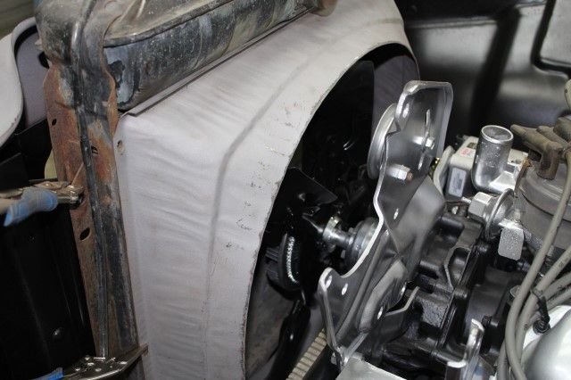

The original fan shroud I had trimmed back to work with the original radiator no longer worked with the new radiator so modifications needed to be made.
Old Apr 4, 2016 | 08:14 PM
  #152
56panelford's Avatar
56panelford
Posts: 283,710
Likes: 8,282
From: northwestern Ontario
I sliced it in half and shortened the bottom half by cutting out an inch in height from the bottom and in one and a half inches to clear the trans cooler lines.
Old Apr 4, 2016 | 08:16 PM
  #153
56panelford
Posts: 283,710
Likes: 8,282
Welded in a piece at the bottom to close things up and ears to the 2 halves to bolt them together.
Old Apr 4, 2016 | 08:17 PM
  #154
56panelford
Posts: 283,710
Likes: 8,282
Used these threaded inserts to attach the shroud to the rad
Old Apr 4, 2016 | 08:19 PM
  #155
56panelford
Posts: 283,710
Likes: 8,282
All that's left to do now is repaint it. I have plenty of clearance all round..

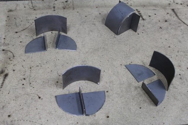

Thought I'd save myself a bit of money by making my own stake pocket extensions today, so cut all the pieces out of some scrap 16 gauge material I had.

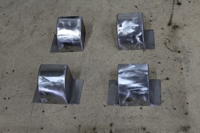

Proceeded to weld them up

clean up the welds..

Test fit and will weld them on when I remove the box off the frame..
