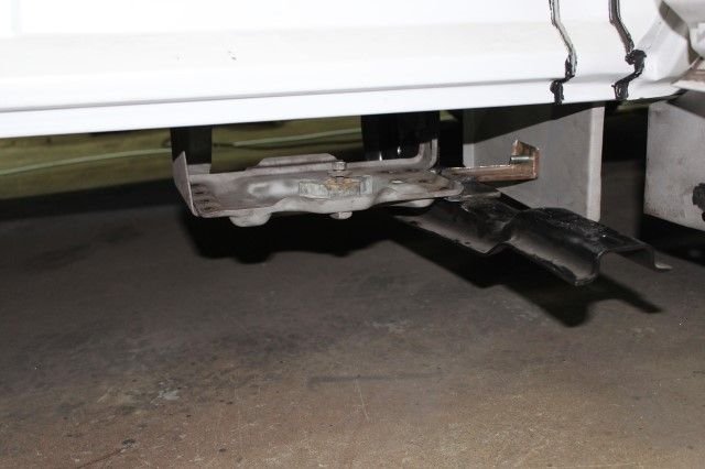

A view looking down through the floor opening, I also had to make a stone shield to protect the battery which you can see on the right.

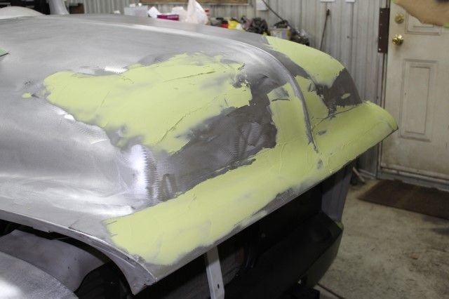

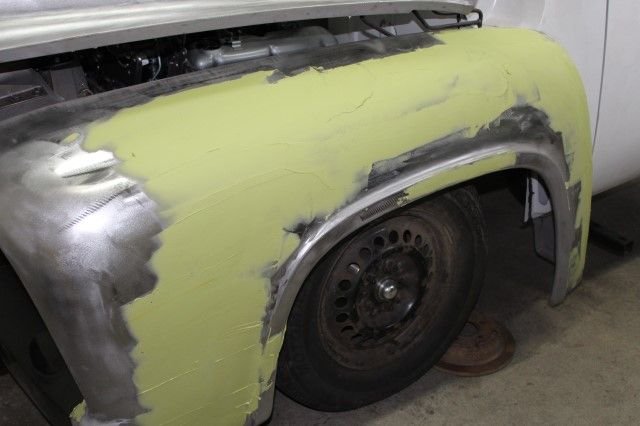

From: northwestern Ontario

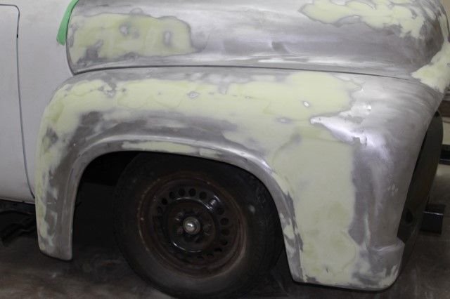

I spread filler over the worked over areas the other day and now have it all blocked out and will post later again today. I'm quite happy with the way it turned out. Need to get the shop prepared so I can get the epoxy primer and High build on them.

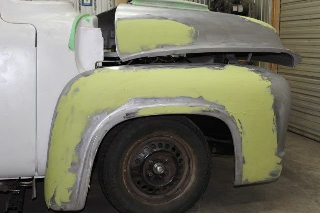

All sanded and ready for next step of primer but need to prepare shop before spraying. It's a little harder now the the weather has turned to winter mode.

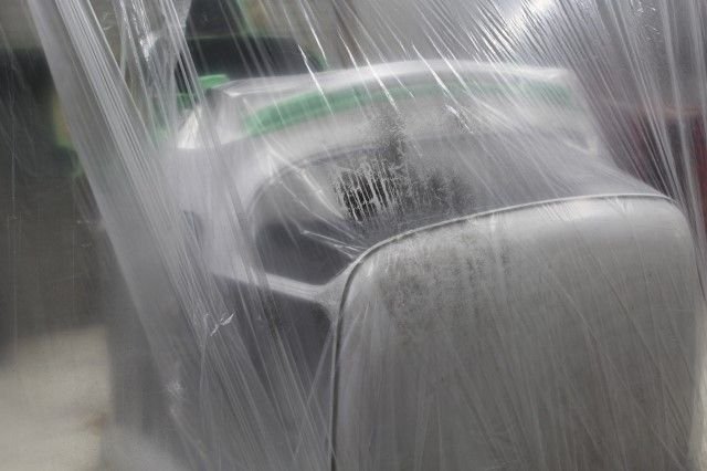

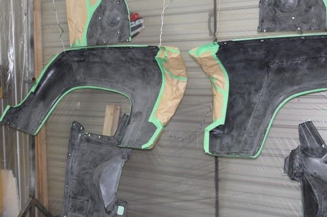

Not really a lot to report Pat, I do have epoxy primer on the hood and fenders. The fenders are all prepped and ready for some bed liner to be sprayed to the underside which will likely take place this weekend.

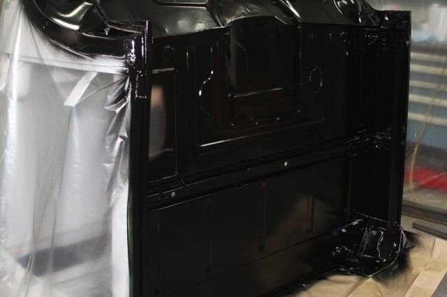

The underside of the cab was prepped and masked off so I could apply some epoxy to it.
Old Dec 10, 2015 | 09:28 AM
  #128
56panelford's Avatar
56panelford
Posts: 284,099
Likes: 8,427
I applied the epoxy yesterday and will likely let it sit for a day before scuffing it up and will apply the bed liner to it and the fenders Saturday or Sunday. After that is all done I will be applying the high build primer. I'm making a shopping list of parts I'll be ordering in the new year. Things are going kind of slow right now, might just be the winter blues...lol

Do you use bed liner on the outside inner fenders
Old Dec 10, 2015 | 09:34 AM
  #130
56panelford
Posts: 284,099
Likes: 8,427
Everything a stone can hit.

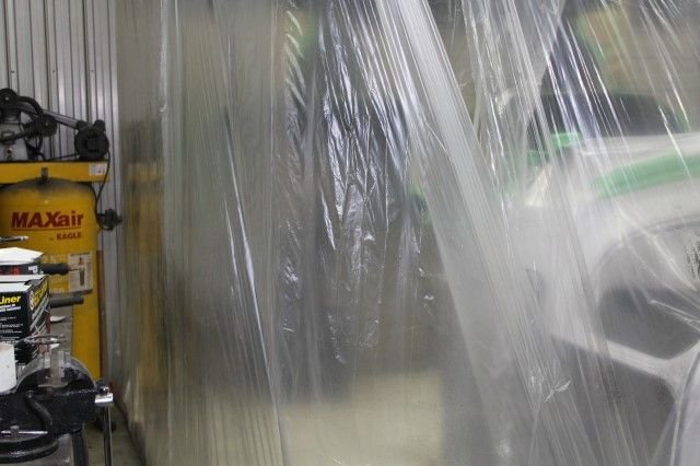

Here's a view of my cluttered shop while trying to continue along with the project.
Old Dec 13, 2015 | 01:36 PM
  #134
56panelford
Posts: 284,099
Likes: 8,427
The other half of the shop was partitioned with a tent of plastic sheeting.
